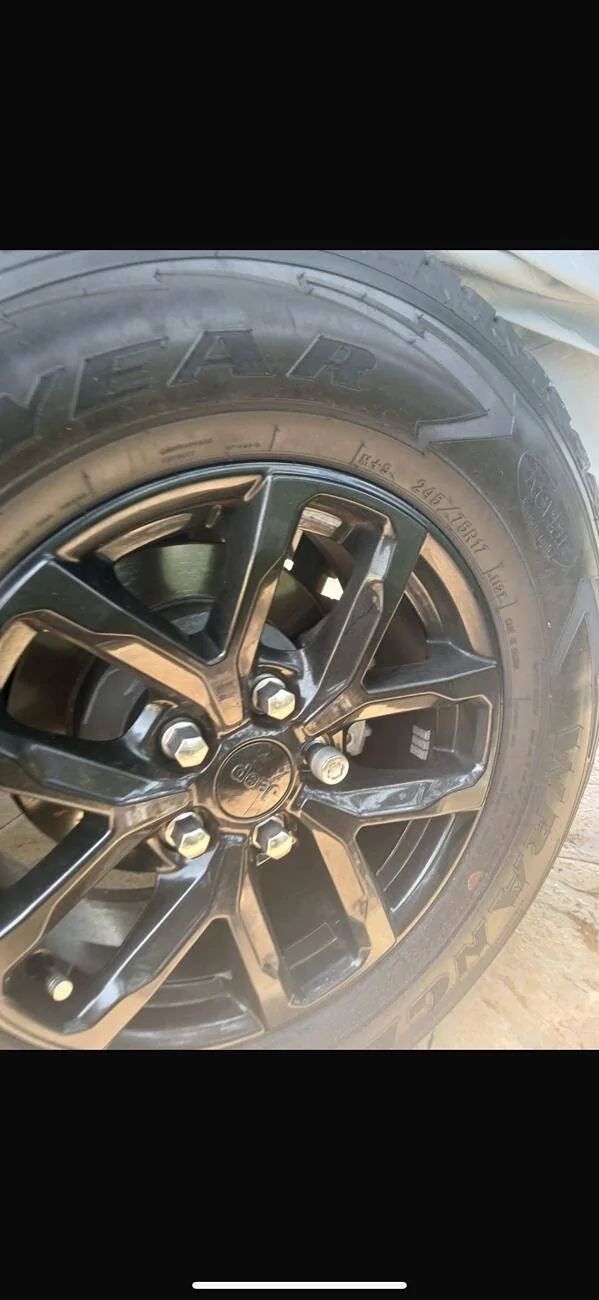

I want to keep my stock rims I have a 2023 JL would like to get 35’ or 37’ is that possible with my stock rims?

Absolutely yes on 35s, unclear on whether there are any 37s thin enough for a 7.5 rim (which is what you have there, unless I’m mistaken)

Lot of people say that’s a poor man’s beadlock , putting 37s on stock rims. Many people are riding that. Do a search on the forum. Not sure which JL you got and which tire you are looking at, if it’s true 37, it’s gonna rub if you leave pavement

I'm running stock 17" wheels with 35s on my 2022 Willy's. Looks great, rides fine. I rarely go off road though.

35s yes, 37s pushing it.

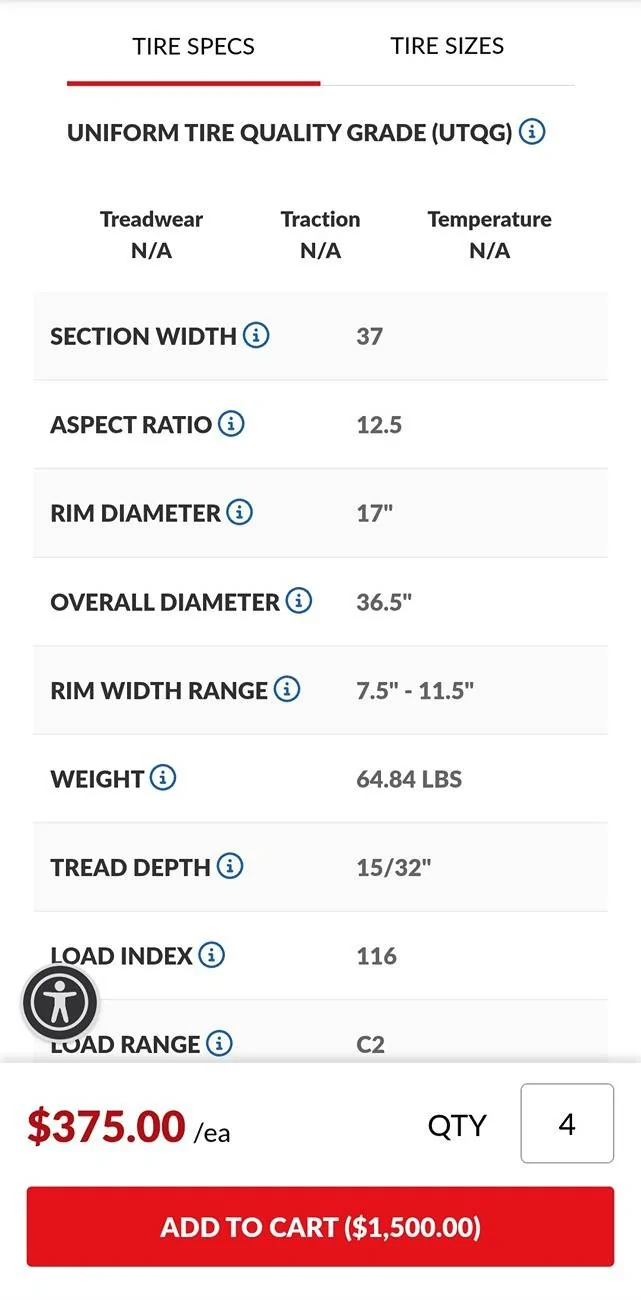

nitto makes a 37x11.5-17 that fits a 7.5" wide wheel and Mickey Thompson makes a 255/85-17 which is a 35x10-17 that fits the oem wheels perfectly...
