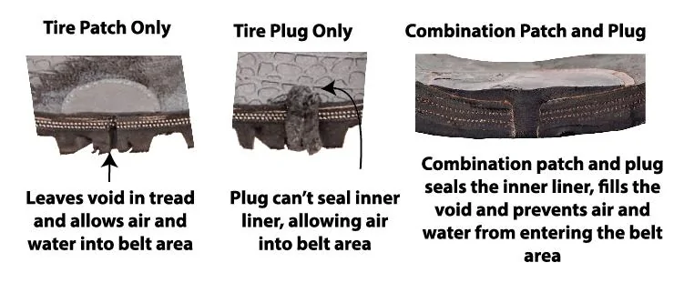

Definitely fixable. Go to an auto shop and ask them to repair it with a plug/patch combo.
Thanks, does the plug/patch combo mean it has to take the tire off the rim and patch it inside? because some shop suggest just a quick fix with plug from out side without take the tire off the rim.

Yes you have to take it off to fix with a patch, should still be fairly cheap and quick. Patches are much better than going with plugs alone.
Yes, the tire has to be removed from the rim to repair with a plug/patch. But the plug/patch combo repair is better than just plugging from the outside. You get the benefit of both a plug and a patch. (I do carry a simple plug kit with me for emergency quick fixes.)

Sure, if I was in a real bind.. out in the middle of nowhere.... as a temporary fix, I would use...
Otherwise I would be using the plug/patch like @Boatbuilder88 , mentioned in the last post in this thread.
Sure for around the farm, crawling, low speed driving, etc., I would possibly use a plain plug or a hybrid "plug", but for a tire I will be driving at high speeds on the interstate, no frigging way would I use a "plug".
Tire shops in some States will only use the plug/patch repair.. the days of a simple cord plug / plug of any design are pretty much history in regards to having a decent tire shop placing/using them.

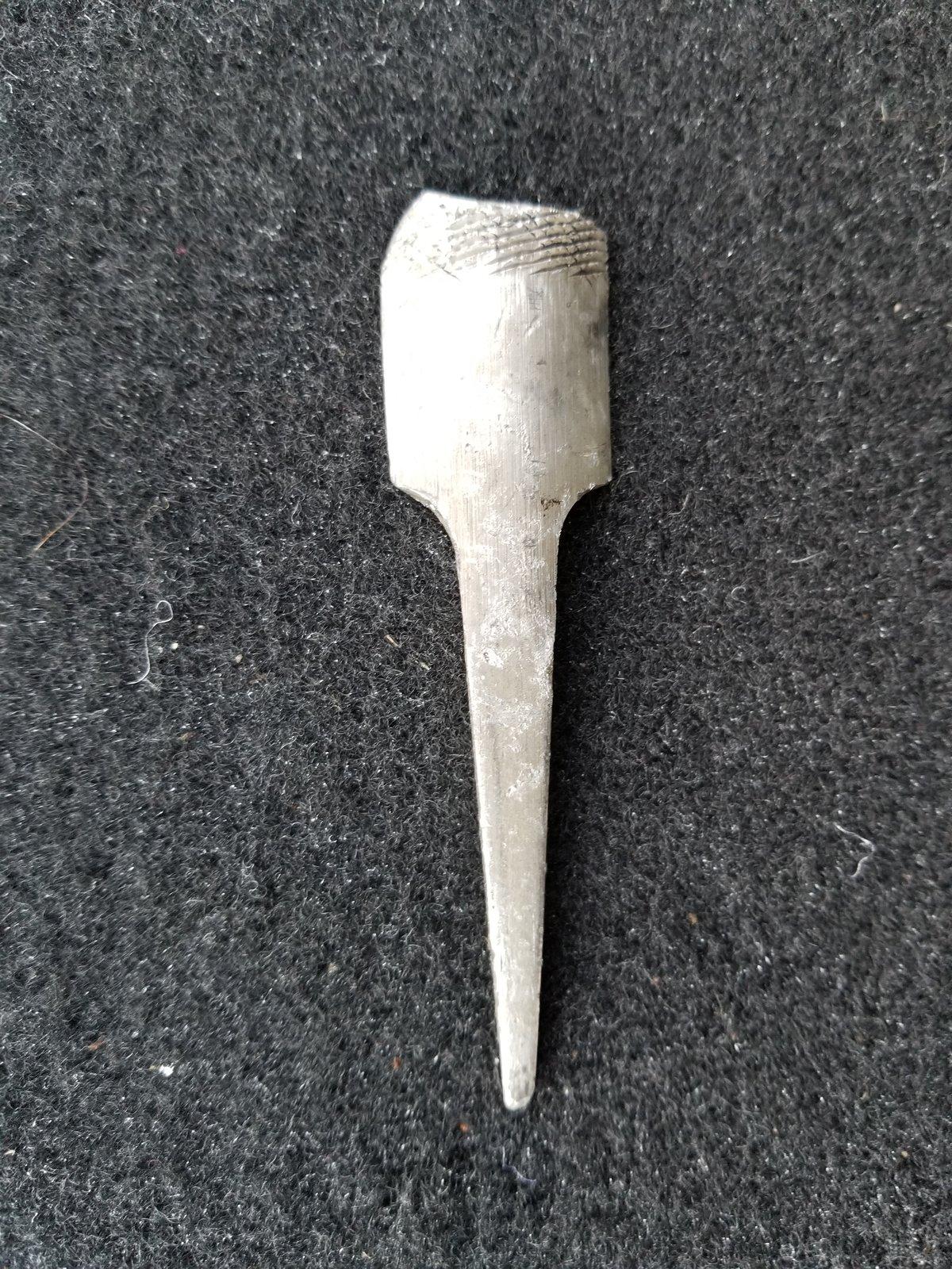

This broken file went through the tire. I didn't get a picture of the tire, but only the broken part was visible in the tire. Not fixable.
