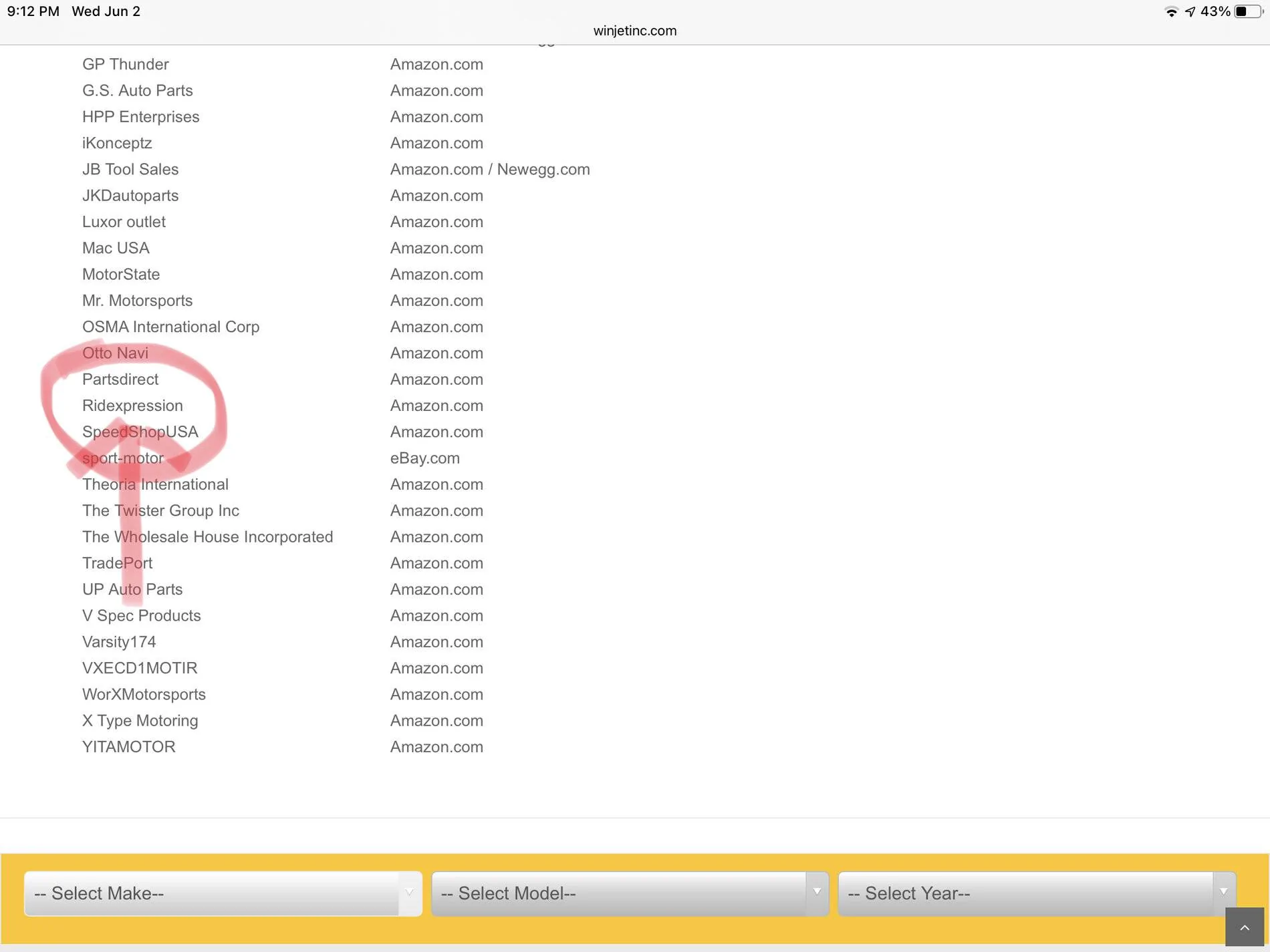

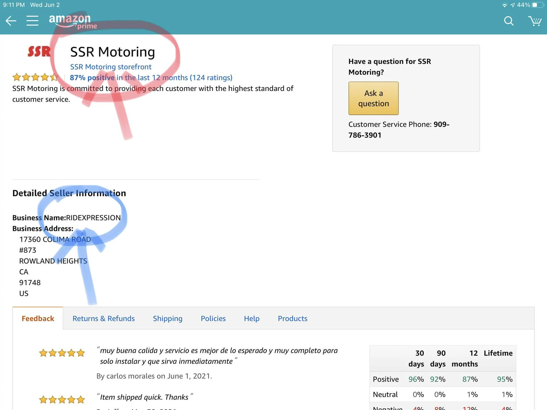

The seller on Amazon ( SSR Motoring ) is on the Bad boy list on Winjets web site and they don’t define what specific reason other than possible violating MAP policy or possibly selling products not up to spec but the ones I received appeared brand new and sealed

I honestly was not paying much attention on Amazon when ordering but as you can see SSR Motoring is actually Ridexpression
Jeep Wrangler JL My Sequential LED Taillights 5ABB4A1F-1041-4F80-8D96-C7659FD03EB8
And going to Winjets website Ridexpression is on the bad boy list but they don’t say why but give you a few reasons possible plus they list other sellers as well, apparently The Albert Store is Winjet so maybe that’s where I screwed the pooch but lots reported having issues in the reviews but then those could have come from the other sellers like mine and the reviews don’t point to what sellers they purchased from.
