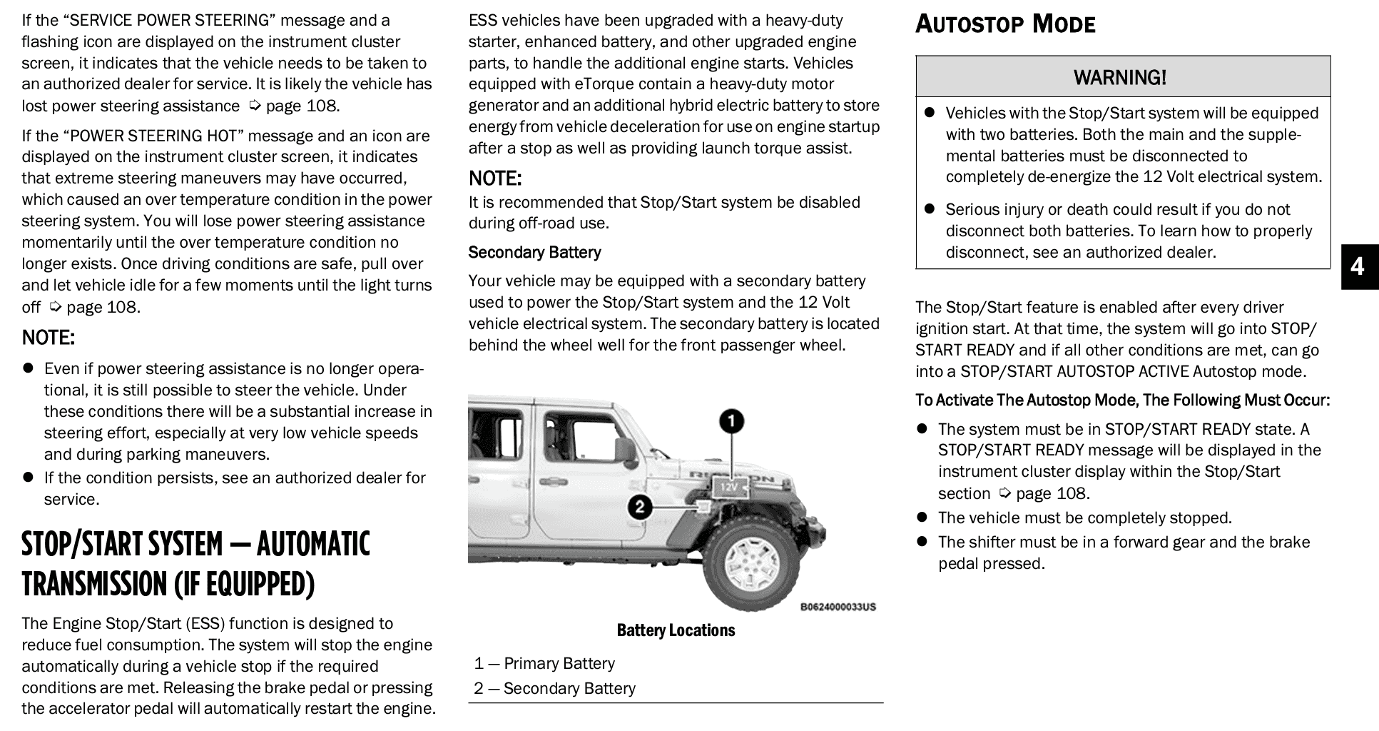

Are you sure you didn’t forget to push the stop start off button. It has to be pushed every time you start the engine for it to cancel the stop start function. Read your owners manual on the stop start system.

The stop start shuts the engine off when you come to a stop and it meets all the criteria listed in your owners manual. It is supposed to save gas. If you wait a little bit, it will restart on its own. That is why the light comes on when you put it in park and restart the engine. Please just read about the the stop start function in your owners manual.

when I got off the freeway and stopped on a red light the engine would turn off
Are you 100% sure you just weren't experiencing the normal ESS (Engine Stop/Start) function?

Mine restarts when you put in park, which seems dumb if you ask me. If I pull in say the wallymart and into a spot the engine shuts off so you put it in park to get out but it restarts. Kinda stupid
Do the ess (little battery) jeeps act different from the etorque equipped jeeps? Mine is etorque equipped, so it restarts with the generator/serpentine belt not the actual starter.
