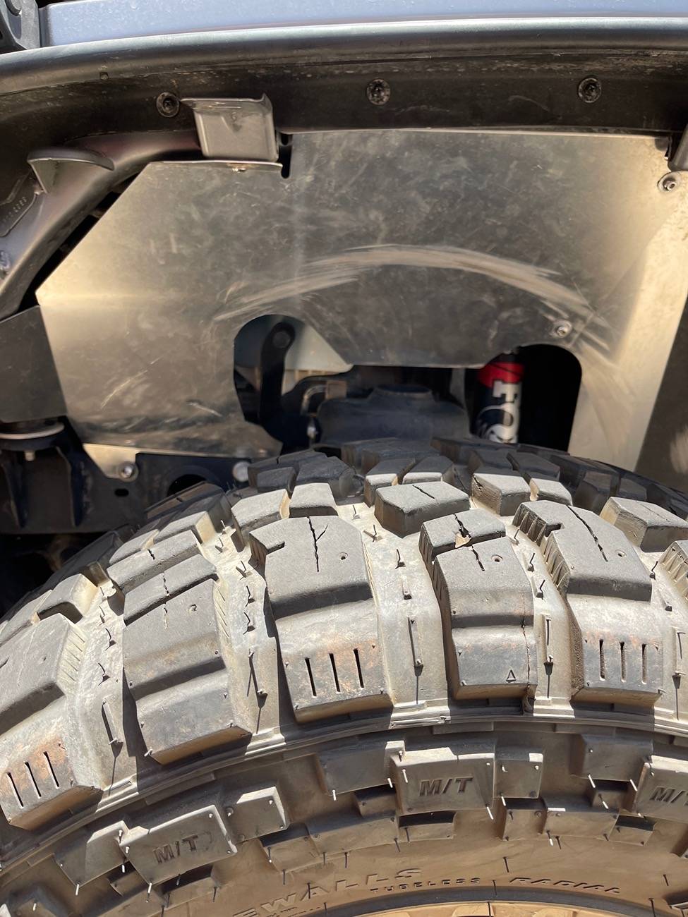

First, trimmed the inner fenders to use the JKS sway bar disconnect brackets.
Jeep Wrangler JL My JL build. IMG_4065

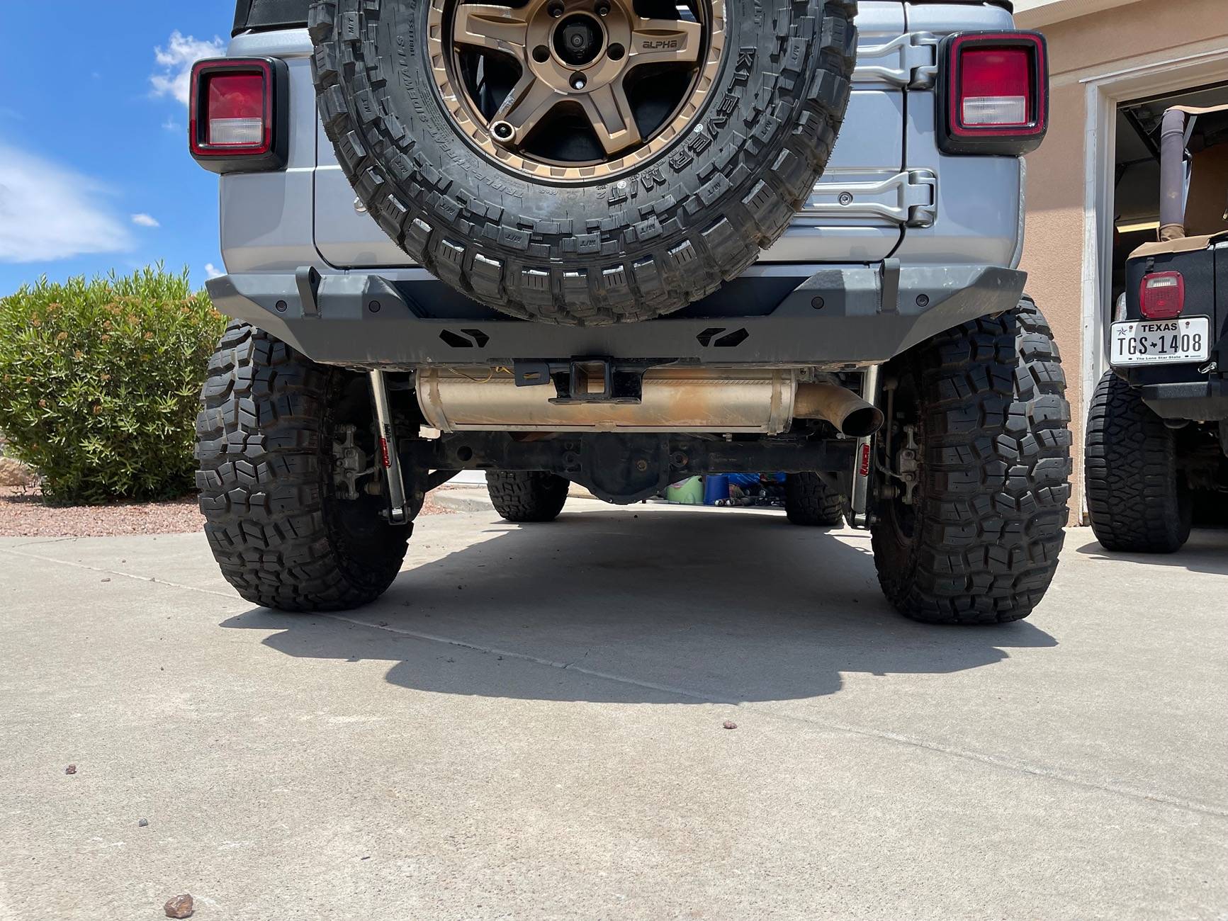

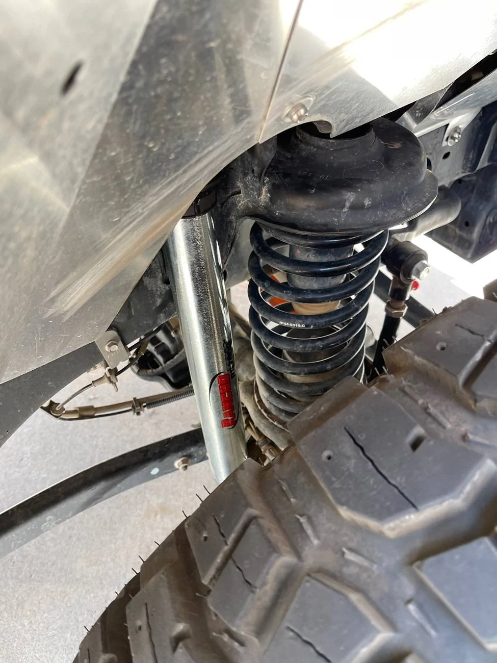

Next, I took advantage of Rock Auto’s close out deal on the Rancho RS7000MTs. I ordered the 3.5 front shocks ($38 a pop), and the 2” rears ($18 a pop). These ended up being the same length as JT Rubicon Fox shocks with 2” extensions I’ve been running for a few years.
Jeep Wrangler JL My JL build. IMG_4089
Jeep Wrangler JL My JL build. IMG_4090

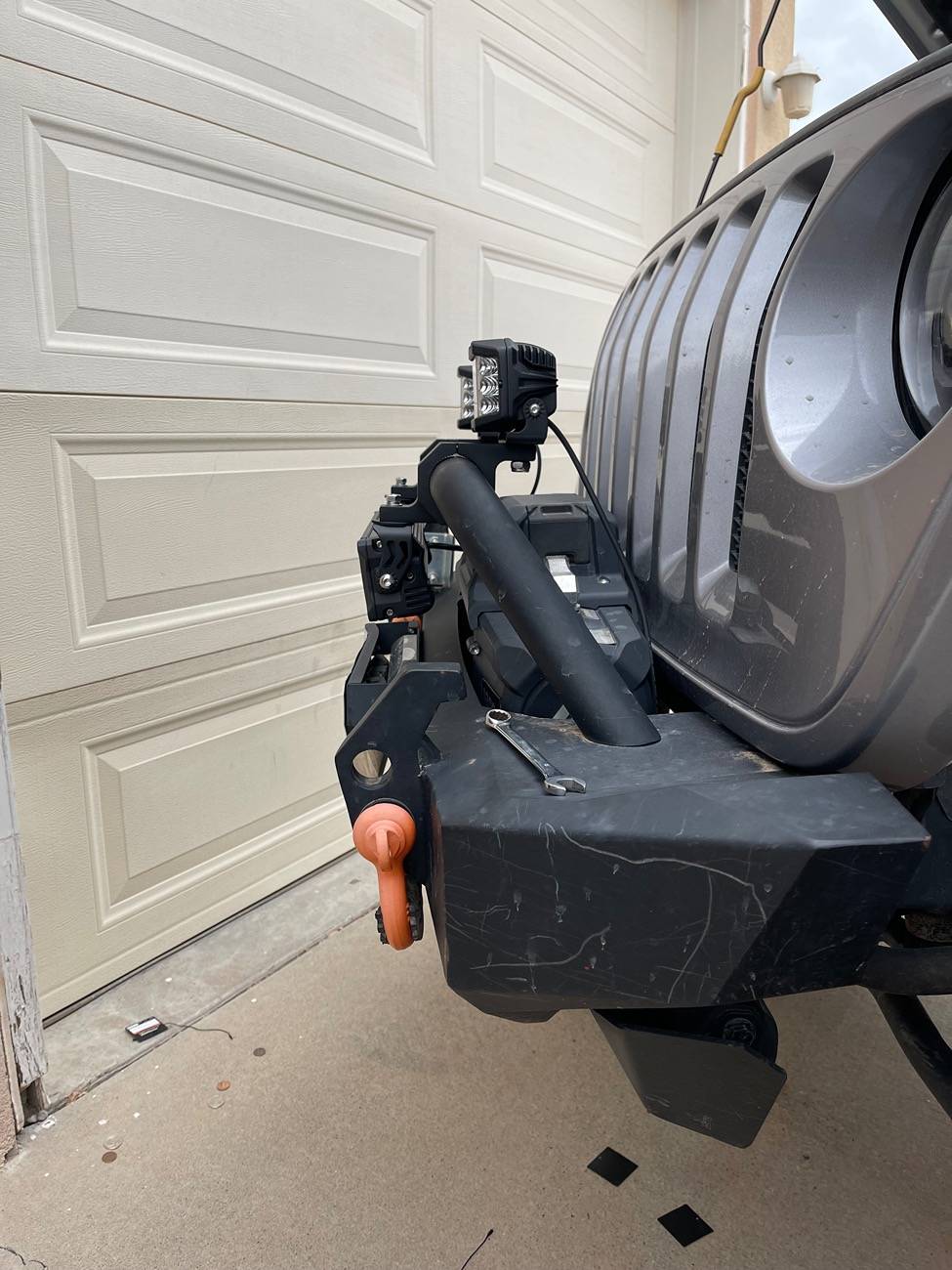

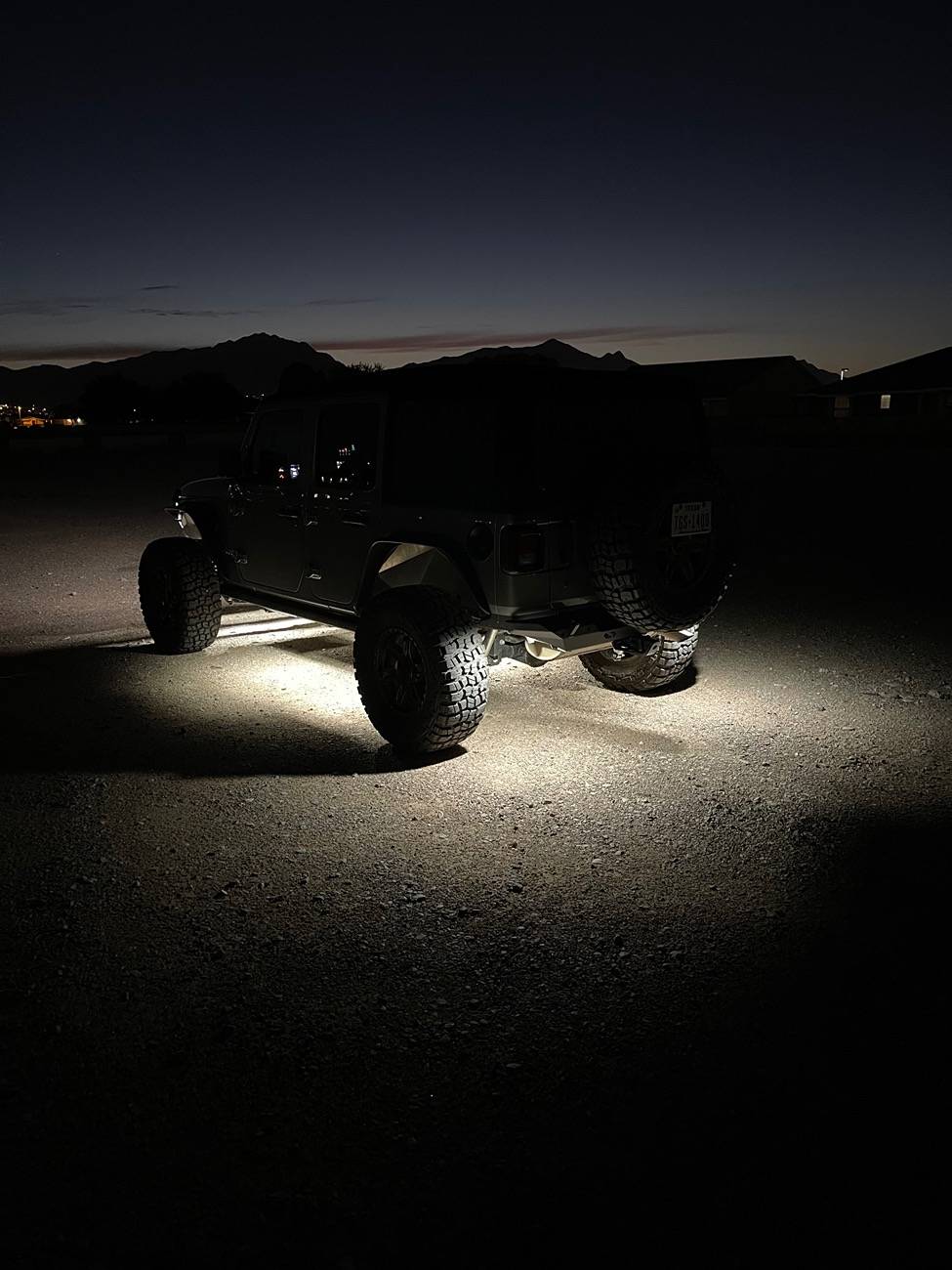

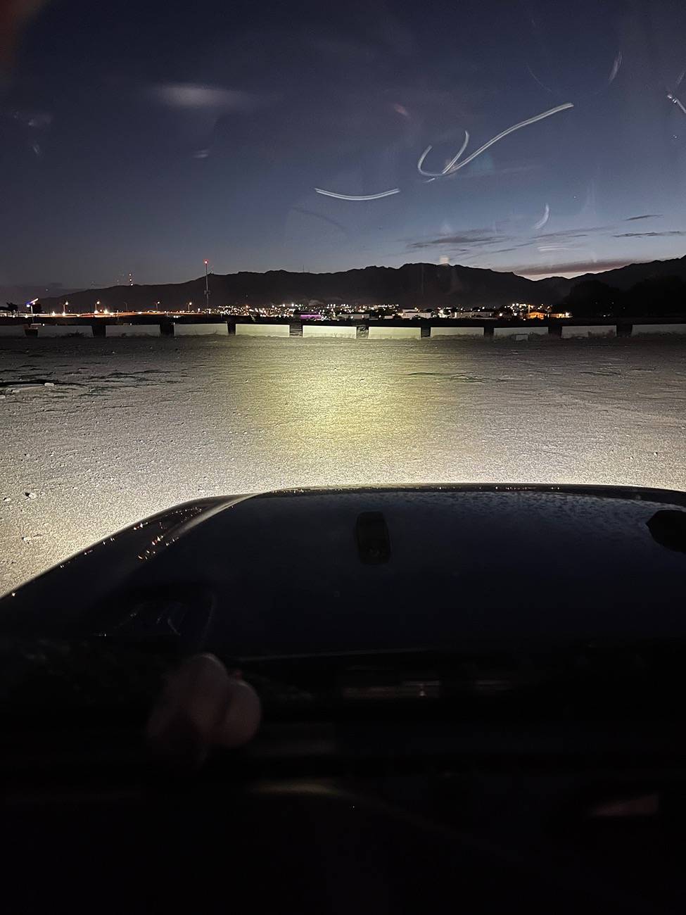

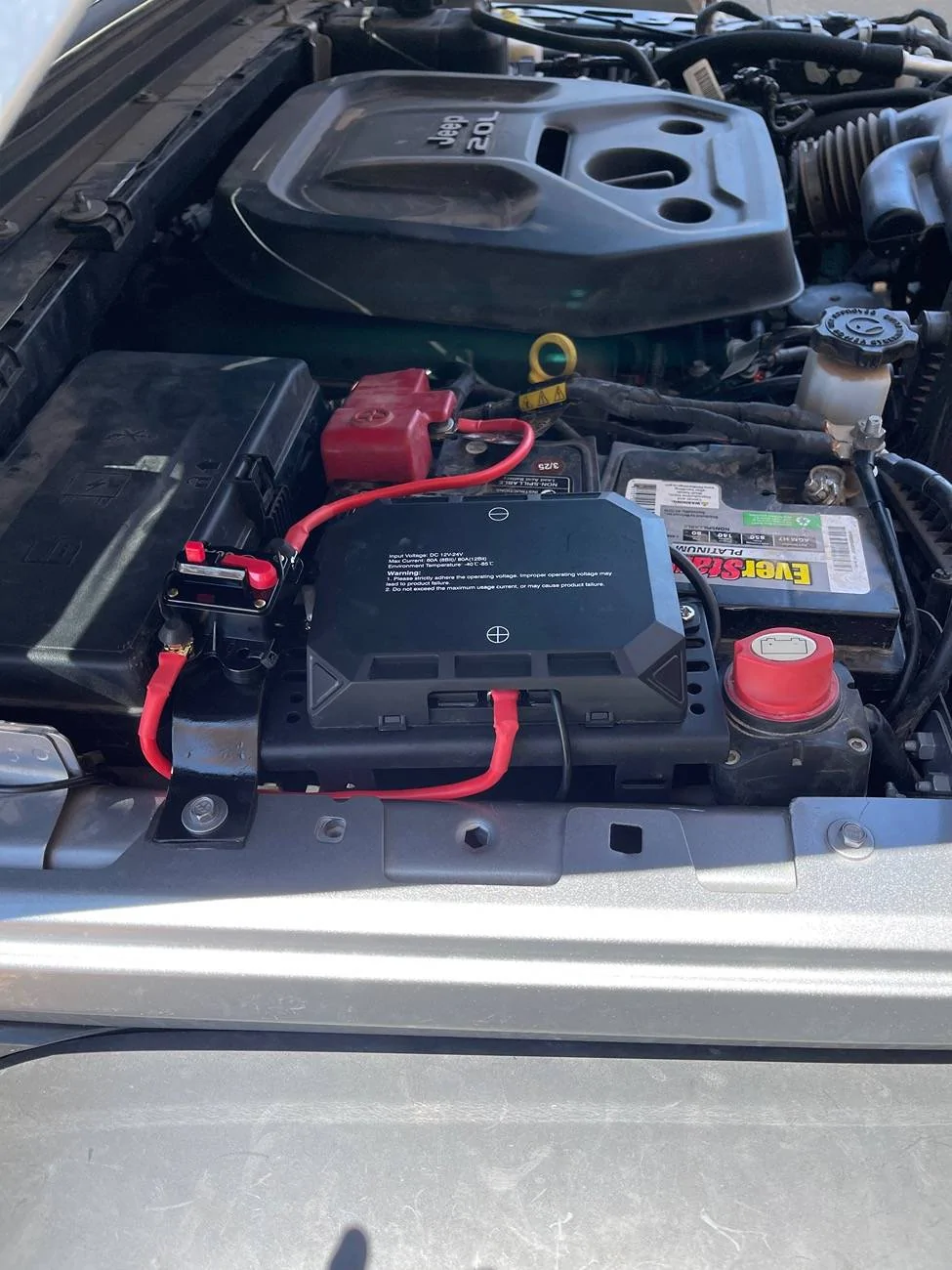

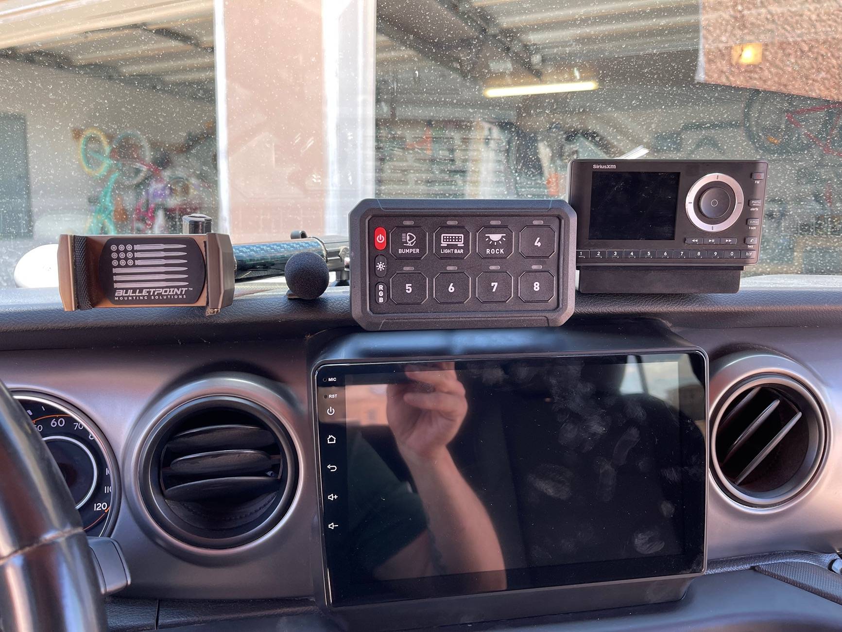

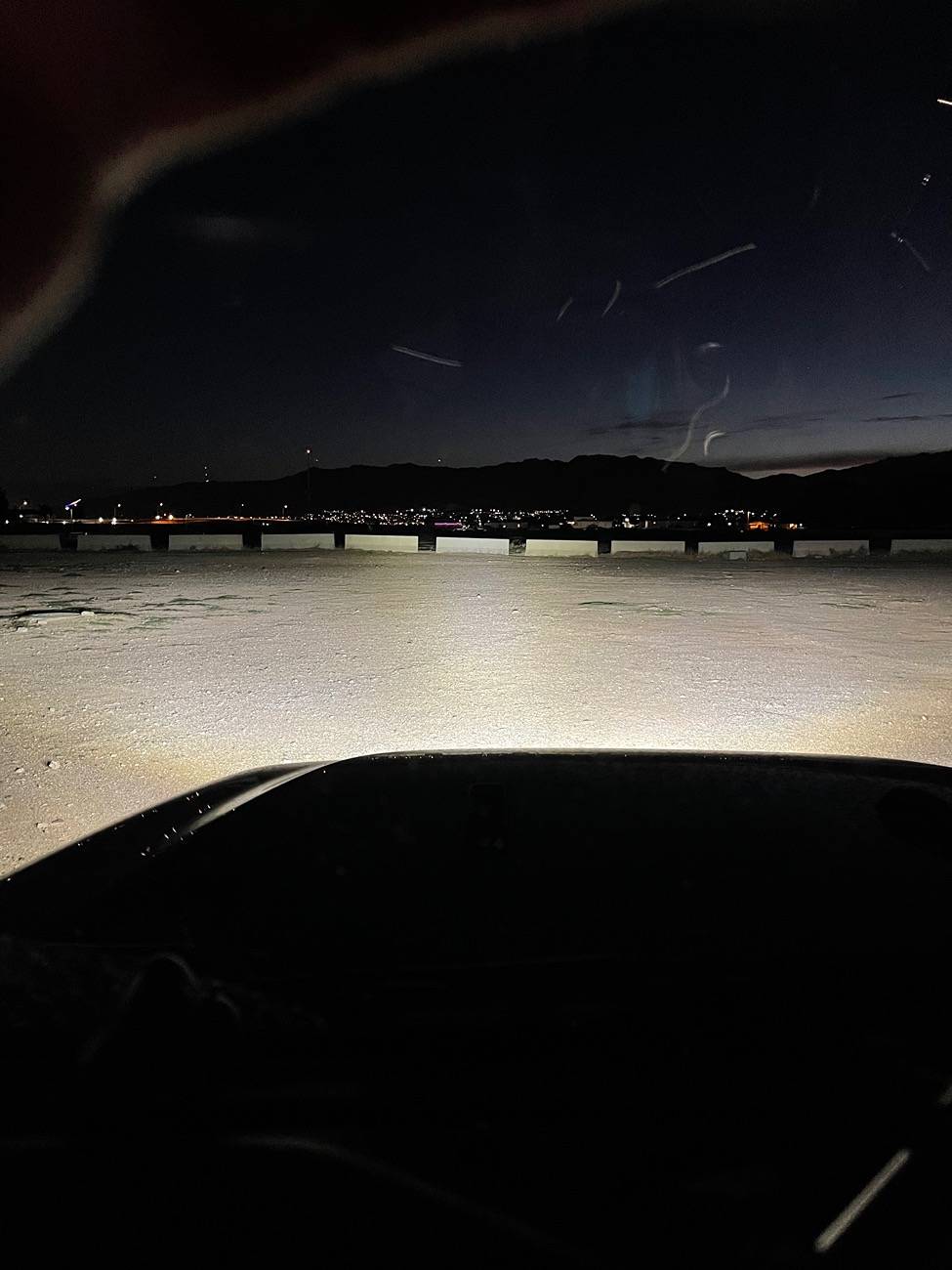

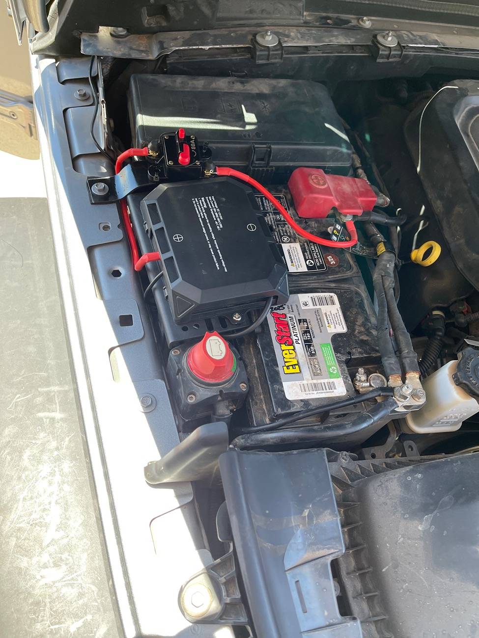

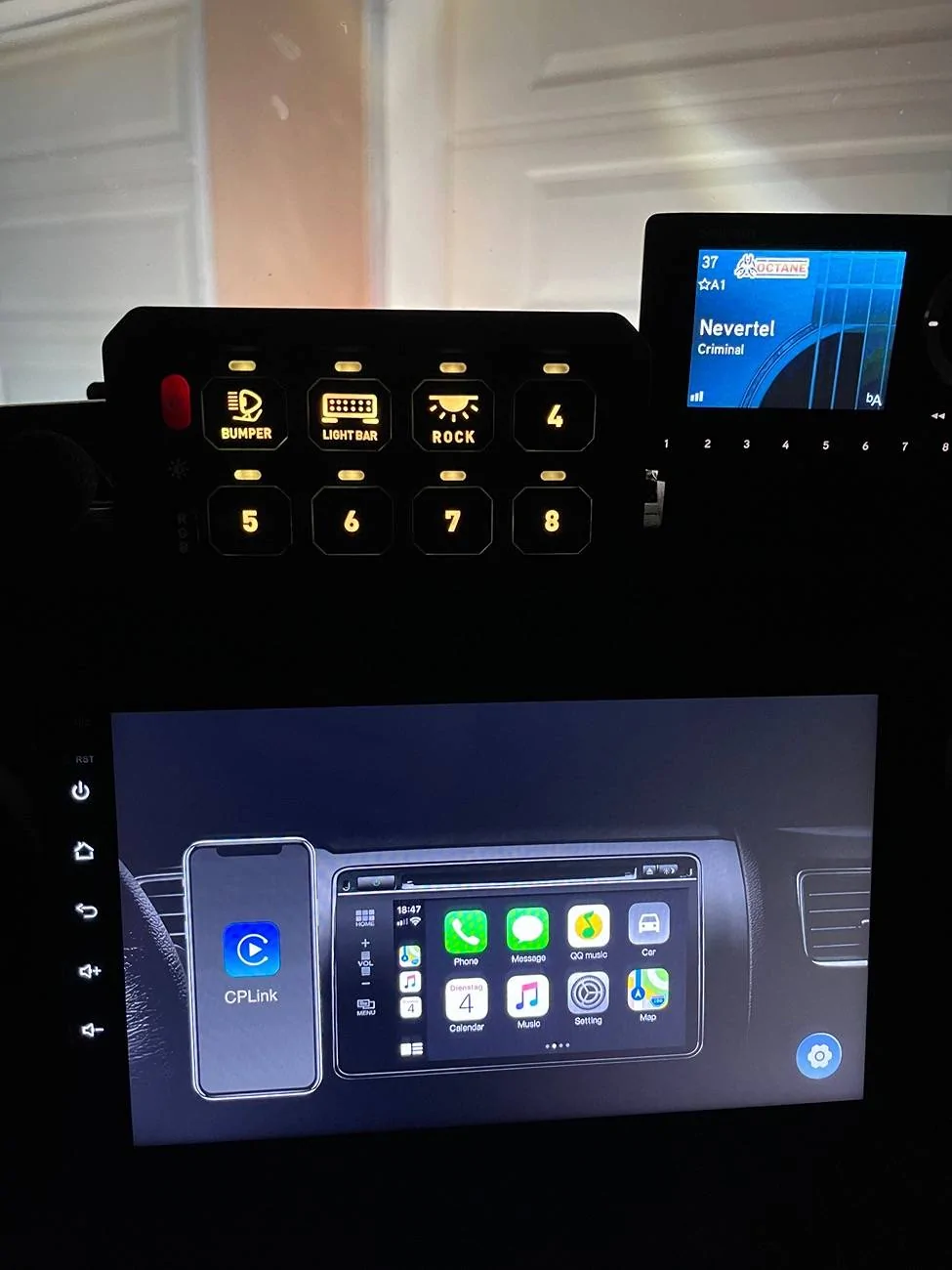

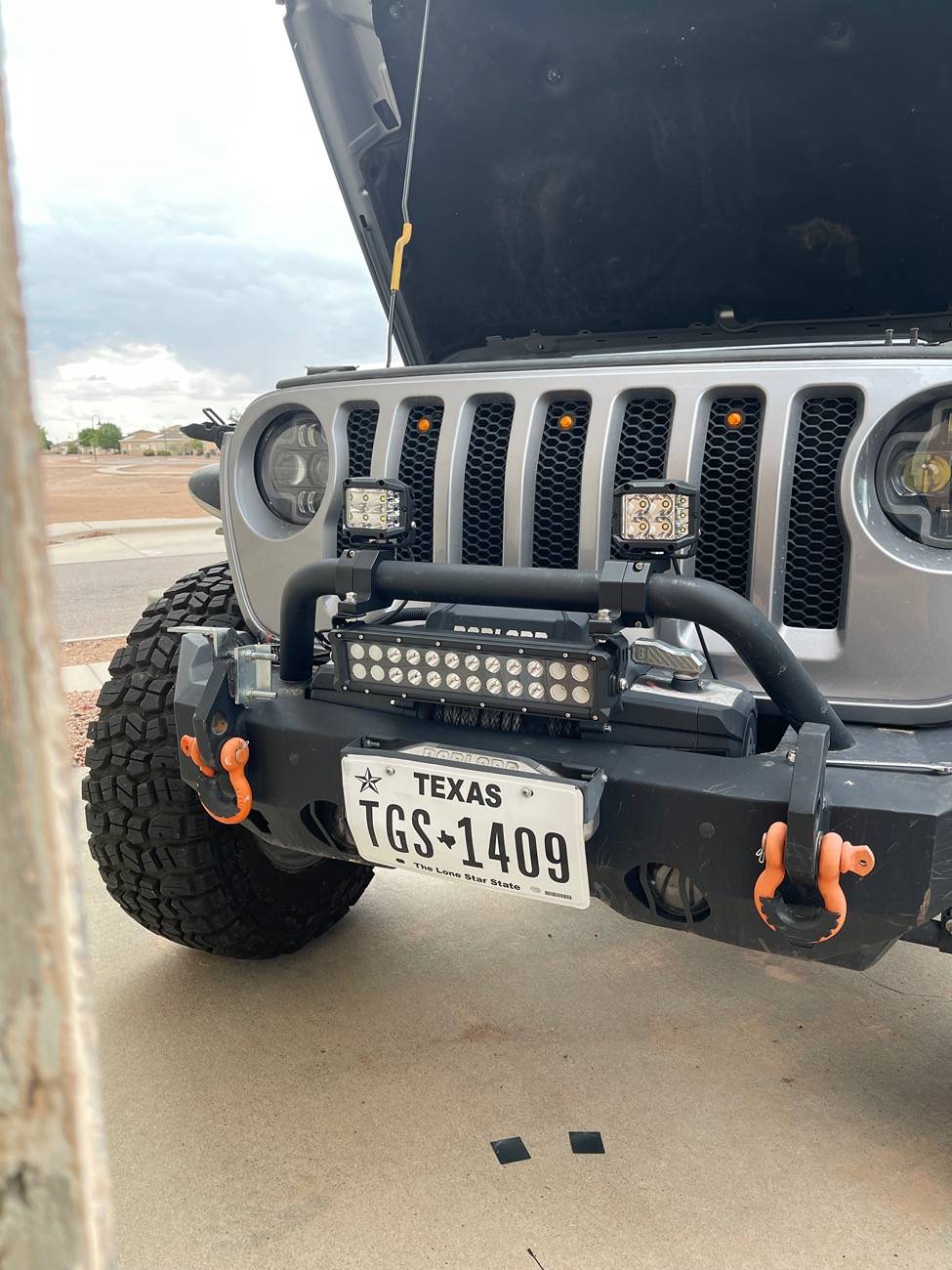

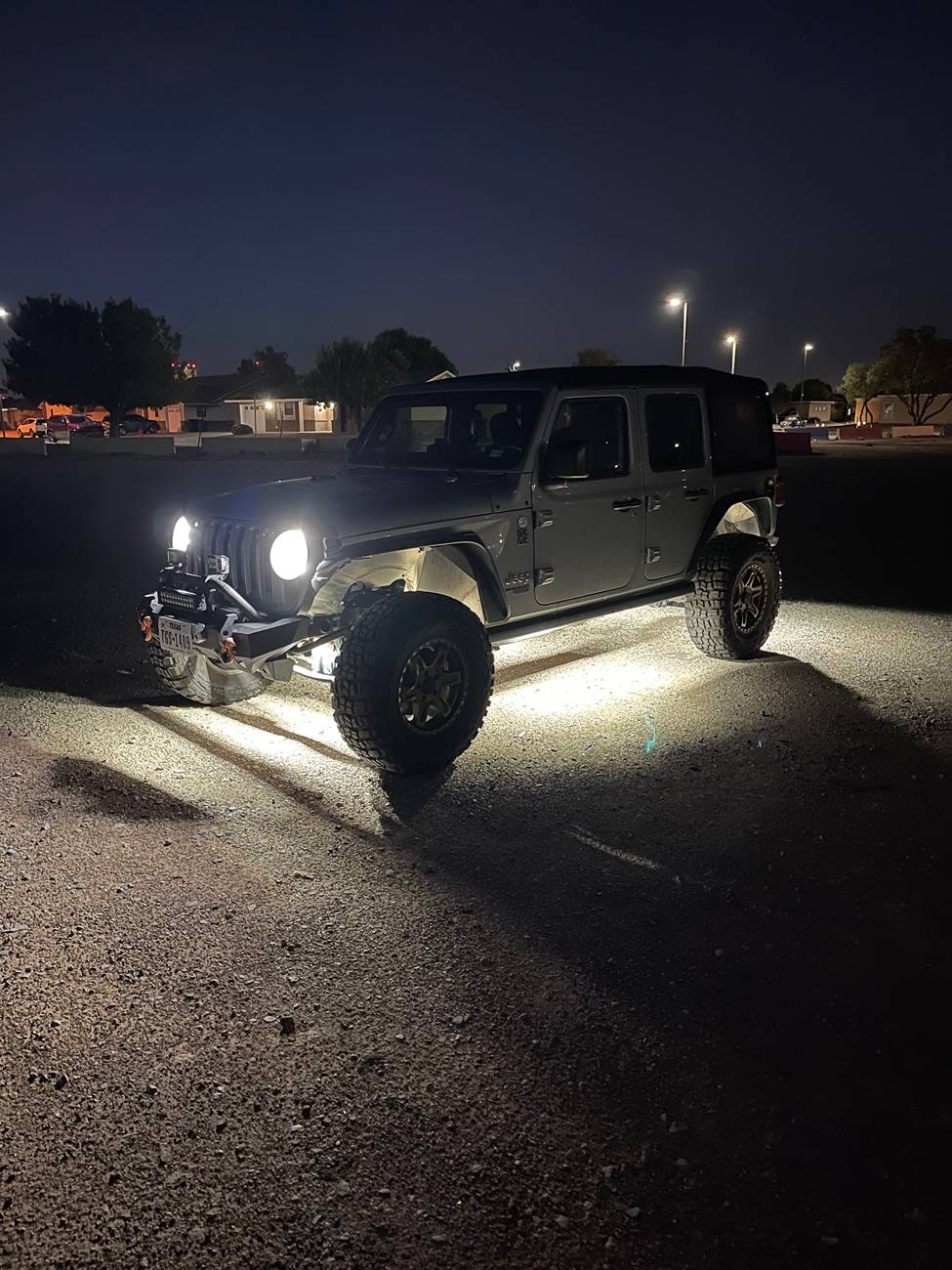

Well I’ve been meaning to install some lights for a while. Finally got motivated as we have a night wheelin’ run tomorrow. Rock shock 12” light bar, 3” side shooters, and some rock lights. All controlled by a 8 gang RGB controller, it’s the same as a mictuning, just half the price on eBay.
I’m happy with how clean everything turned out.
I’ll have to grab some pics tonight when I go aim everything.
Jeep Wrangler JL My JL build. IMG_4156
Jeep Wrangler JL My JL build. IMG_4157
Jeep Wrangler JL My JL build. IMG_4166
Jeep Wrangler JL My JL build. IMG_4167
Jeep Wrangler JL My JL build. IMG_4169

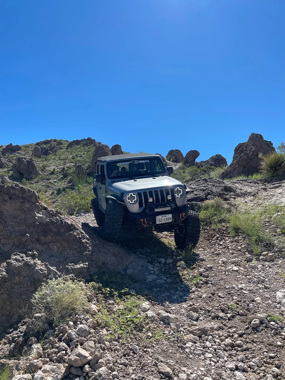

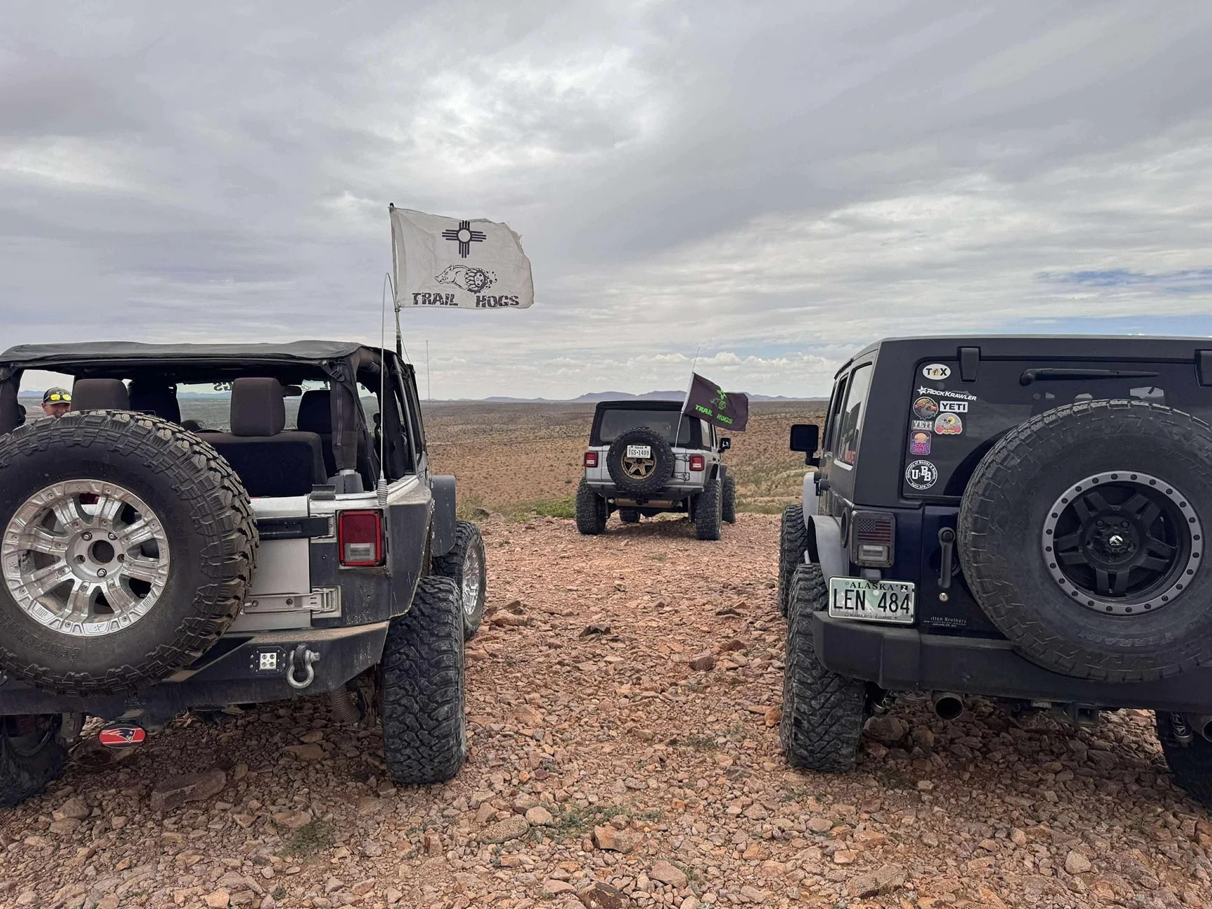

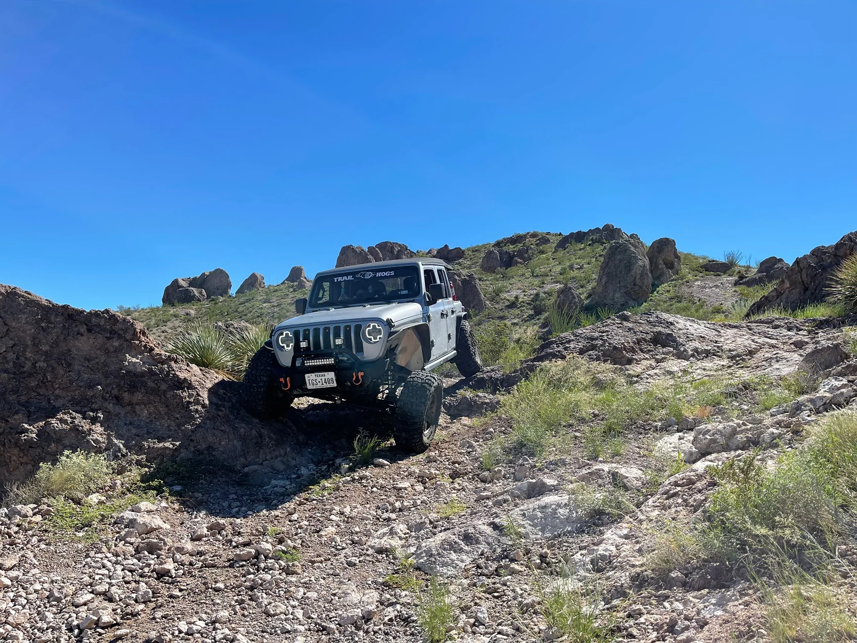

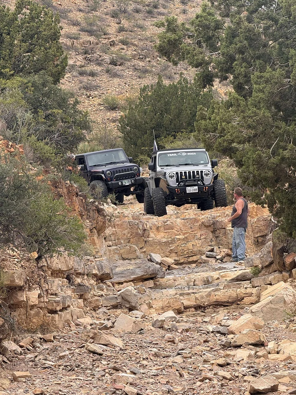

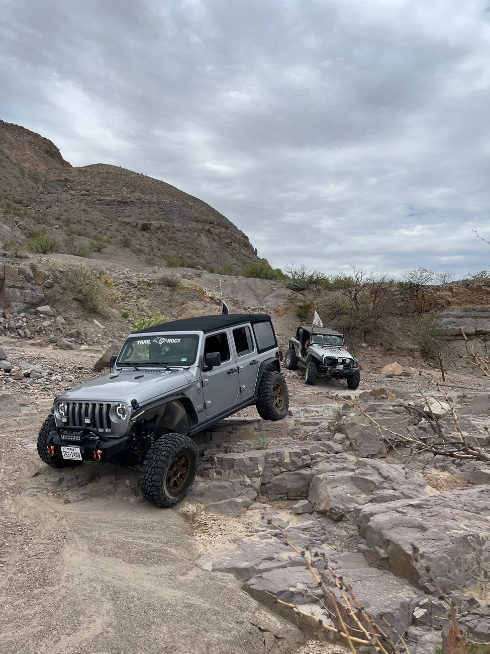

Some pics from the trackways. Love the setup to this day.

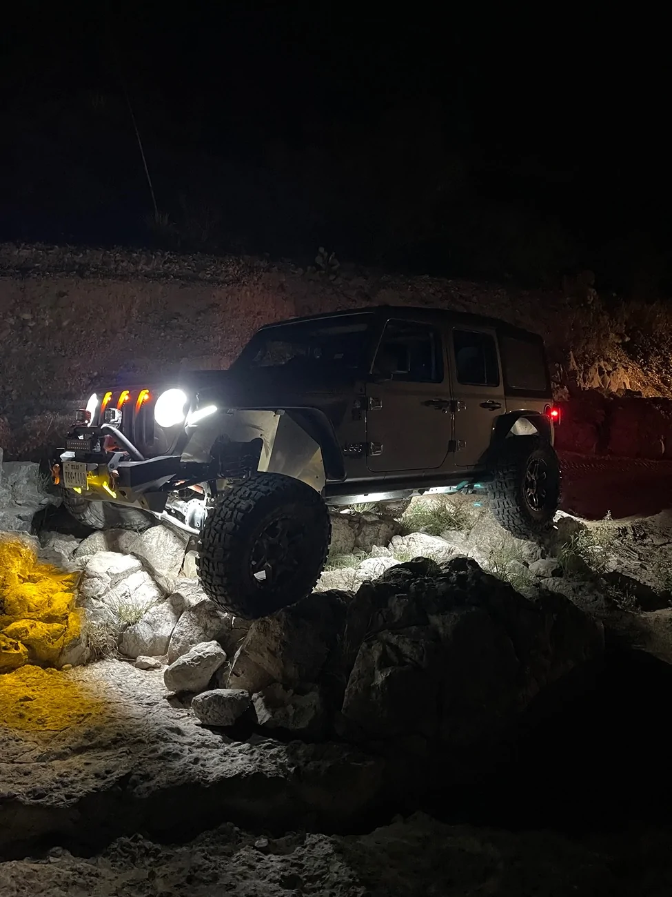

Well, continue to be impressed with this Jeep. You don’t need to spend big money or have a Rubicon to wheel or in my case wheel hard. All in, with the used springs, mopar front LCAs, eBay disconnects, and clearance Rancho shocks I’m at right around $400. The front end couldn’t stuff any further without, and droops enough I could justify an aftermarket front shaft. The Jeep never feels tipsy, rides great going 25-30 down dirt roads, and just performs.
Jeep Wrangler JL My JL build. 0a98a43871bf8a1b65a4c3fbd4f21279
Jeep Wrangler JL My JL build. IMG_4562
Jeep Wrangler JL My JL build. IMG_4869
Jeep Wrangler JL My JL build. IMG_4195
Jeep Wrangler JL My JL build. IMG_4868
