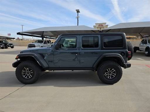

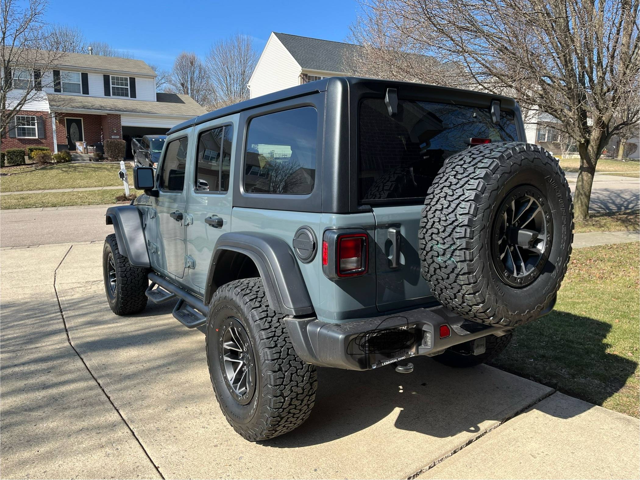

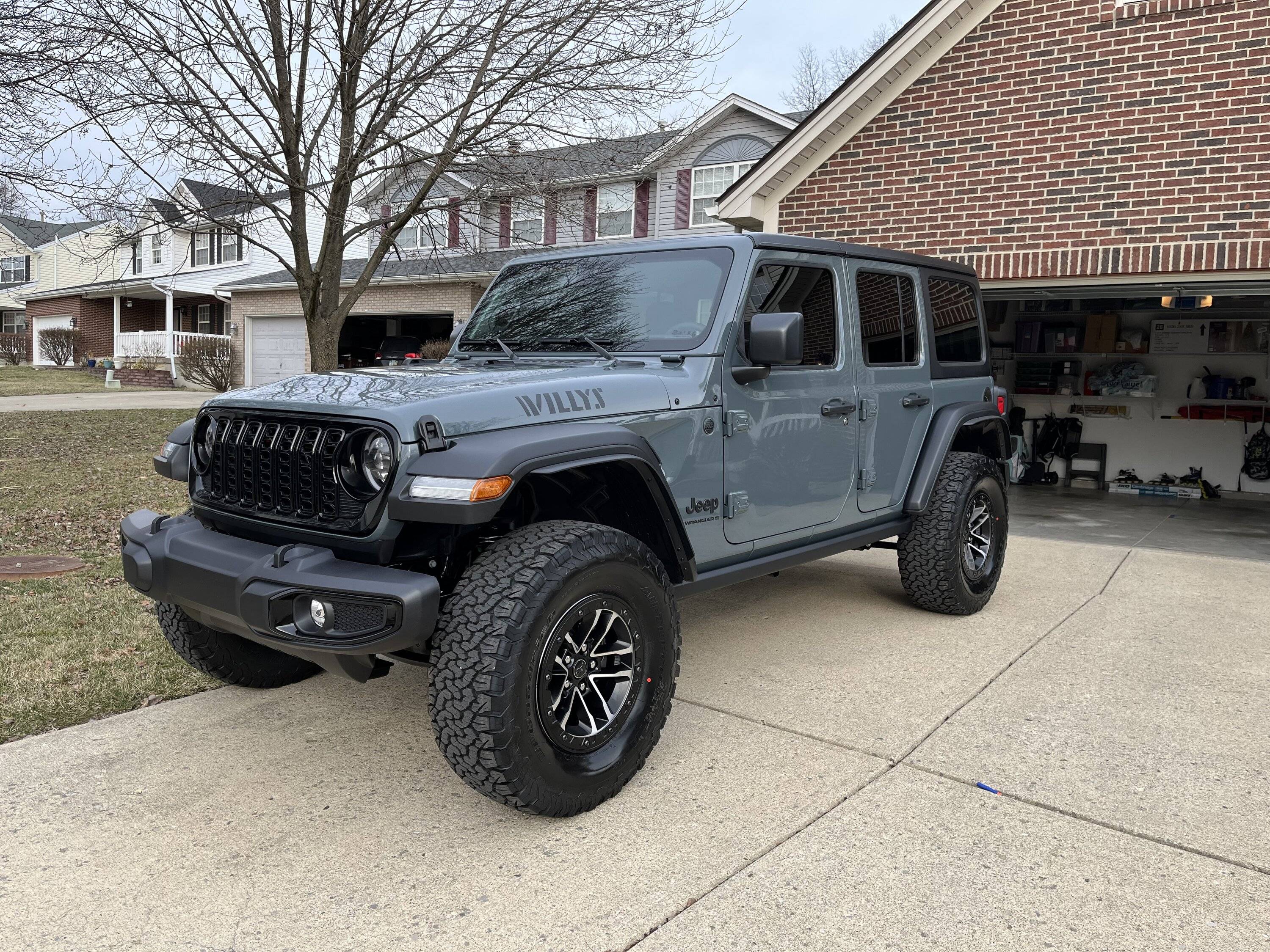

So, on Tuesday, I decided to pull the trigger and trade in my ‘21 JLU Willys and got this beast! It is a ‘24 Willys XR, in Anvil…and I love it. Way more planted and more stout than my’21 ever was. I especially love the hardtop, cuts down on so much of the road noise that the softtop had. Already did my first upgrades (well technically I just moved my nerf bars and gas cap cover over); but, it is a work in progress. More to come…

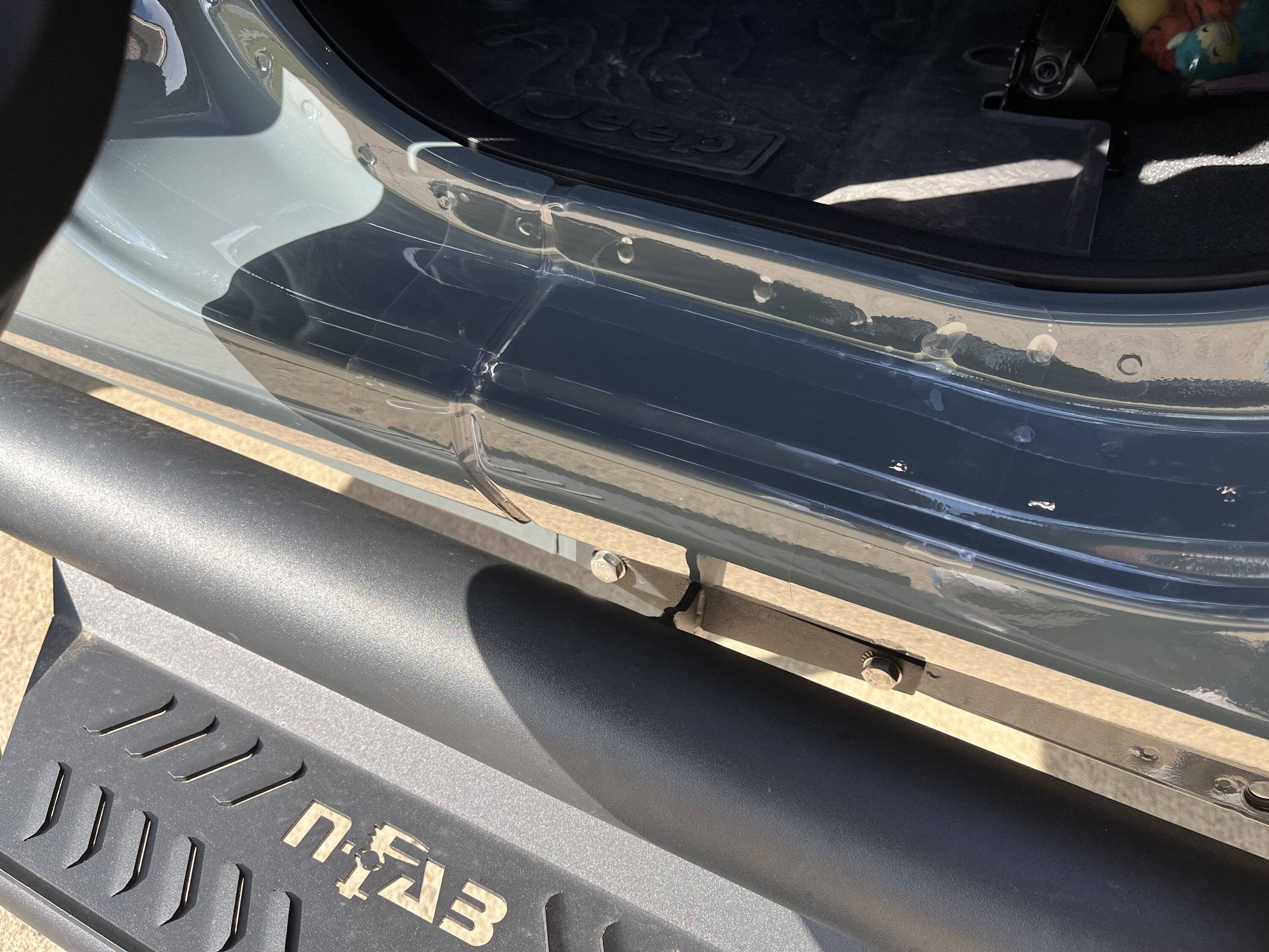

Did another “mod”, yesterday. I installed the Luxe Auto Concepts PPF door sill protector film. $55 with shipping and I now have pretty decent and good looking door sill protection.
The front turned out really well, and I barely noticeable:
Jeep Wrangler JL My new build IMG_1148
Jeep Wrangler JL My new build IMG_1149
The rear turned out terrible, due to the body seam. Got home today, ripped off the rears and installed the extra pieces…they turned out so much better.

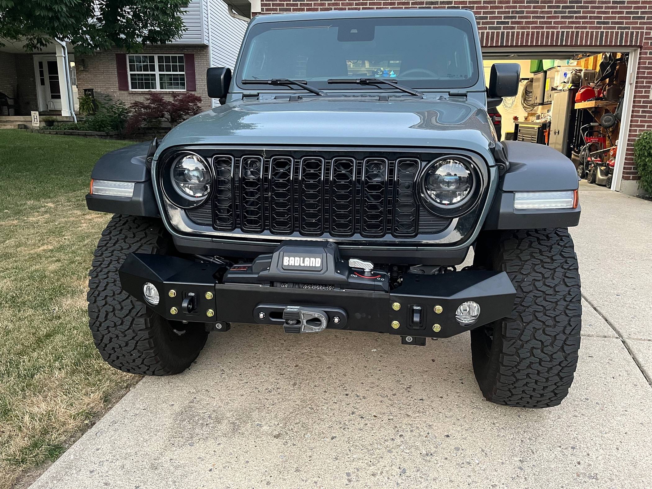

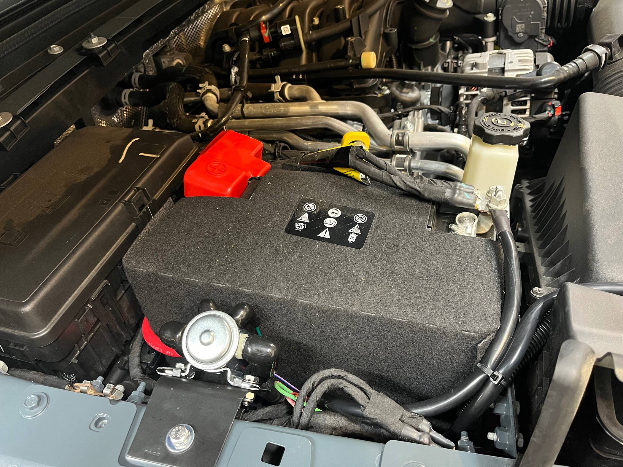

Well, I finally got around to installing my front bumper and winch. I went with the MetalCloak frame built bumper, with the fog light extensions. Opted for the Badlands Apex 12,000lb synthetic line winch, with a Factor 55 snatch block on the end of the line. I just gotta install line guard, on the snatch block, and tension the line.
Also, while I was at it, I decided to install a Warn power interrupter kit and hooked it to aux switch 4. Decided it was a good idea/investment to be able to control the power to the winch and not have the power line “hot” all the time.

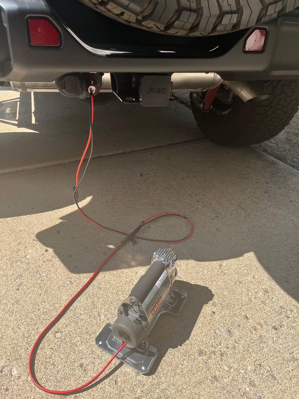

So, I finally got around to another mod. Not really a mod to the Jeep…but, more of a mod to a Jeep accessory. I changed out the wiring to my Viair 400P to some 10AWG wiring, with an SAE connector on the other end. This allowed to build a fused harness with an SAE connector (on one end) and wire the other end into a 7-pin connector. I also ordered a fused 10AWG setup, with SAE on one end and gator clips on the other end. Now, I can use a 7-pin or a battery to power the compressor. Gives me the option to not have to get under the hood every time I use it.
Now I just need to build a 4 way airline setup. Gotta figure out if I am gonna use pneumatic brake lines or air hose (like the Morreflate stuff).
