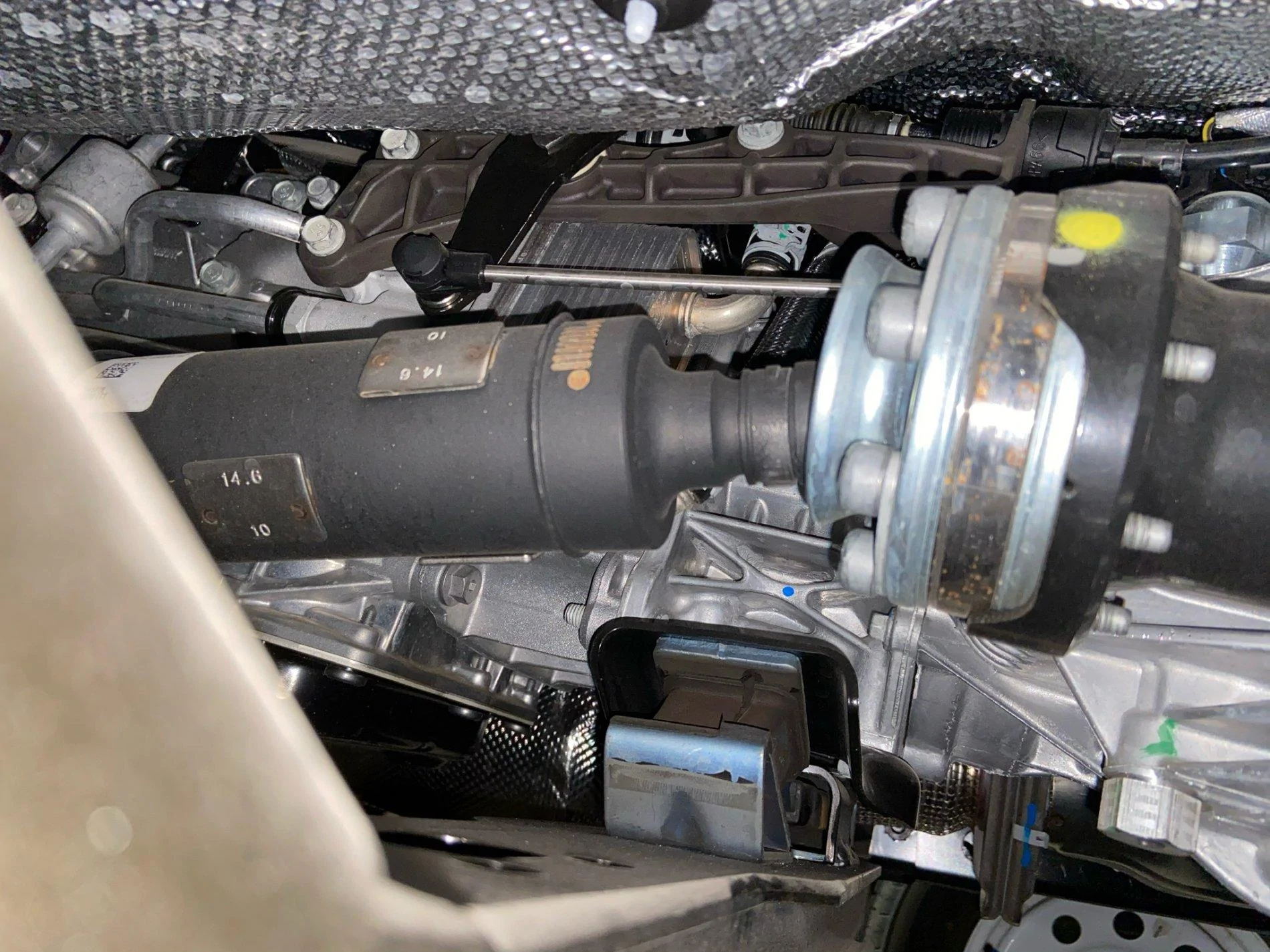

Website says no need for new drive shaft. I am just curious because I read on some lifts they need a new front shaft. Here is a pic of mine on 2.5”, notice the angle.
That boot IS GOING TO RIP - sooner than later. When it rips all the grease will rapidly fling out everywhere. Once all the grease is gone it will quickly overheat and then “grenade” which could break all sorts of other shit under your Jeep or even tear a hole in the bottom of the body!
Not to mention when it happens you better have at least the tools and skills required to remove that broken driveshaft on the trail... and then unless your carrying a spare (which I’m certain you’re not since your still on a stock DS) your stuck in 2wd. Better hope you don’t NEED 4wd to get back out of wherever you broke it.
If it were me id be replacing that ASAP before any hard wheeling. It’s wayyyy easier to do NOT on the trail.
JE Reel makes awesome driveshafts, Adams are great too. Can’t go wrong with either.
You measure your Jeep and give them the measurements and they will make a custom one for you which will be much more reliable at those angles and will actually withstand some off-road abuse (unlike the stock unit which will crumble like a tin can on a rock)
Whoa settle down there Jimmy. Holy crap you make it sound like the world is going to end when that boot rips. I drove around for a year with the boot all ripped up PLUS, since I have no FAD up front anymore, my front driveshaft was always spinning.
Yes, that boot will EVENTUALLY rip, the grease will come out but it does not go "everywhere" and then it will take quite awhile until it starts to give him problems. It's not going to grenade if he still has his FAD in place because with the FAD in place the front axle only rotates when it is in 4H or 4L.
After a year mine finally started to make some clicking noises when I was in Moab a few weeks ago so I knew it was time to replace it and I went with an Adam's one.
Obviously it is a good idea to replace it but you are making it sound way worse than it is. I'm in the same boat as he is with my wife's Jeep on a 3.5" lift. She has the FAD still and she wheels the heck out of that thing, and I am keeping an eye on the boot and when it tears she will be getting a new front shaft. @Robbyreneeward there is no need to put the Jeep up on blocks and not drive it with the stock front shaft. Just understand that you need to keep an eye on the boot because it will EVENTUALLY tear but that may be years from now. You can wheel it with no problems just like 1000s of people already have. The sky is not falling...
Yes it can be wheeled. Just like you COULD slap some 44” Super Swampers on there with stock Sport axles and go rock crawling. Would that end well probably not, but could it be fine for a few trips - sure.
Just because you can doesn’t mean you should. Anything over 2” ~ 2.5” lift exceeds the max angle of the joint and comprises reliability. That’s all I was saying.
And for a less seasoned guy maybe they don’t want to deal with breakage and just want to set the Jeep up right out of the gate.

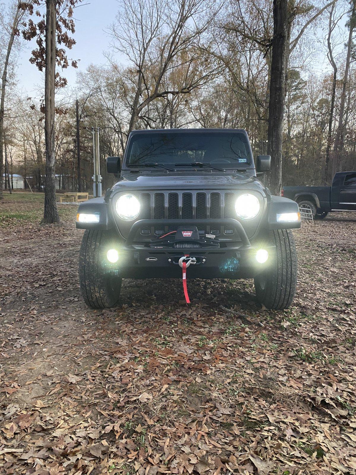

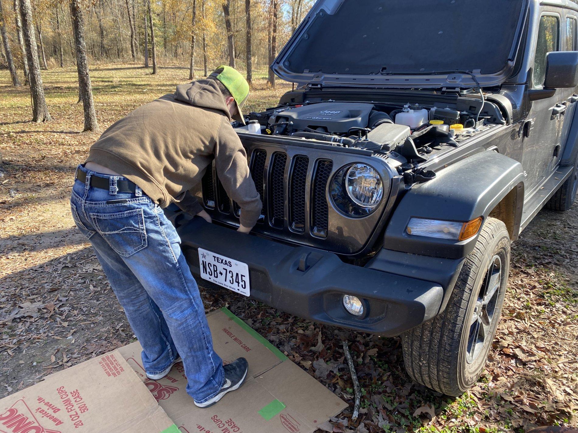

Added the oracle switchback DRL lights today. Quick mod. Took all of 5 minutes. If they were all only this quick!!! Like the look a lot. Bumpers will be here next Tuesday. Still waiting on the rest of the stuff from oracle as well.

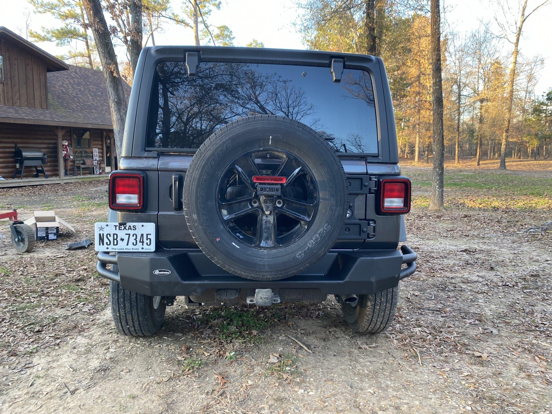

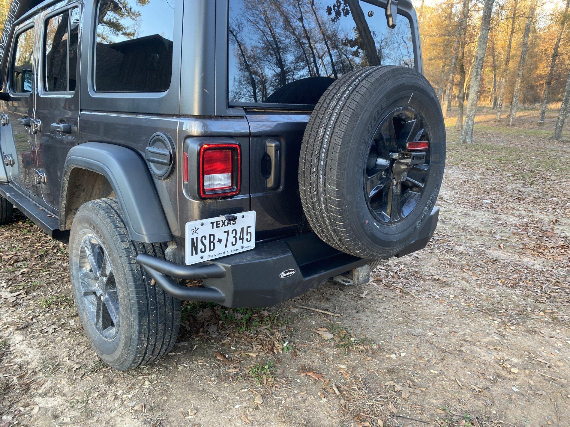

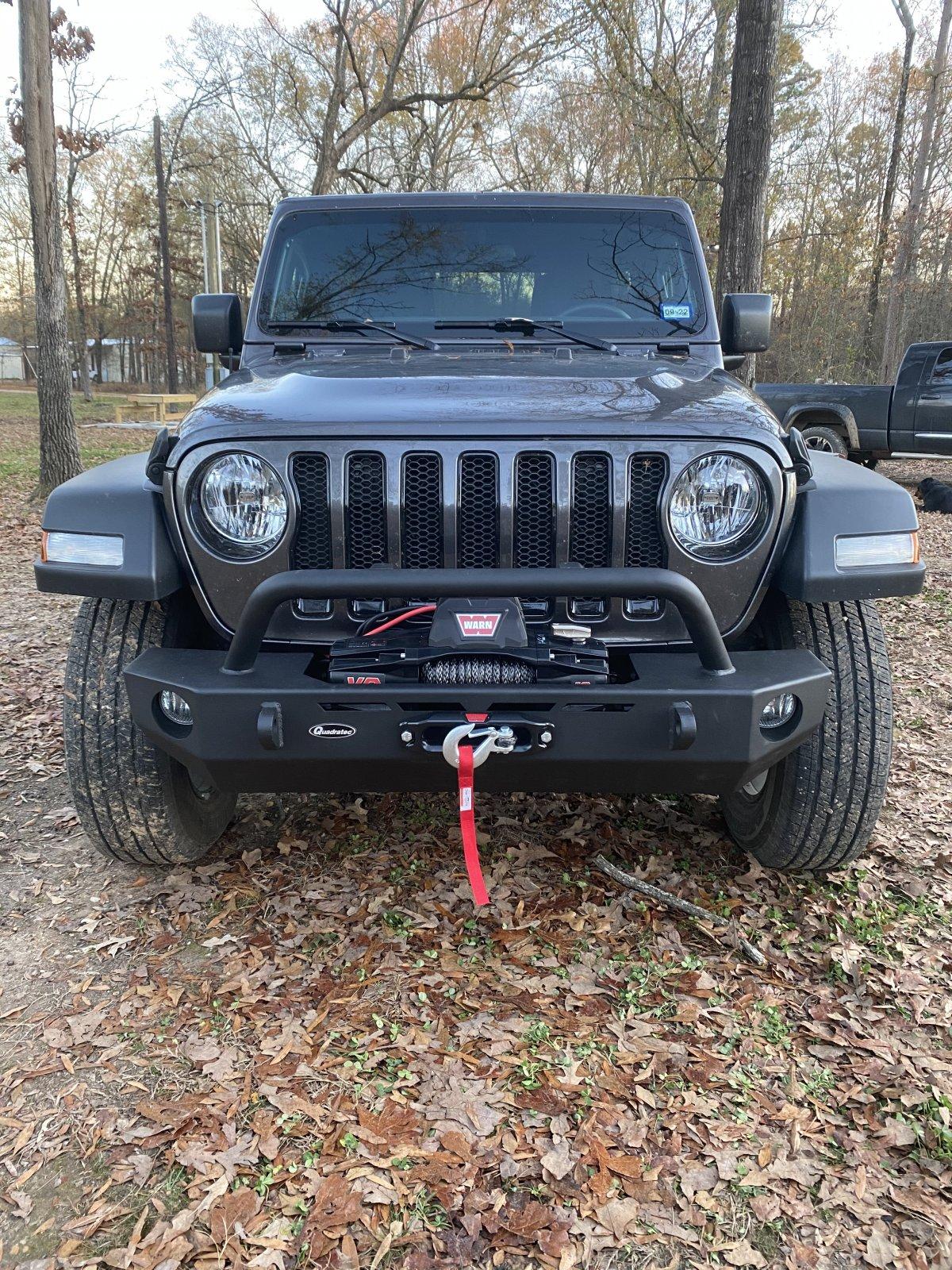

Finally have time to install bumpers and winch. Putting the 14 year old to good use!

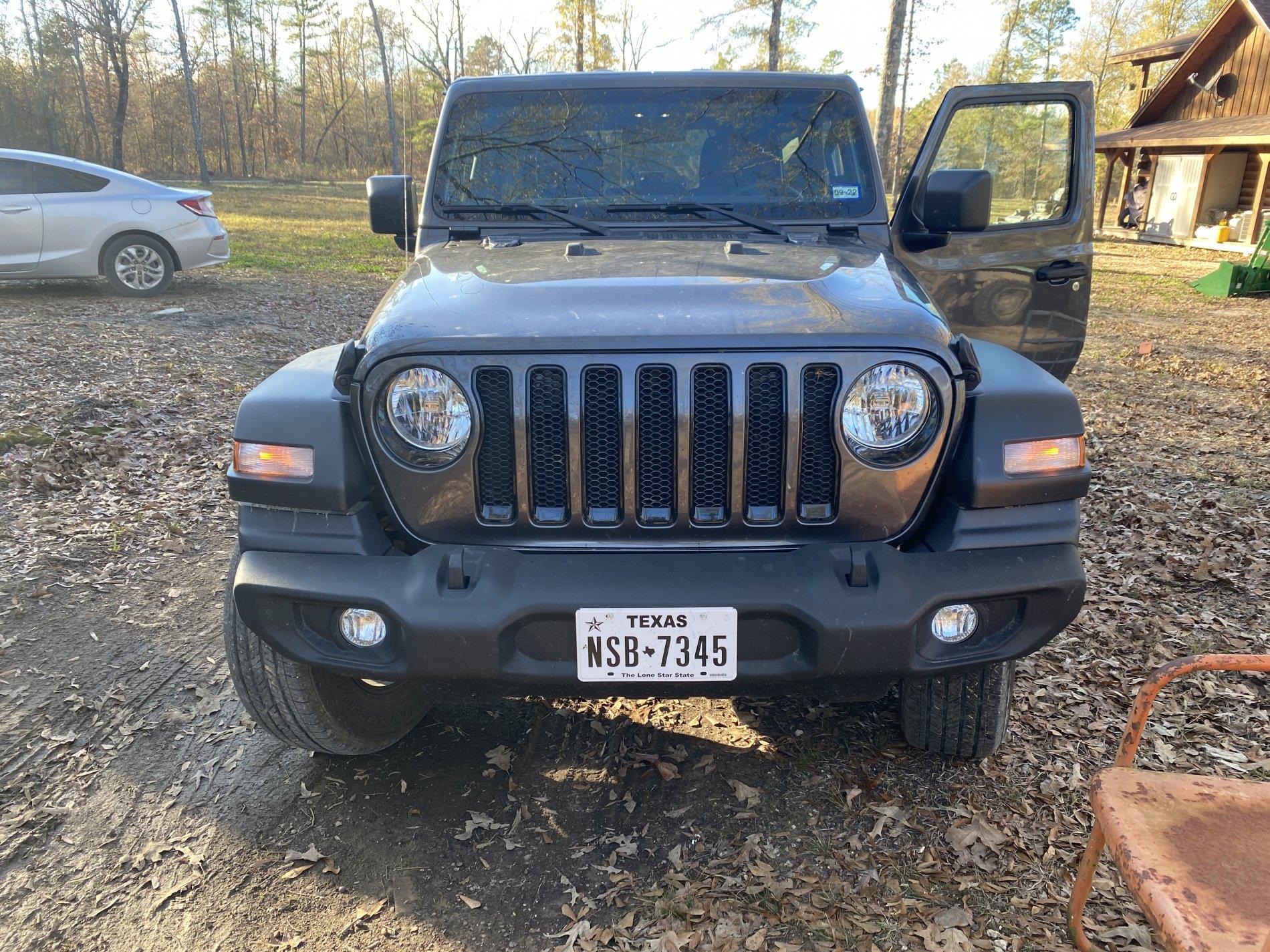

Front bumper mounted, back bumper mounted, license plate bracket and light on back. And winch has been installed and line spooled and straightened out. Also got the LED bulbs replaced since I had the bumper out.

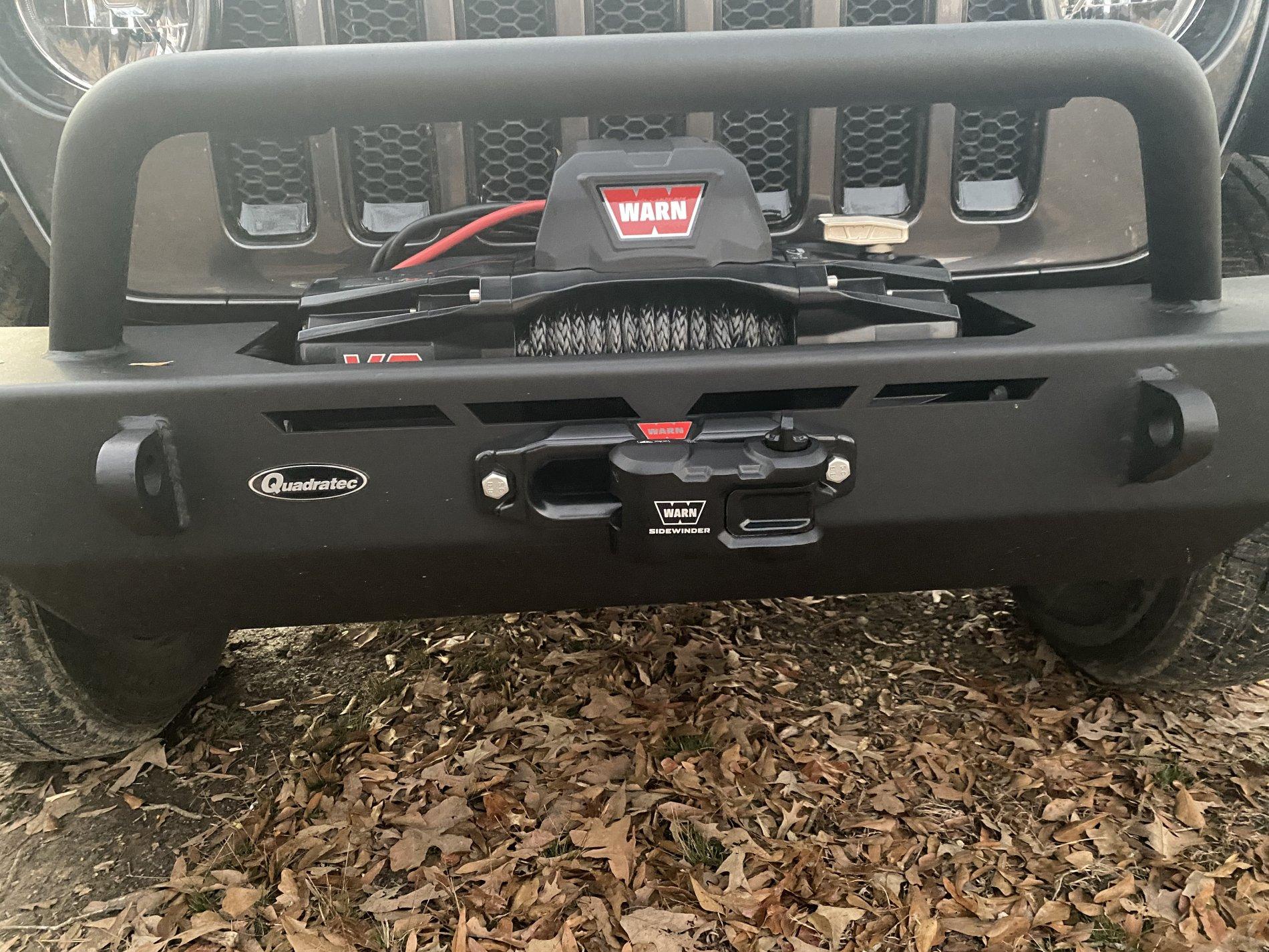

Got the warn sidewinder in replace of my winch hook.
