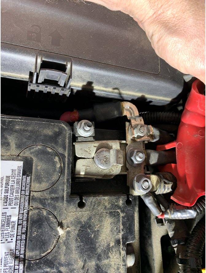

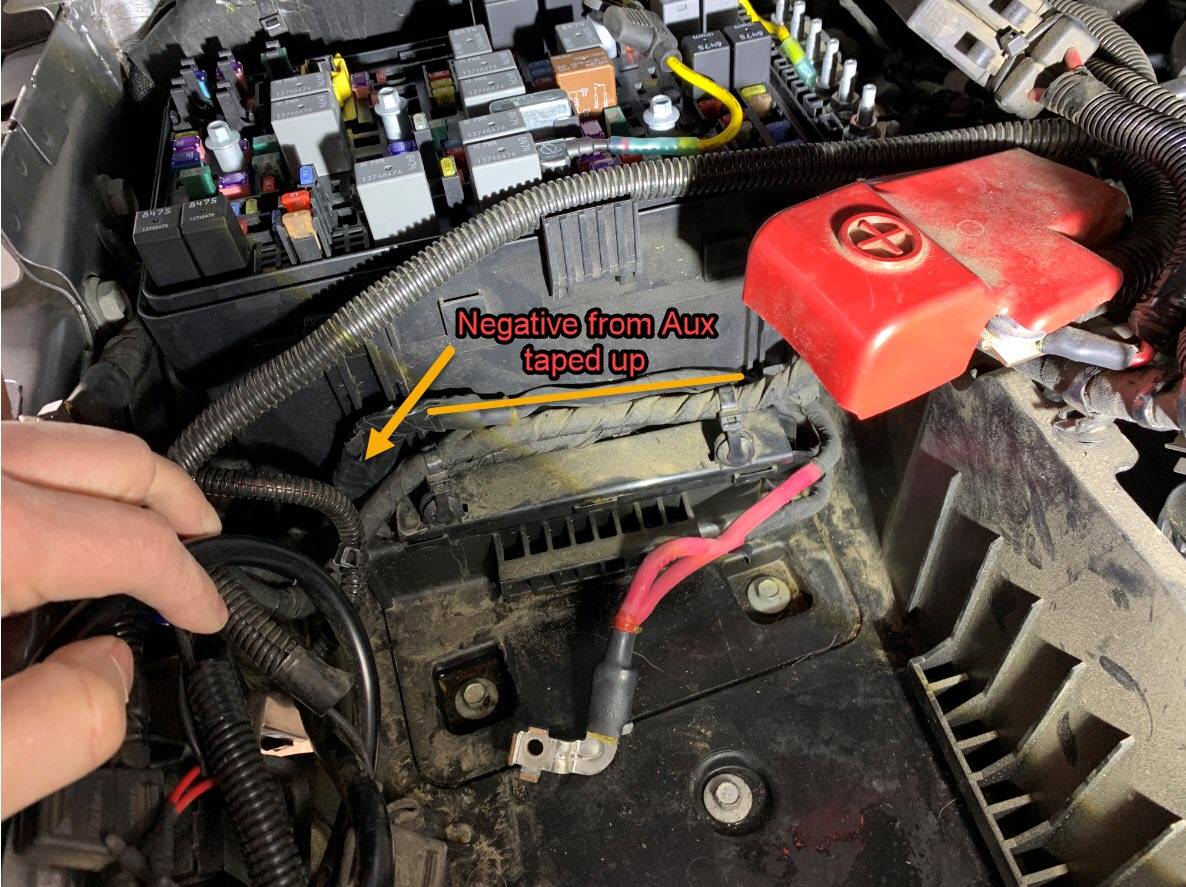

Okay so there is a lot of great threads on how to delete the auxiliary battery both from the top and from the bottom. One thing I think I did differently and thought you would all like to know is you can move the aux wiring to the main battery WITHOUT removing the fuse box. Quite frankly removing the fuse box scares the hell out of me.
You need to remove the aux battery from the bottom and also remove the main battery. With both batteries removed, you can then push/pull the aux wiring through the small hole in the aux battery area to the main battery area.
