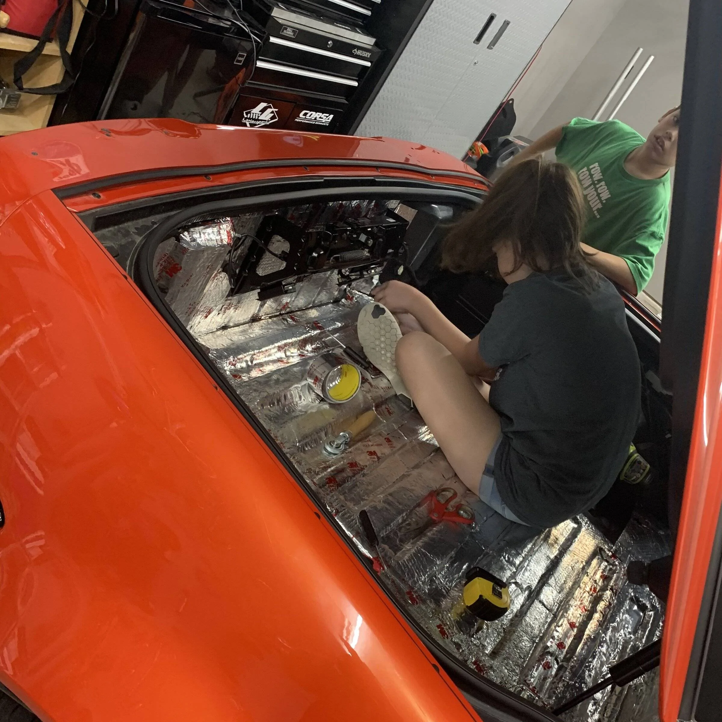

Jenn, as much as I like working on them, it was a huge amount of work. I did it during the height of the pandemic when we were just staying home. I was recently retired and I just took my time. Spent about a month doing this.
However, for heat, this is not much help. Some. But not a lot for the effort. Dynamat makes a heat insulating foam mat called Dynaliner. Heat Protection and Thermal Insulation For Your Car | Dynaliner | Dynamat I put some 1/4" in mine as shown below. It helps with heat and noise. The foil backed butyl rubber is primarily a sound deadener. In order to insulate heat efficiently, you need air. The foam provides that air. That's for the inside.
I still think you might benefit from a better reflective/insulator material on the firewall/tunnel side where the catalytic converter is.
This company makes products like I was thinking you may benefit from. Reflective Heat Shield | Design Engineering Inc. In their line, possibly that Form-A-Barrier material. Other companies make similar materials. That was just the first one that I found when googled. As you can see, it's not just a metal foil, but contains a material with air captured in a layer. So, a reflector (foil) and an insulator (foam, fiberglass, ceramic wool, etc.)
