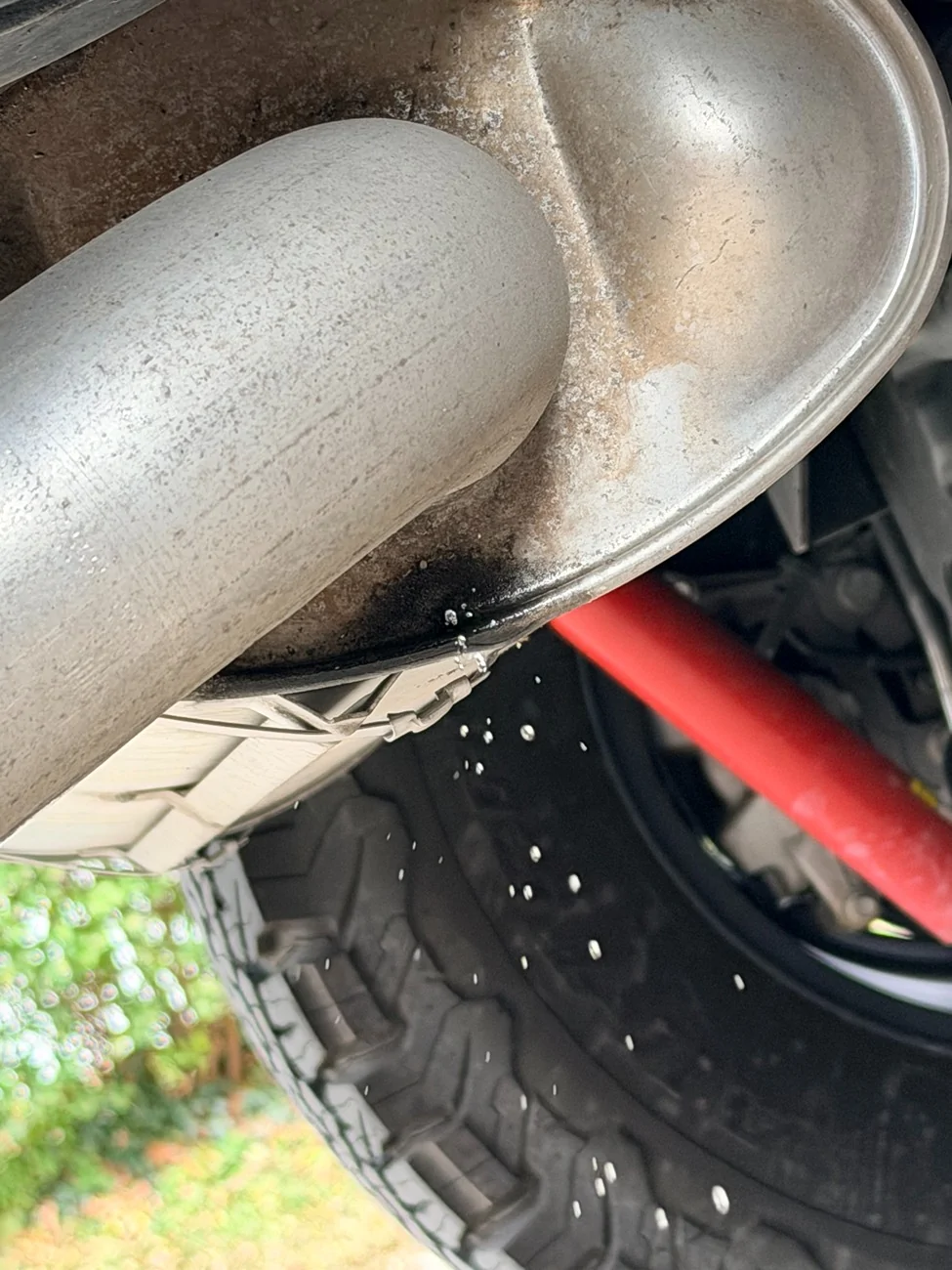

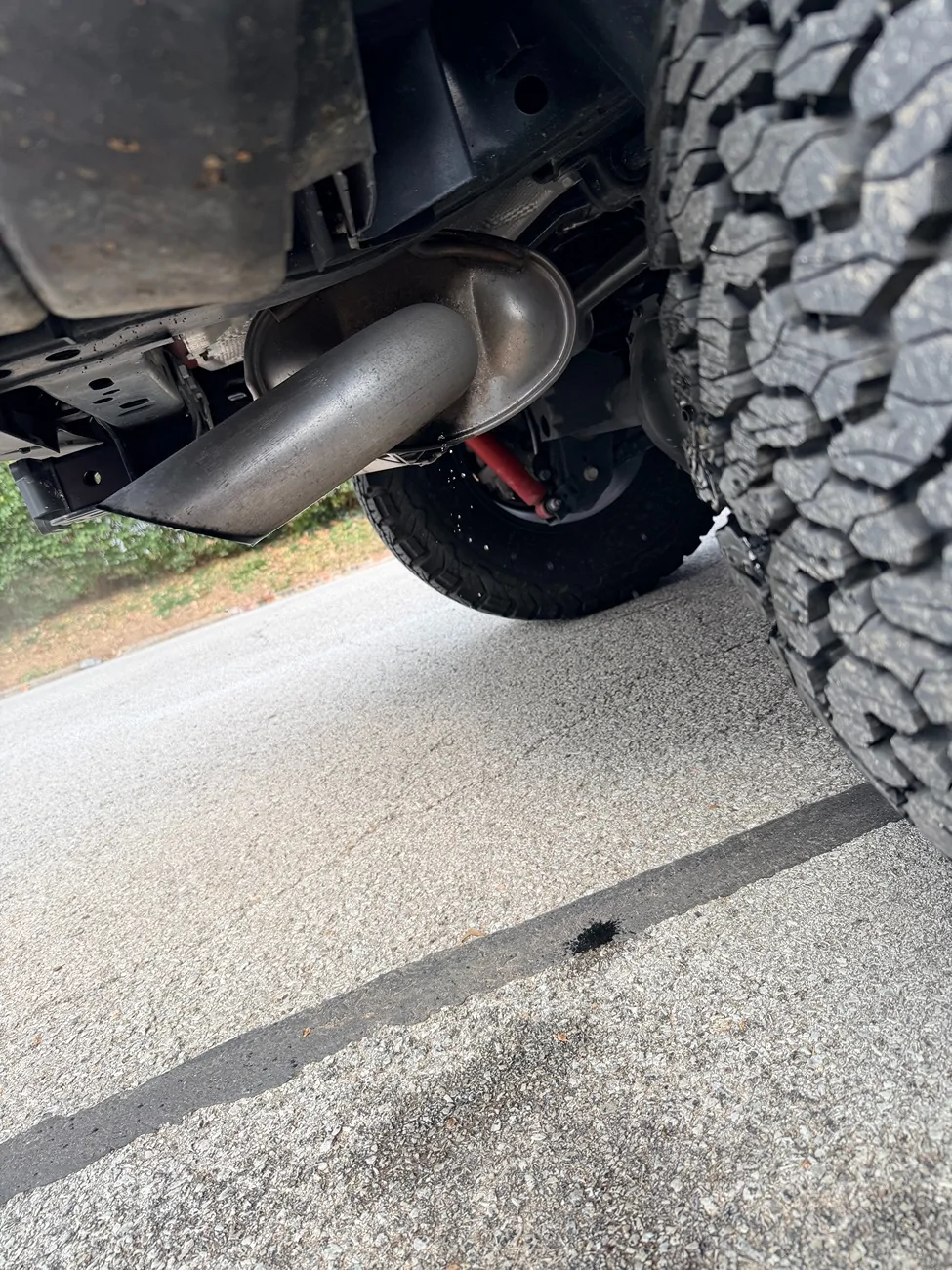

Hey Jeepers. I've often seen condensate come out the tail pipe, but I'm thinking this moister dripping out the side of the body of my muffler is not intentional. Has anyone else seen this? It's a 2024 Willly's with 8k miles. Thanks

That's completely normal.... by design ... as expected....
There is a hole in the muffler.. There is also a hole in the exhaust resonator.. both of which water/condensation will drip out of.
Hint: Routinely check to see if the weep holes in each are clear. IF not, use a probe to clean the hole out. Doing this routine check / weep hole maintenance can/will increase longevity of the muffler/resonator/piping..

Thanks a bunch! Talking about another man's "weep hole" sounds like a good way to start a fight lol

keeps them from rusting out....

thats a seeping hole for that exact reason
