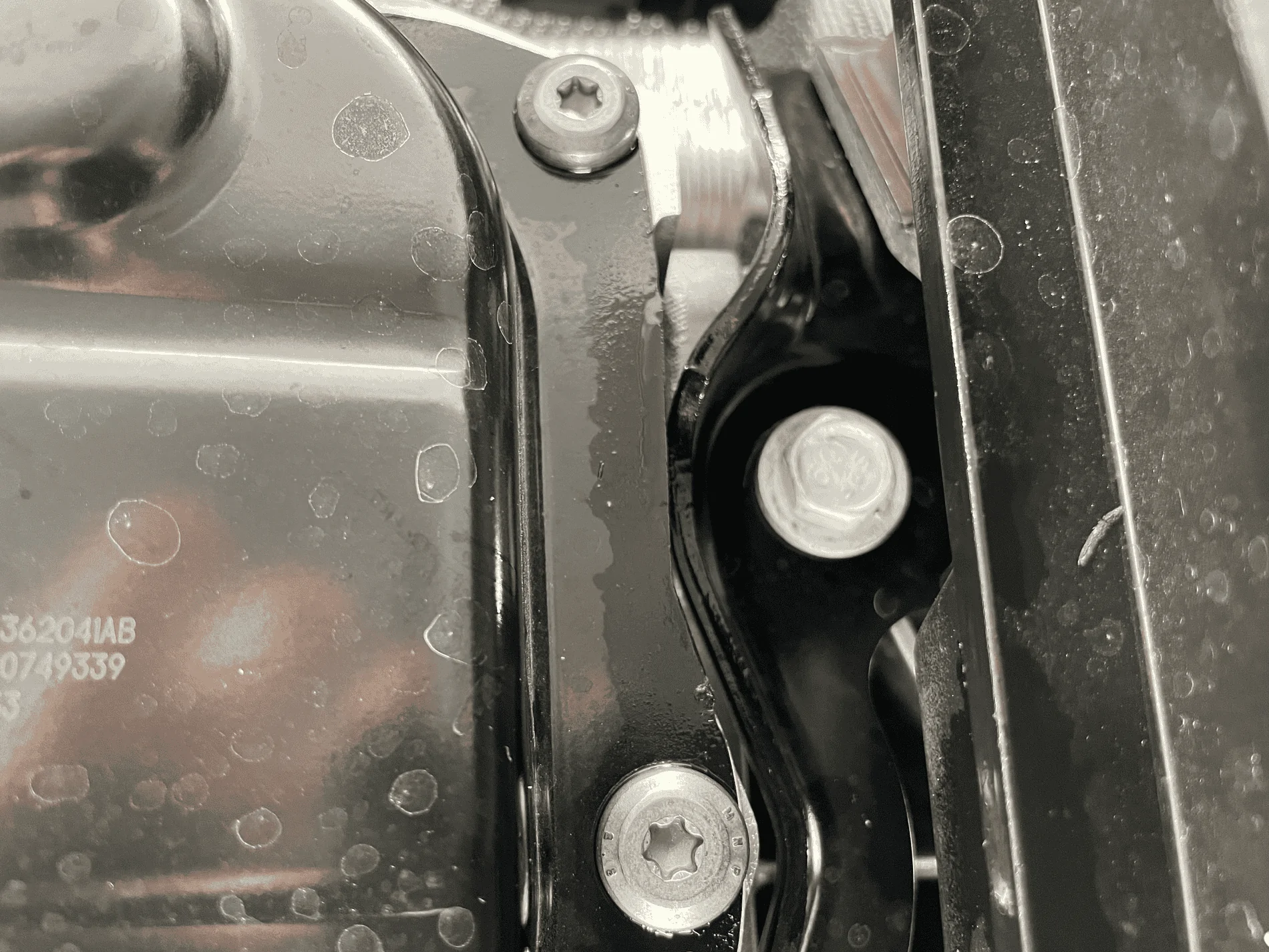

Well, ends up you're not the only one, I was under the Jeep the other day and saw some oily fluid in the same spot, same light green/yellow and lightly oily.
Before I take it in, was wondering what they did to yours. I'll take it in for a gasket, but I'd rather just torque down the trans pan myself if that's all it took.
Jeep Wrangler JL Leak pan2
Can you tell me what you found?

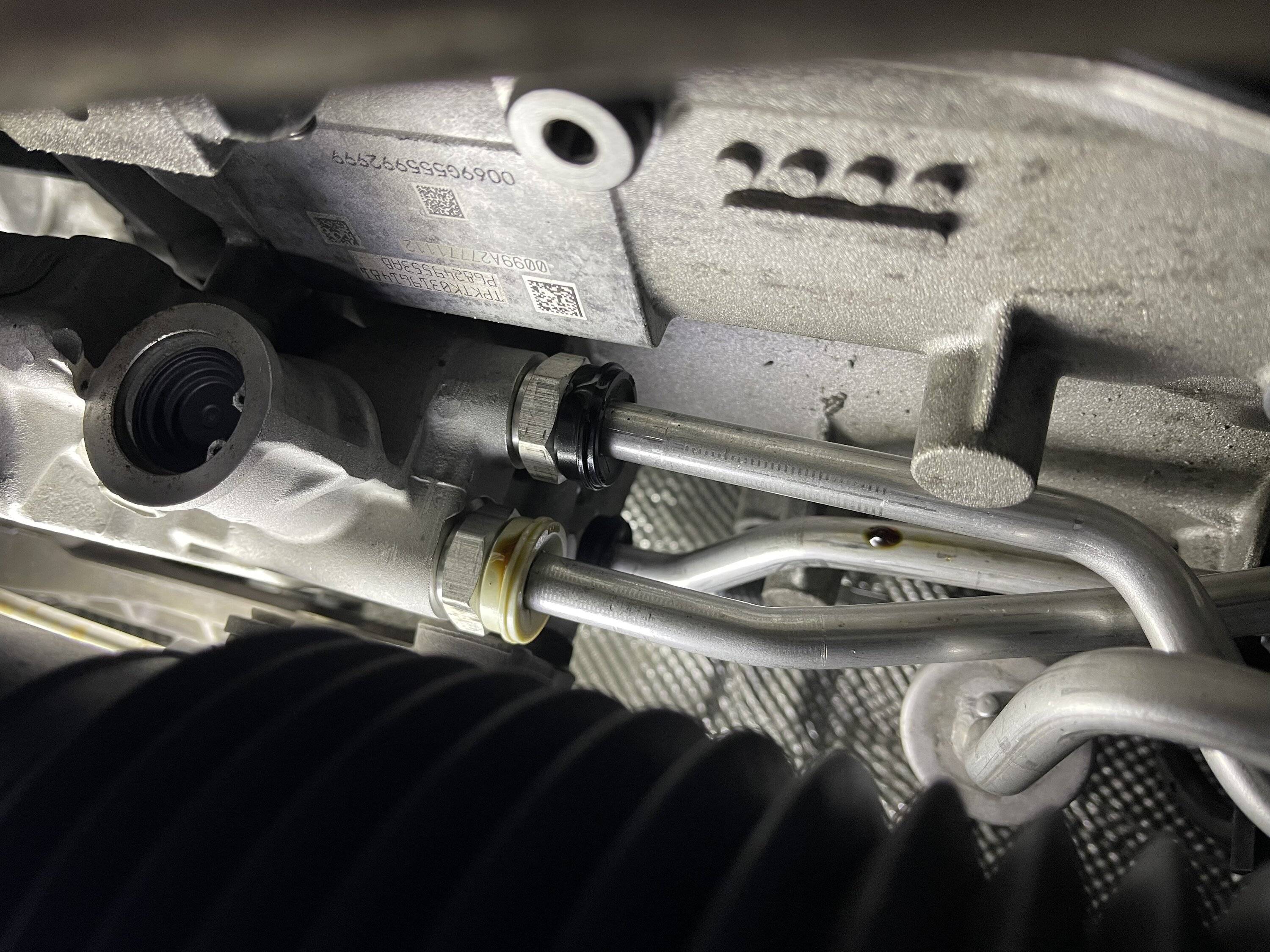

Had a similar leak on my 2019 Jeep Jl rubicon. Shop sent me pictures indicating a leak at the transmission cooling lines. Just above the pan. Hope this doesn’t cost me an arm and a leg.
Looks like the connector itself is leaking. Should be easily replaced.
update… took it to the dealer and it turned out to be the oil filter housing leaking on top of the engine and transmission. Seems to be a common problem. Fixed under warranty which was nice.
