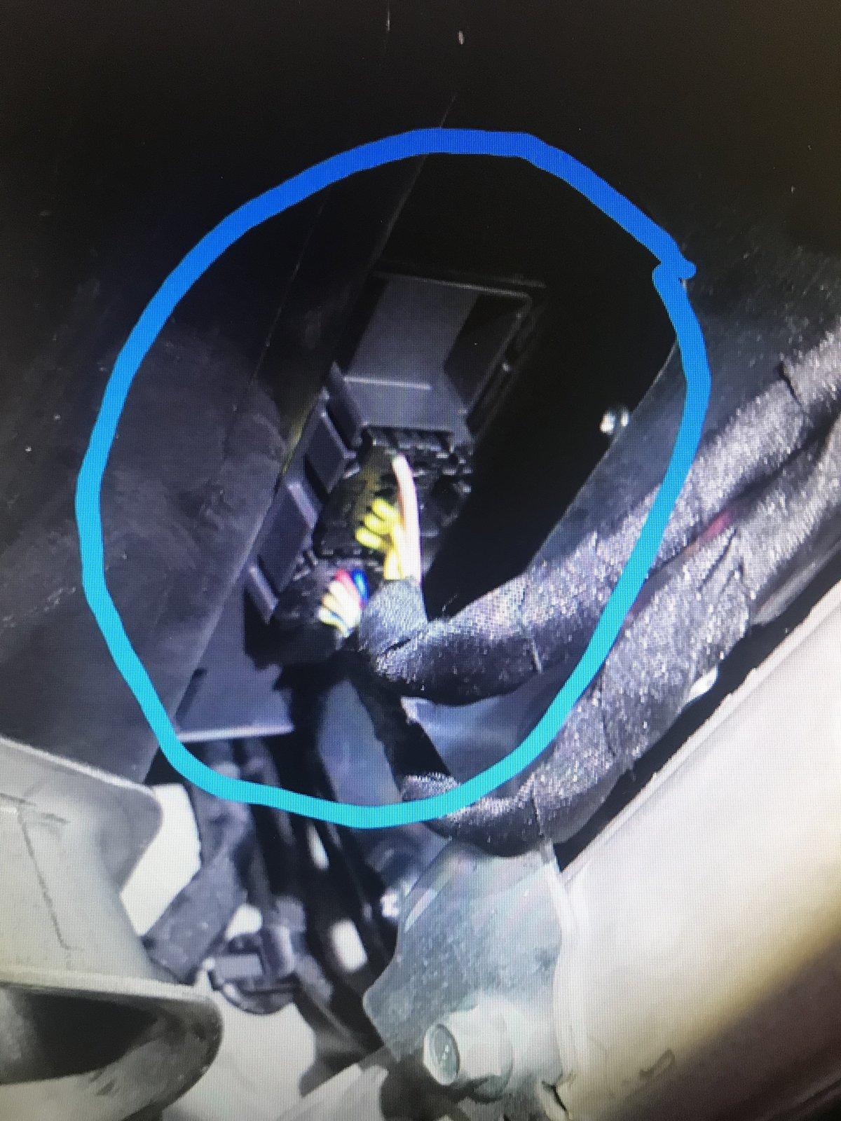

Forensic Engineer
The dealer had my jeep in for over two weeks trying to find this issue. They located the vibration to the gateway module underneath the steering column area near that lower speaker. I’ve attached a photo below. They fixed it by putting a couple dollops of epoxy in it.
Can you post a picture with more around it so it's easier to see where that actually is? This sound is driving me nuts!!!!!!!
