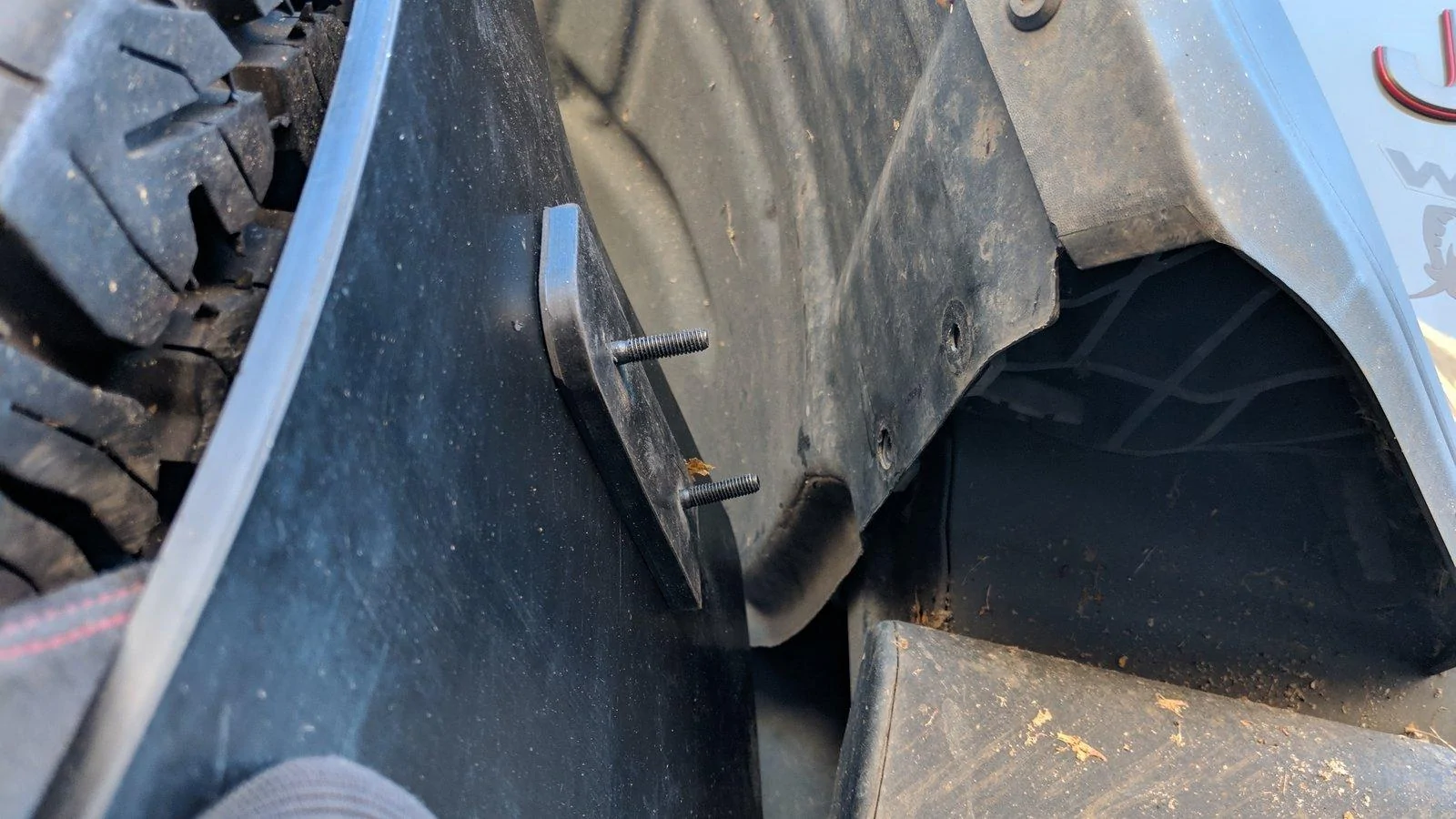

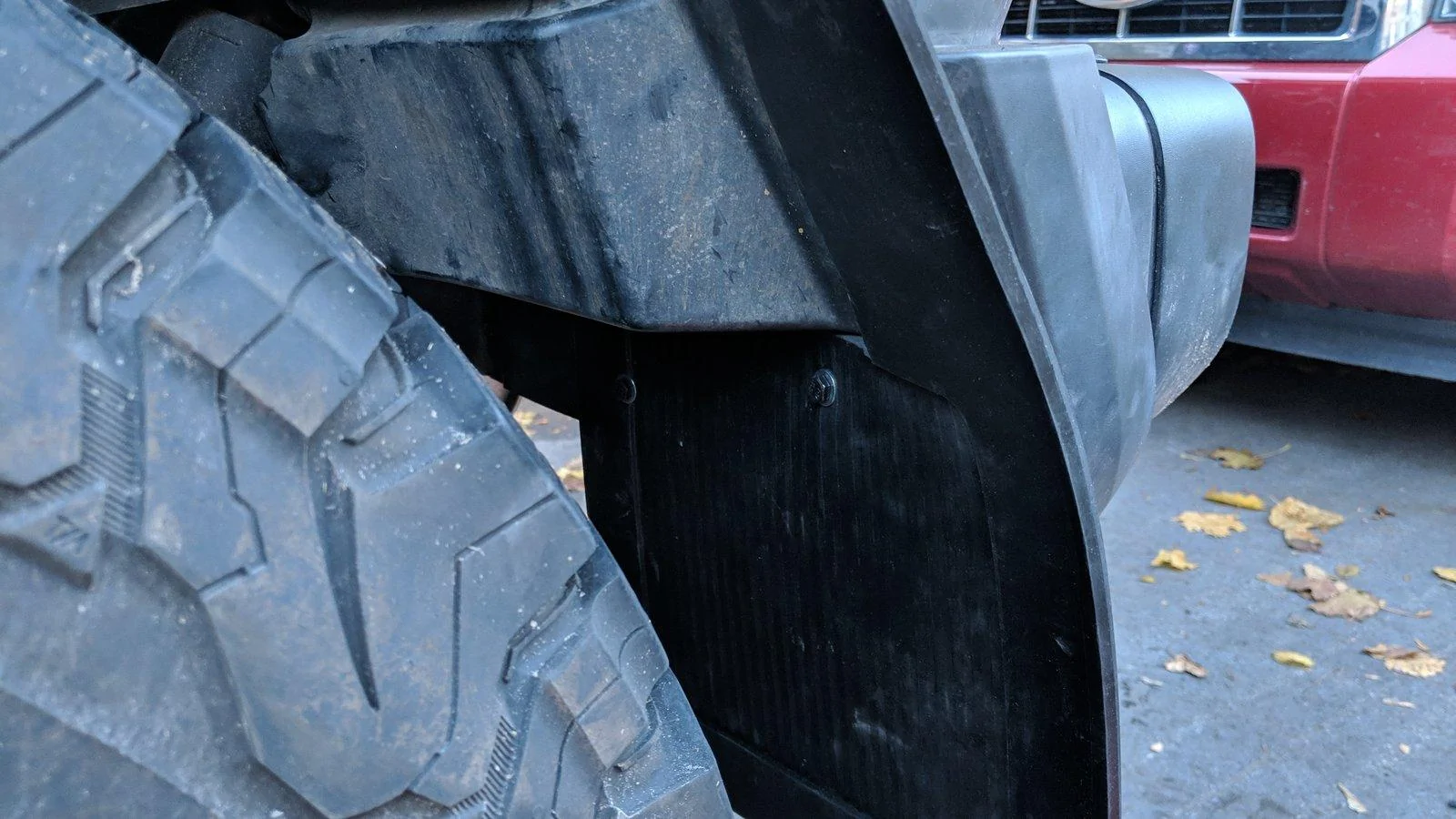

Very cool. This is exactly what I want to do. Not sure I want to add more white Jeep logos though... Thanks for the photos!I've ordered and installed these (https://www.extremeterrain.com/jeep-logo-mud-guards-1119-j102026.html). They also have a shorter (9X15) version available.

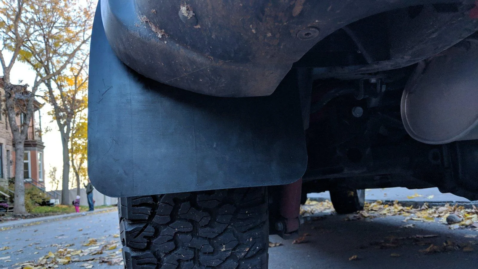

Front:
I used the existing rivet holes. Because the upper two holes are not on the same plane as the lower two, the flat rubber mudflaps are bent and plastic rivets won't hold them in place. So I use used stainless 1/4" machine screws, nuts, flat washers and spring washers to hold the bottom 3 holes. I was able to still use the plastic rivets on the top holes

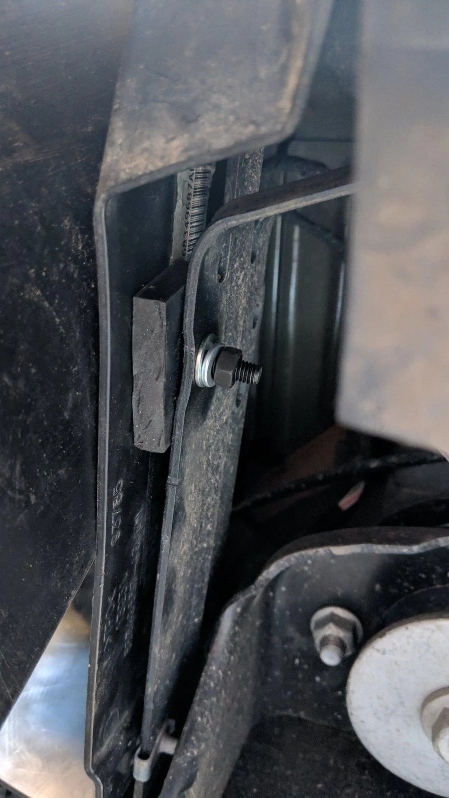

Rear:
The rear mudflaps required considerable trimming to fit. I mounted the rear using only two bolts (the top portion stay ed against the rear fender so I see no need for additional faster, for now). The outer hole (right on the photo) is the existing rivet hole. The inner hole (left on the photo) is from the steel bracket I located behind the inner fender. I used an auger to pierce a hole from inside This portion of the inner rear fenders can be easily removed (by removing two sheet metal screws) to drill the 1/4" holes.
