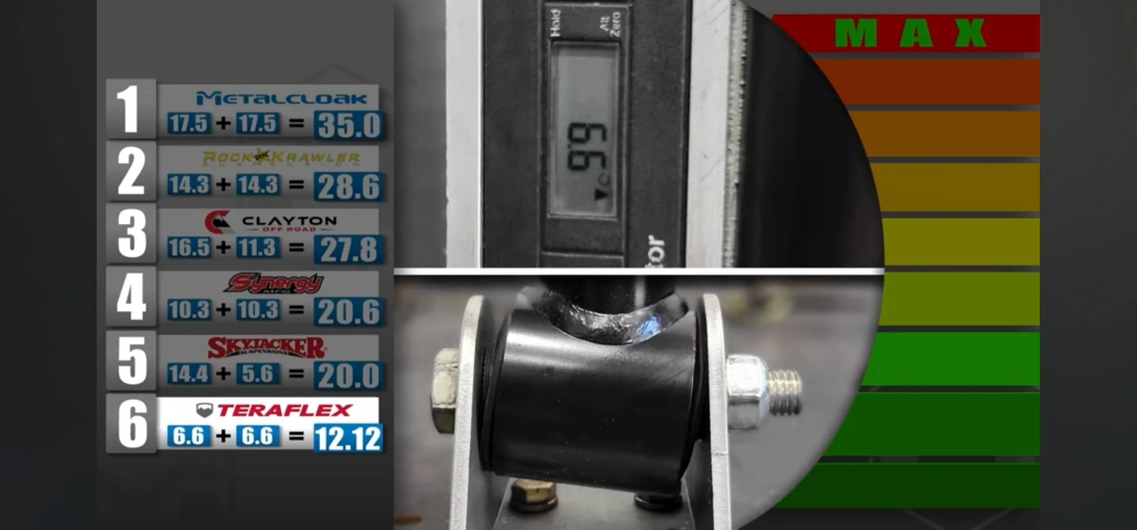

This video from Rock Krawler compares quite a few different joints. It's fairly straightforward in it's testing. An angle measurement to show the amount of misalignment, and a strain guage showing how much pressure needs to be applied to get it done.
A video from Metalcloak showing their measurements, but unfortunately it doesn't show how they measured it.
In the end you will likely be very happy with any of the options using a high flex rubber bushing system.
[/QUOTE]
Thank you for sharing the vid.
The snippets in that commercial are from these videos that provide more details...
Jeep Wrangler JL Most articulation stock geometry Screenshot_20240304_194217_YouTu
It's always good to judge from both sides of the topic. Glad you provided the video I missed when checking out the channel.
Back to the OP as always use your best judgement and determine what suits you best. And remember that numbers are usually going to be skewed to some degree by the person who is conveying those numbers. Both of these manufacturers showed results that have their own product being empirically superior to the other ones available. I like both. I think that either one of them would probably suit what you want.

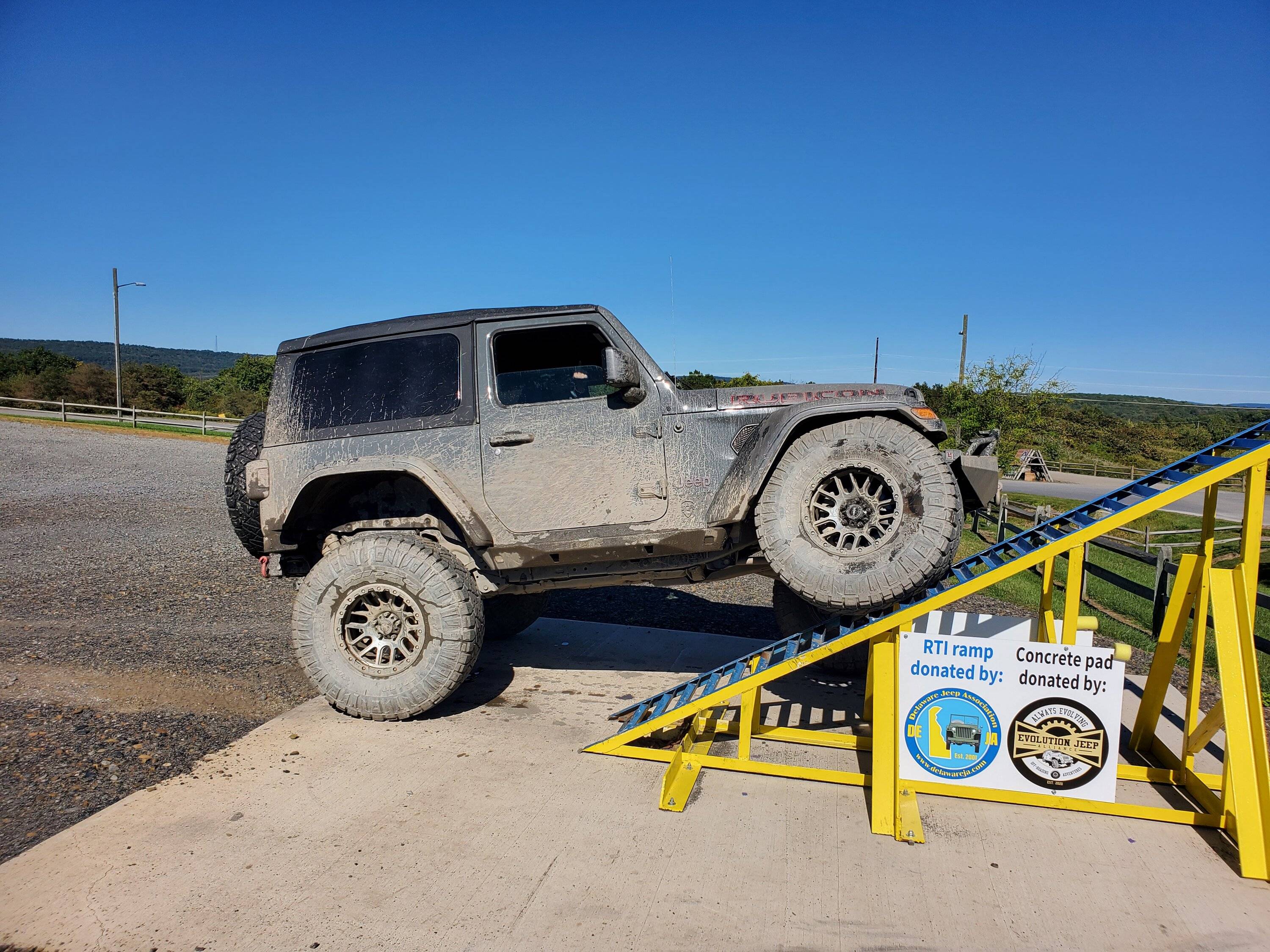

everything will need to be replace to go from 2.5" to 3.5" except maybe the shocks if you got them in a 2-4" lift range and at 3.5" don't forget about driveshafts.
3.5" lift and 38x12.50's for reference, could have gone higher on the RTI but my GF said if a tire came off the ground while I spotted her up she would bail.

and full tire pressure
