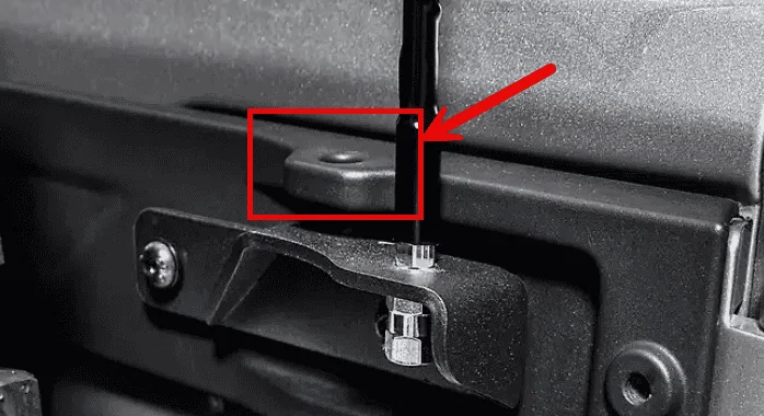

This pic shows the tailgate mounting point (this is a screen grab from an antenna mount that bolts to the tailgate reinforcement. Clearly whoever makes this product doesn't like that mounting solution. The product link is here: Rugged Ridge CB Antenna Mount.
Jeep Wrangler JL Mopar Tailgate Reinforcement Antenna Mount 1705516816319

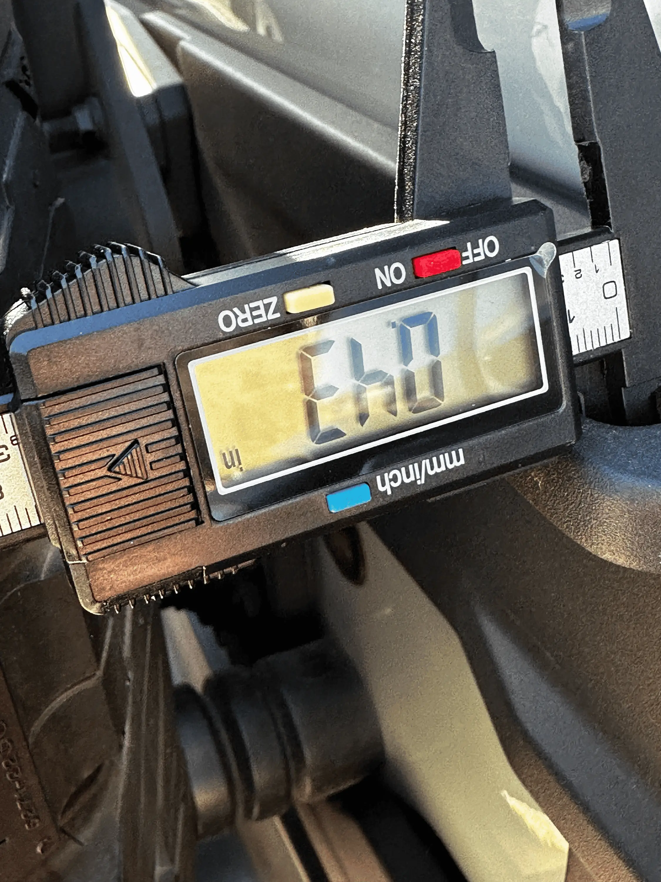

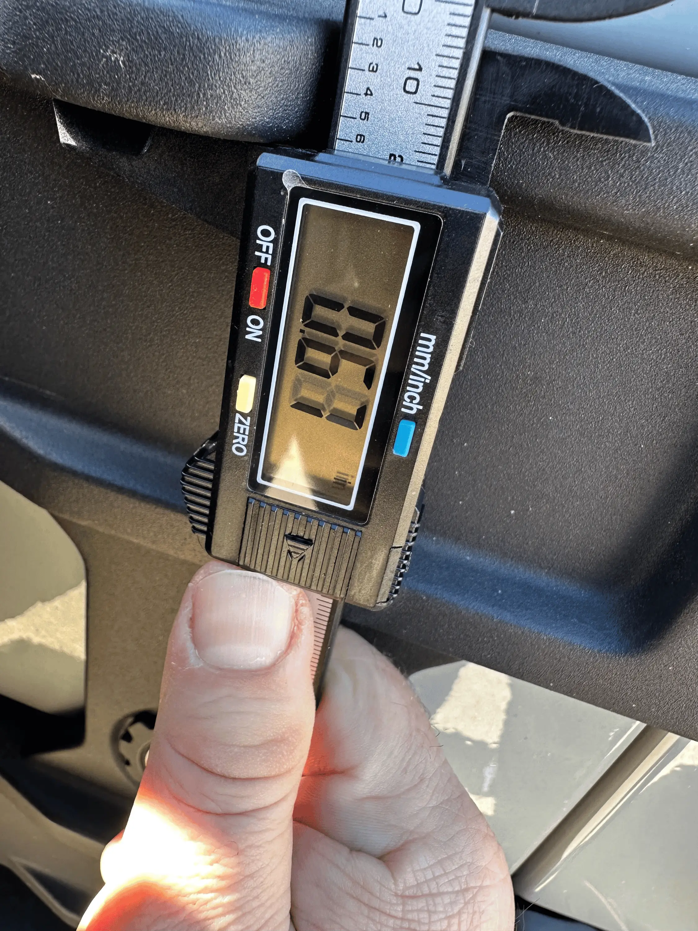

Here are my measurements of thickness and hold diameter.
Hole diameter: 0.43"
Mounting Plate Thickness: 0.67"

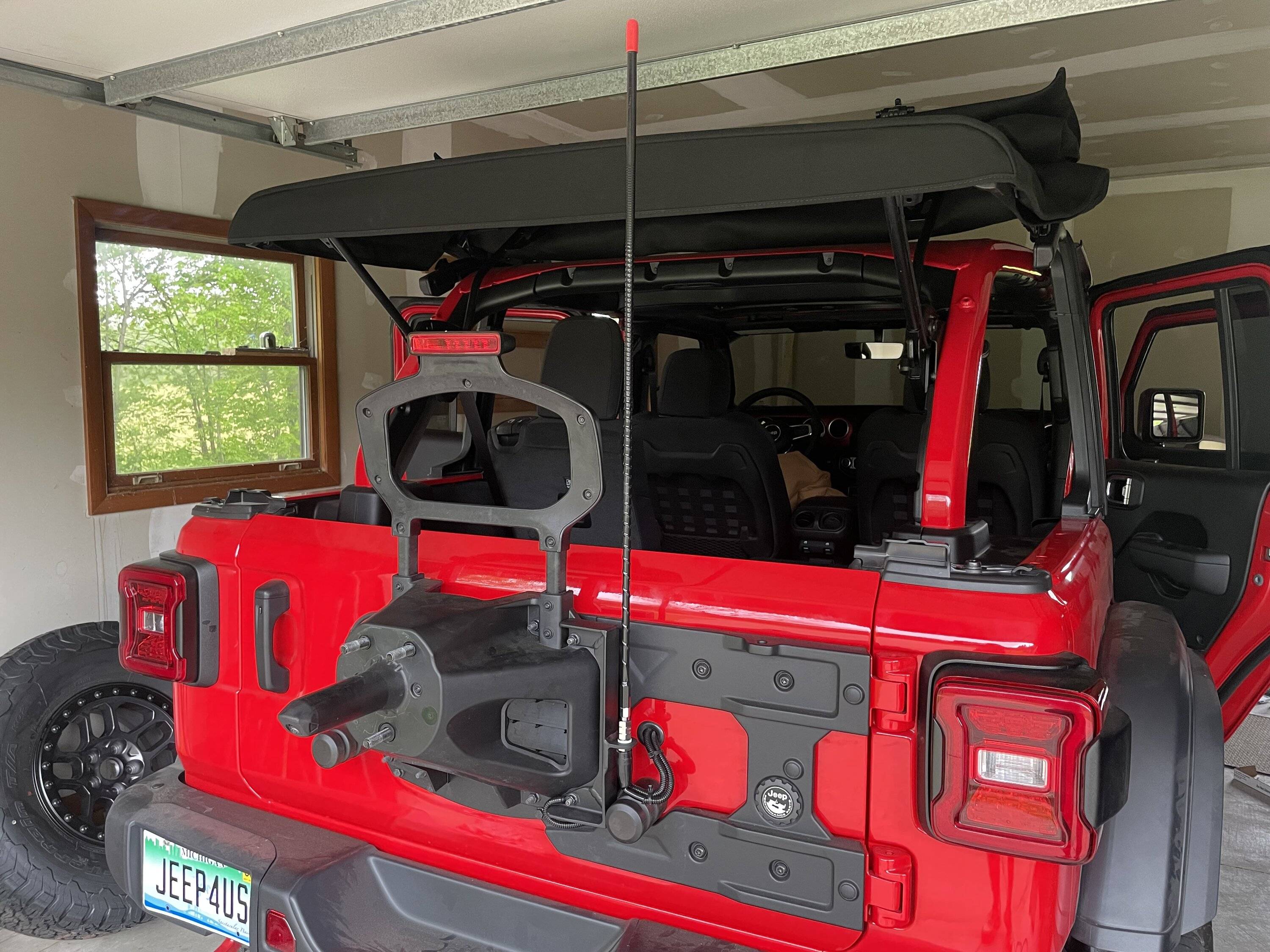

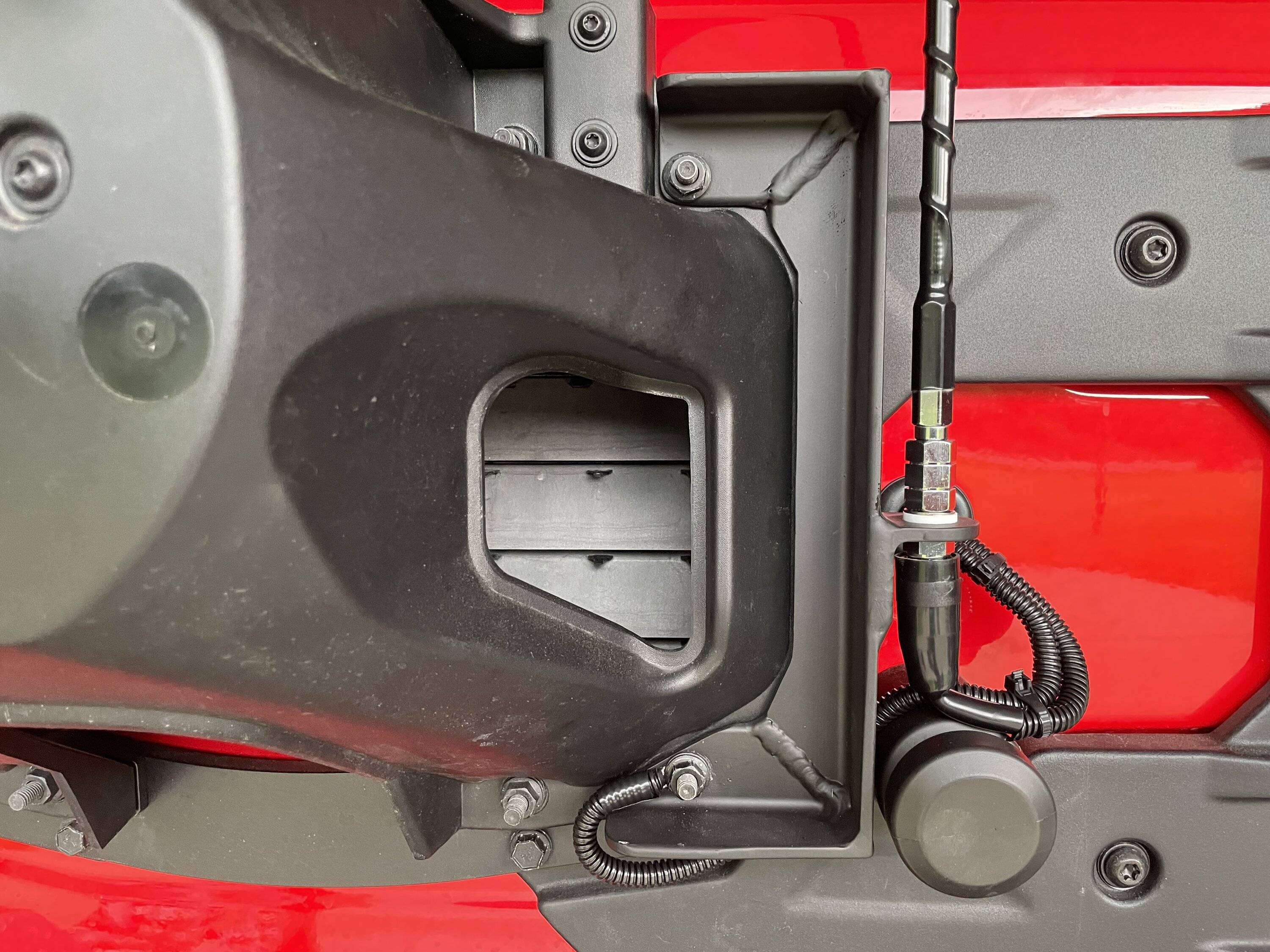

I struggled finding an antenna mount also that would work on the XR reinforced tailgate. I use a 3 foot fiberglass antenna and I don’t want it tangled in stuff on the trail either. I wanted to get it in the garage without taking the antenna off. Solution, build your own. I made several cardboard templates, then cut one out and taped it together. Finally took my cut pieces to the welding shop, painted it and installed it. I’ve got it set with about an inch and a half of clearance to get it in the garage.

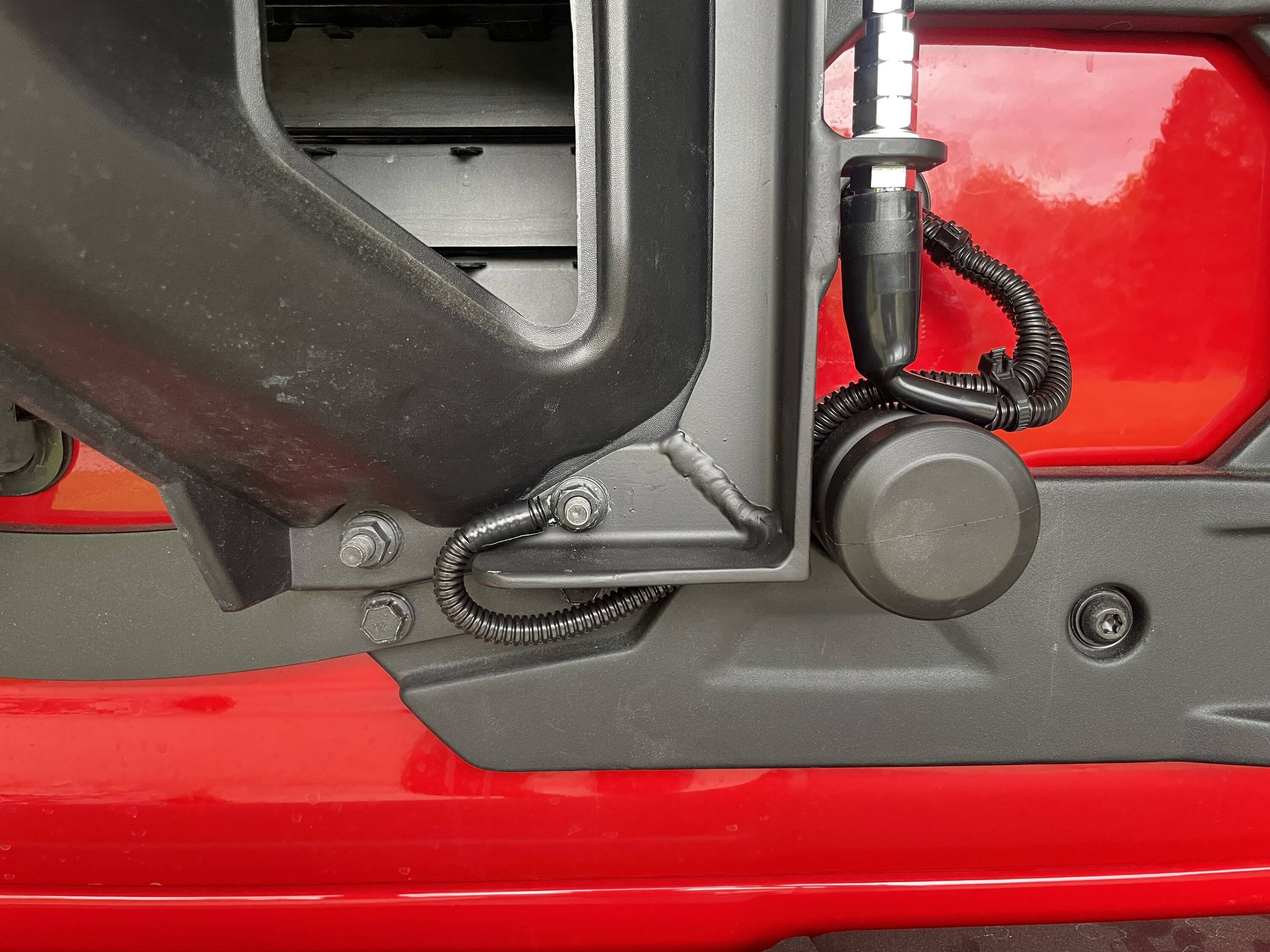

I bought this one for the Mopar Reinforced Tailgate. Fits into the antenna hole nicely and includes NMO mount.
https://www.amazon.com/gp/product/B007JR3UOK/ref=ppx_yo_dt_b_search_asin_title?ie=UTF8&psc=1
I picked up this NMO cover too, just to have on hand if I wanted to take the antenna off or what not for more than a little while.
https://www.amazon.com/gp/product/B004Z941MU/ref=ppx_yo_dt_b_search_asin_title?ie=UTF8&psc=1
Thank you! That is exactly what I was looking for!

Sorry, I just saw this today. Not sure why or how I missed a notification when you first posted this. That is indeed the one I bought and fits mine (Mopar reinforced carrier) just fine. 3/8" is smaller than the 1/2" hole that Mopar claims to be. The Mopar factory hole isn't really 1/2" at least on mine and others I have seen. Some people drill it out to make it actually 1/2" diameter. Others I have seen shave the top or bottom to make it flat but that is up to you.
When I put it all back together, I will try to remember to take pictures again. Currently the rear end is taken apart (and has been for a while) while I run wiring and replace the rear bumper and a few other things. That I have just not had time to do as other things have come up. So, hopefully here next week or so I can get most of it done.

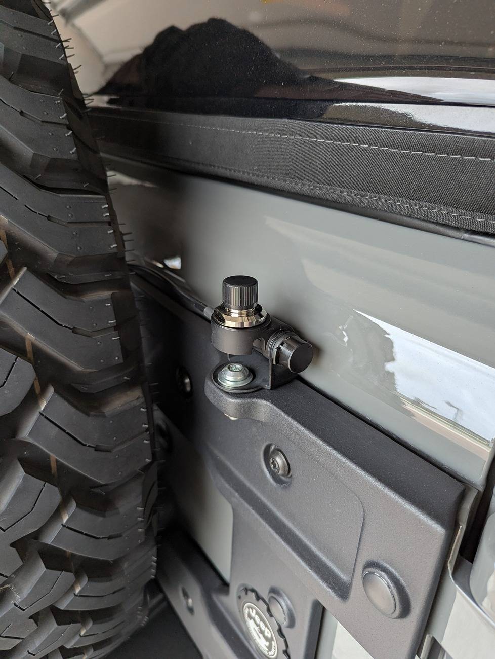

I have a UHF base and thought about just drilling out the hole. I was afraid that would not leave enough surrounding metal. Modified a Diamond K400 mount and it worked out great.
