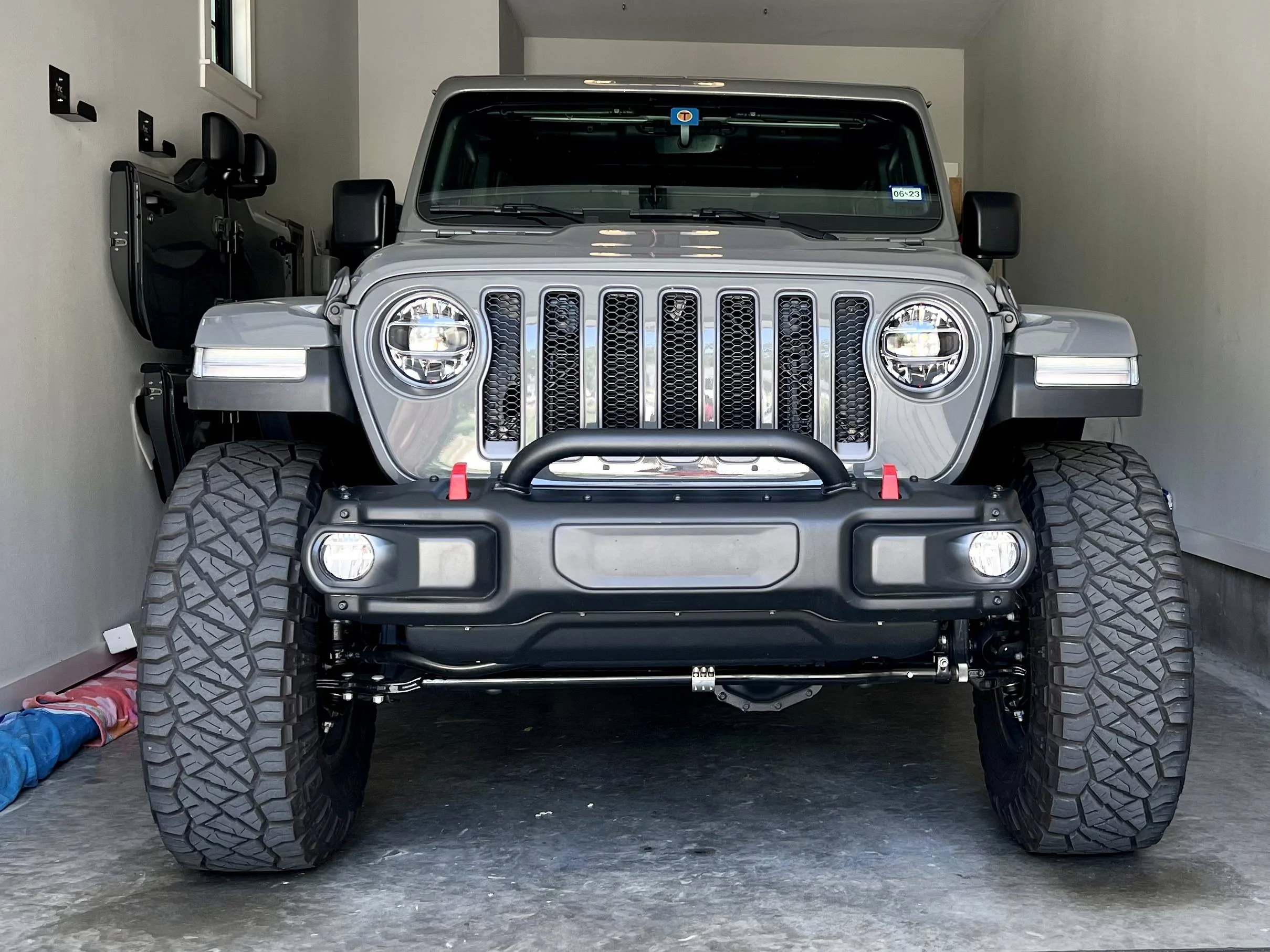

I realize this post is a bit older, but I am hoping to clear up a bit of confusion on my end:
I have a 2022 Wrangler Rubicon that did not come with the LED package. I ordered some LEDs direct from Mopar (I couldn’t find a set to order so I ordered LH and RH individually but they didnt come with any additional wiring). Anyway, If I am reading HH’s reponses correctly I can just plug in the two Mopar OEM LED headlights and once I flash it everything should work correctly? I installed them last night but still waiting to get a Tazer or go to my local dealer. The low beams seem to work fine and the high beams look a little weird and the HALOs dont work at all. Will that all work once I get it “flashed” or do I need additional wiring?

Base on the official Mopar Kit data you are also going to need part # 68347117AB jumper wiring. This harness is on backorder with no solid ETA at this time.

Shouldn’t need jumper on 22 since fourth wire is present from factory.

Switched mine over, no additional wiring required. Had Tazer mini and everything worked great. I also swapped in flare DRL’s and LED tails at same time.

You should be good to go. What you’re describing; normal low beams but not so normal high beams, no halos - is exactly what I encountered before the flash. Flash should fix everything.
