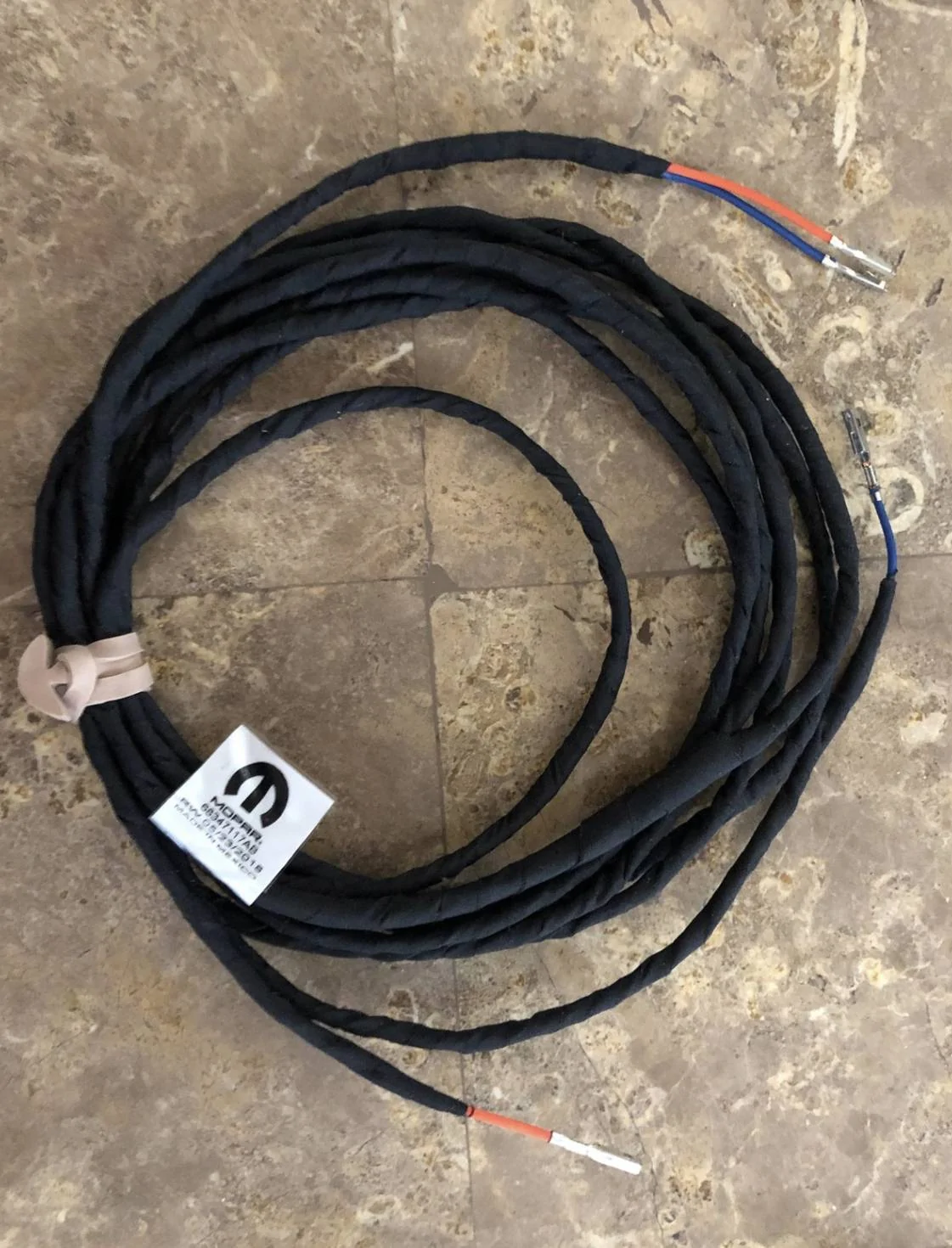

68347117AB

Oh, you are wonderful. About to order it. Next question will be the inevitable “there was a thread that gave directions on how to wire it to the BCM through the firewall…”

So if i install this part 68347117AB:
https://www.getoemparts.com/oem-parts/mopar-wiring-68347117ab?c=az0y
with the instructions, do i need anything else? I read somewhere this part was need it also:
https://store.mopar.com/oem-parts/mopar-headlamp-wiring-68414409ab
It´s that true?

That second harness was utilized by someone that had 4th wire on drivers side but not passenger. The 68347117ab should be all the wiring you need. You will need to have Jeep flashed to allow LED and halo unless you have a programmer (JSCAN, Taser Mini, etc) to do yourself.

Thanks, i do have the scan but i found i only have the 3 wires and not 4, so i should but two of the second ones right?

The 117 harness has 2 wires at BCM and the other end splits 1 for driver side and 1 for passenger that you will insert into plugs at each light per instructions.
Thanks a lot brother, do you know if there is a video or any instructions on how to do it step by step?
