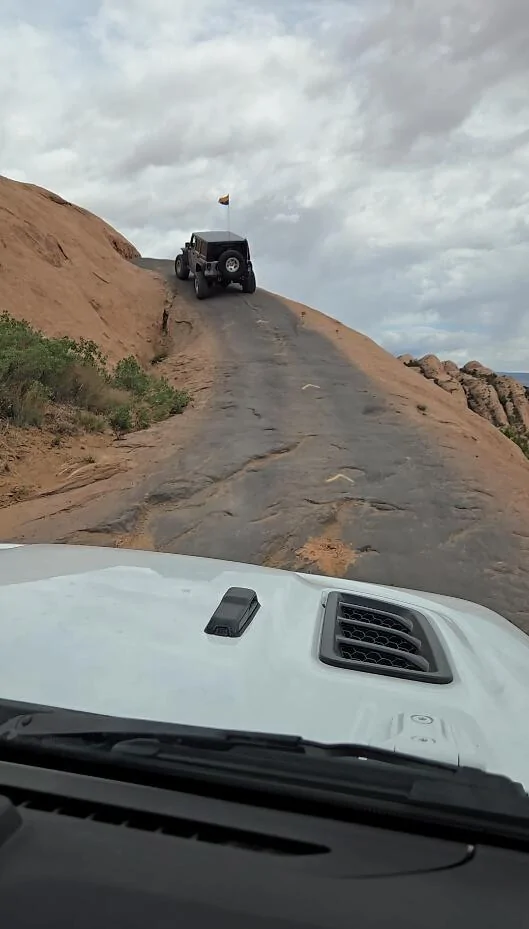

We have a 2024 Rubicon X. We run in 4 low all the way changing the speed with the + - shifter as we go. I try not to use the break too much on the descent as to avoid slipping and ending up in the area spotted in yellow below.

is the yellow dot an aimpoint, goal, challenge?

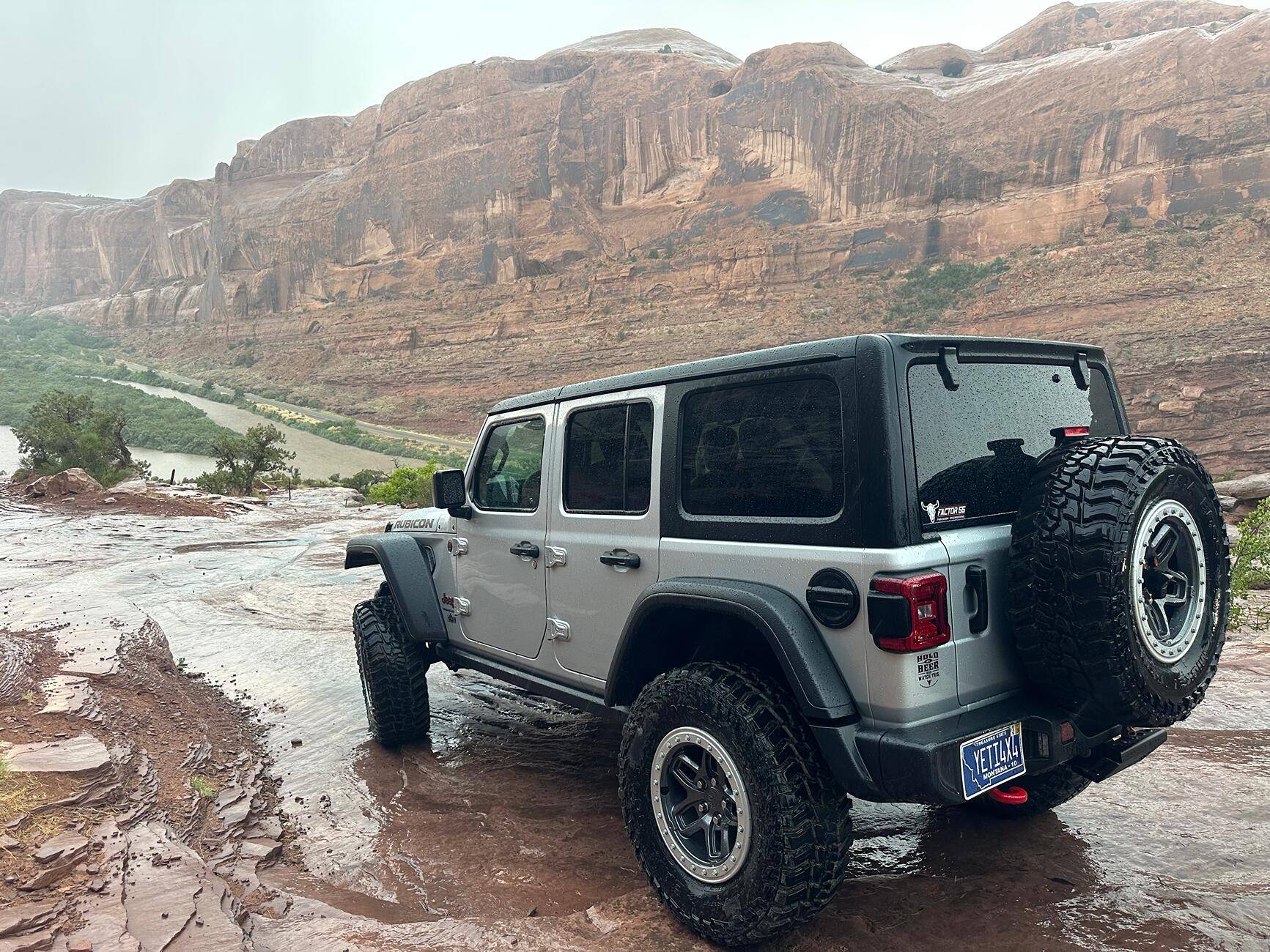

to more answer your questions when we do slick rock and even non slick rock we pretty much just leave it in 4lo unless on sand road then 4h or 2w depending...if you need front lockers it is because either wet or loose and turning sharp will not be an issue..even with as much rain as we had a couple weeks ago we had no issues..wet slick rock still sticks pretty good...the sand washes on Fins and things had big puddles and Moab rim was a bit scary coming down in the rain but no slips..

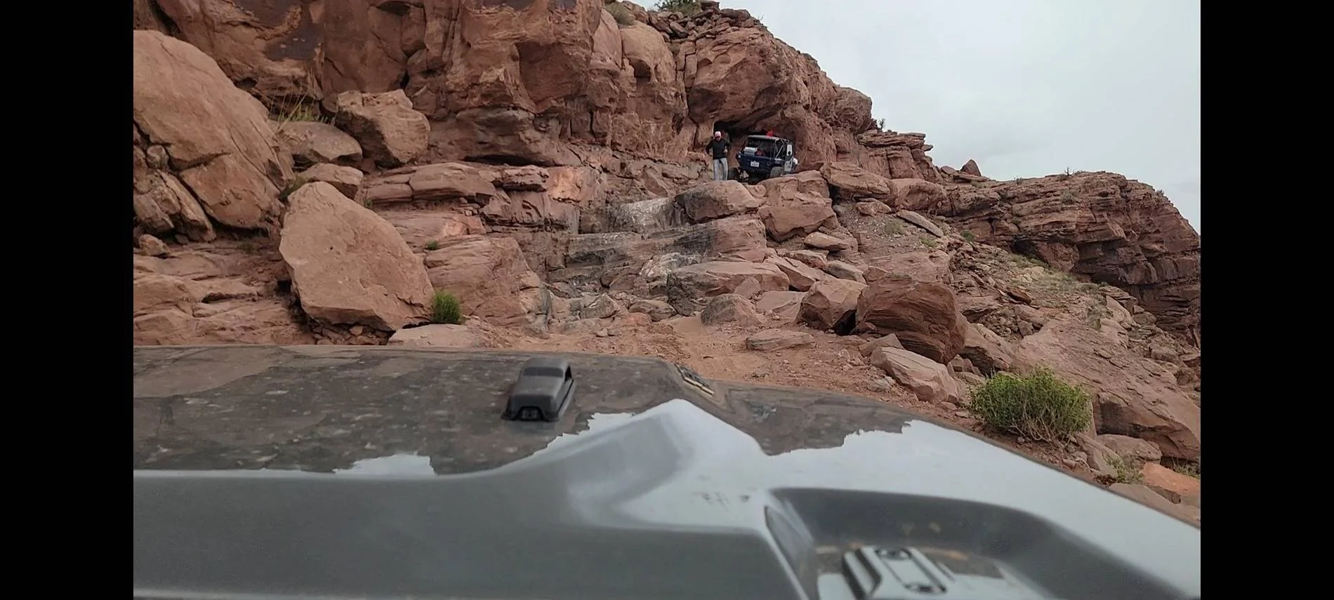

I was more concerned about ending up down here ..

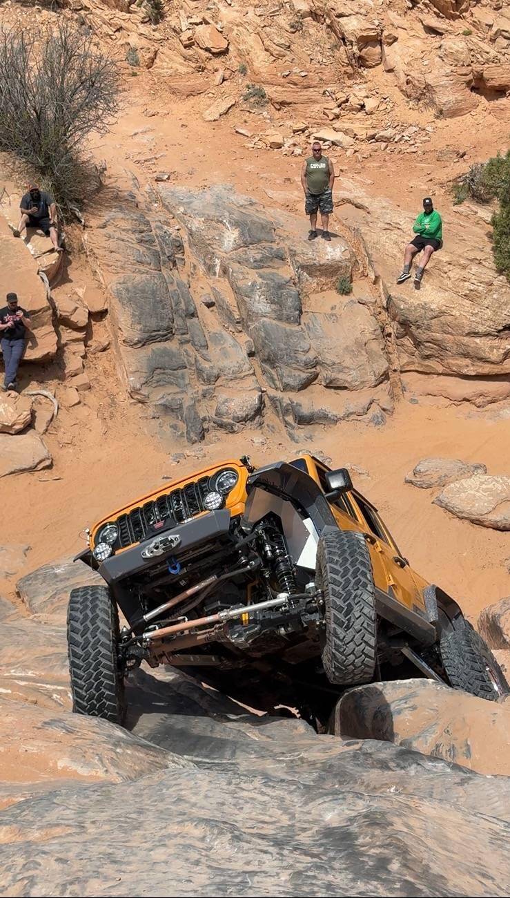

Locker needed:
Jeep Wrangler JL Moab slick rock 4wd, locker, etc. advice 1751056766652-o5
Jeep Wrangler JL Moab slick rock 4wd, locker, etc. advice 1751056908062-1k
Jeep Wrangler JL Moab slick rock 4wd, locker, etc. advice 1751057010268-r
