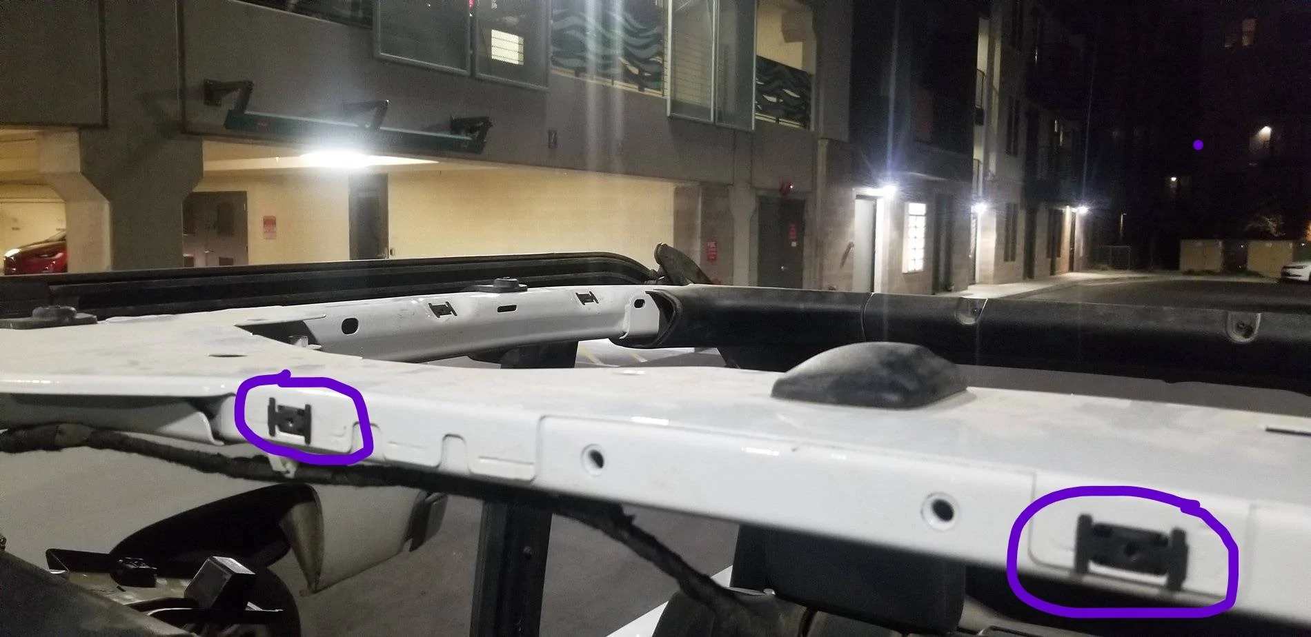

Please send the info. I found the screws and they were cheap but could never find the spring nuts. Actually I found the smaller version that is used on some of the other trim but the spring nuts missing on my soundbar trim are much larger.

Here is a pic of what I need. Not my jeep stole it from another poster

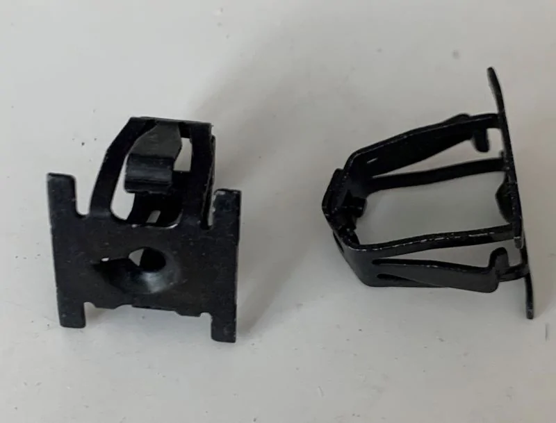

This what they look like. A little shorter, but still fit fine on my roll bars, especially when expanded.

Good news. Strange it was never listed in the JL parts. As I mentioned, the one I found for the visor worked in the roll bar, but I would much rather have the exact one.
Thanks,
Johnny
