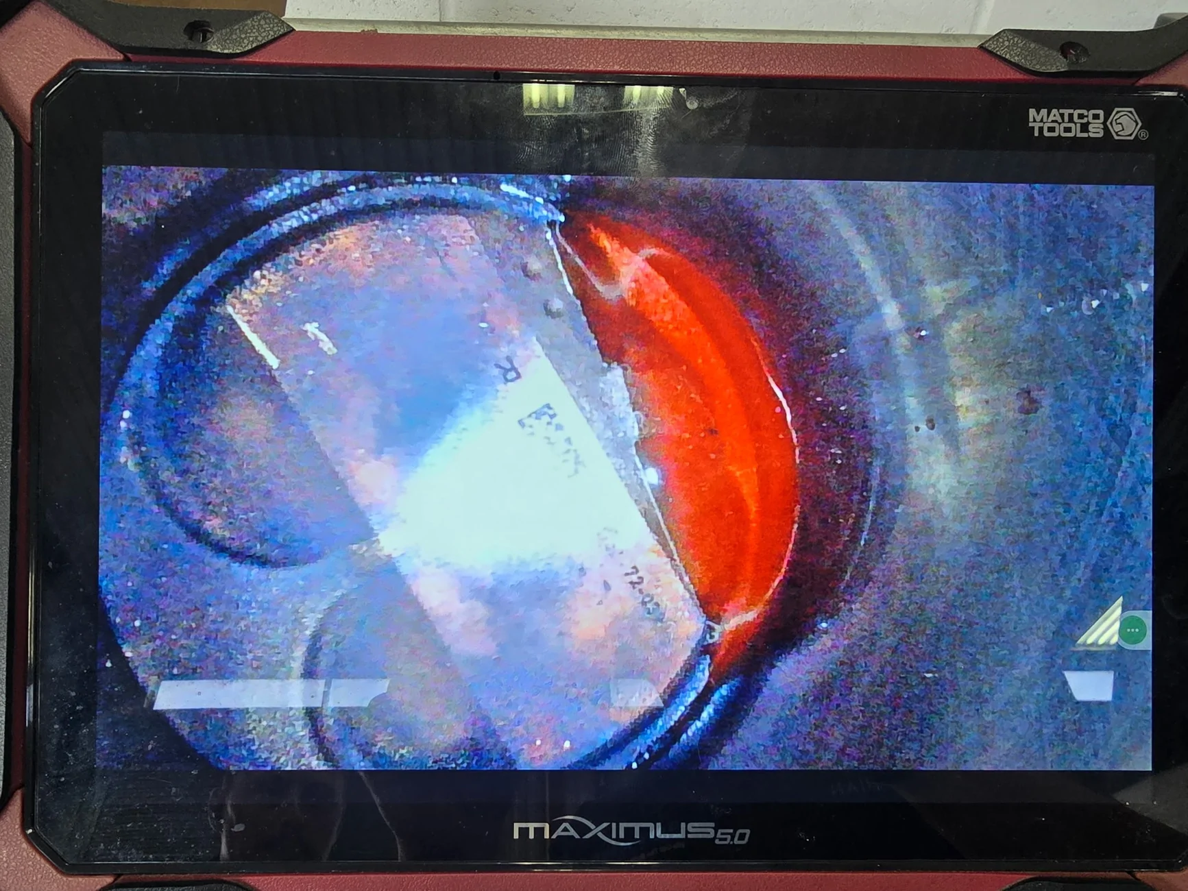

Update - no one will ever believe this, but another 3.6 with rocker failure that ate the intake cam on the passenger side, specifically cylinder 5 and starting on 3.
What?
That’s exactly what I was going to say. Pull valve cover, inspect cams. There’s nothing surprising at all about this.
Fuel pump is an absolute no.

$100 says it's the center high lift lobe that I've been talking about endlessly ;)
If it is, it is more confirmation that a Baxter oil filter housing to keep oil up top on cold start (high lift lobe is used on cold start until oil pressure is at the lifters) paired with tuning the High Lift system out will help these camshafts live longer.
