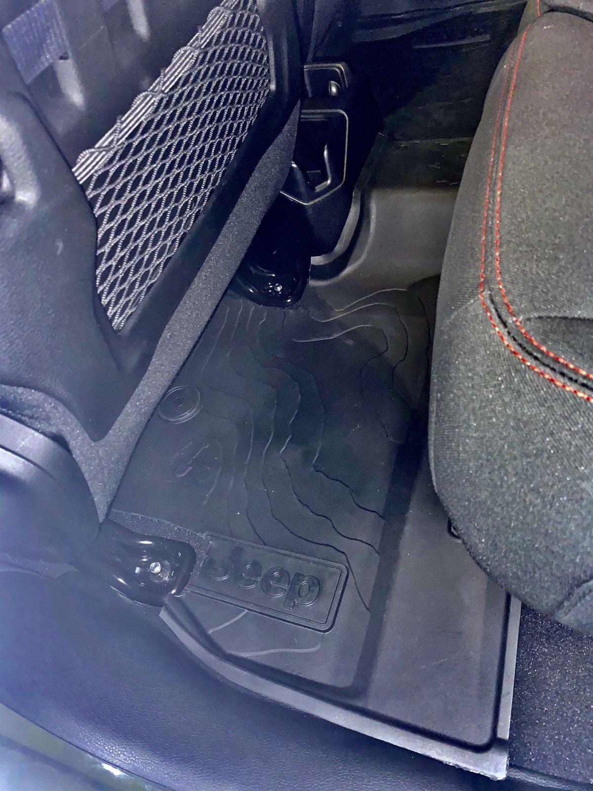

I trimmed the Jeep rubber floor mats to fit in rear. No cuts needed in front. I also notched the side trim panel in rear so seat bracket didn’t rest on top of the wall trim.

Did you have to notch the wall trim to get the seat bracket from resting on top? When I initially installed it, I just left it on top of the trim but it was causing the trim to pop loose.... so I notched a section out for the seat bracket to go into vs sit on top of.

i'm not sure what wall trim is however, my installation did not require and cutting. drilling or grinding. Simple bolt in installation that took less then 10 minutes. The only issue that I have is that the OEM rear floor mats do not lay flat because of the new brackets.
