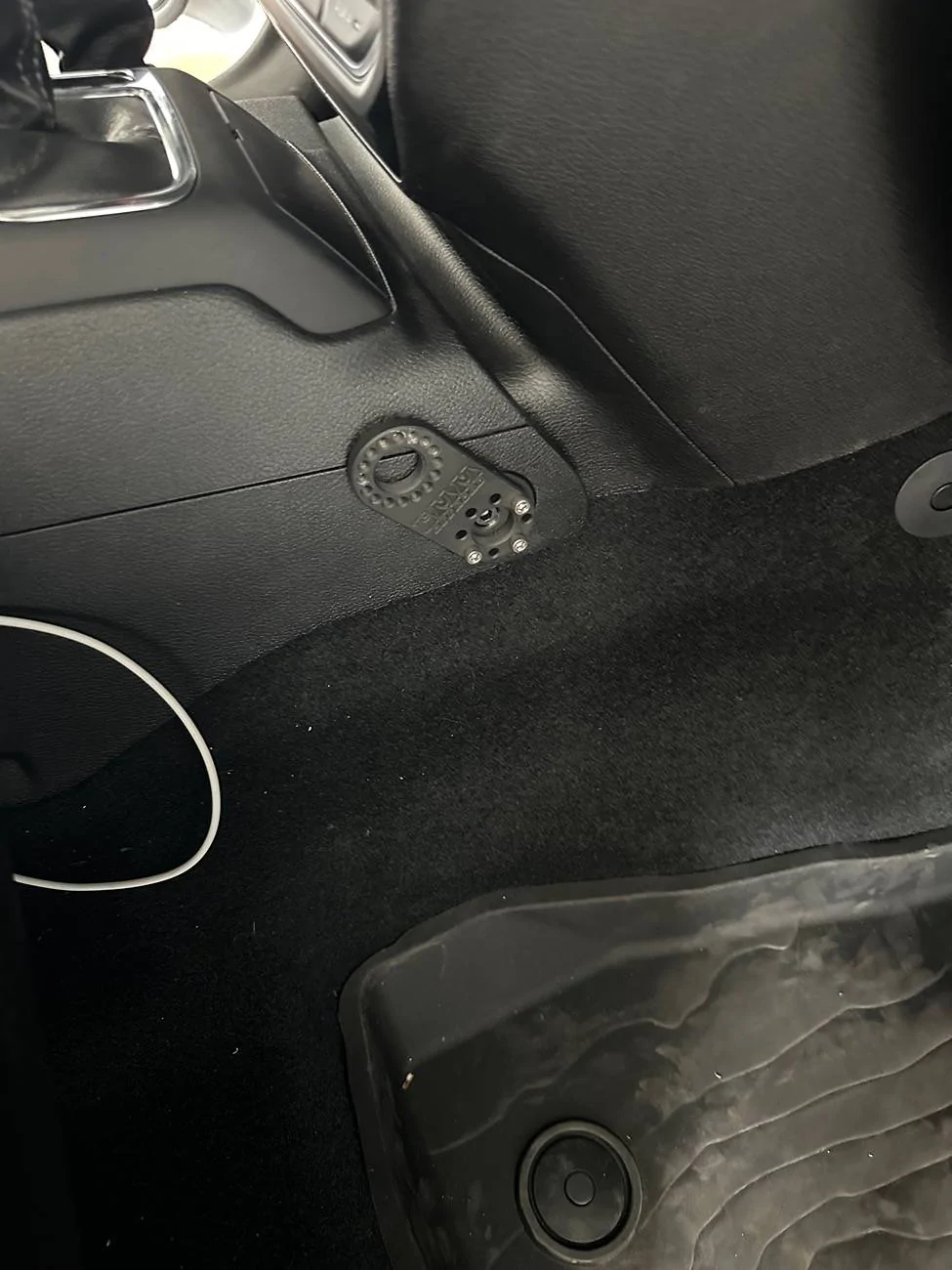

I have a mxt105 and cmm mount and only leave it in when actually jeeping with others that have radios.

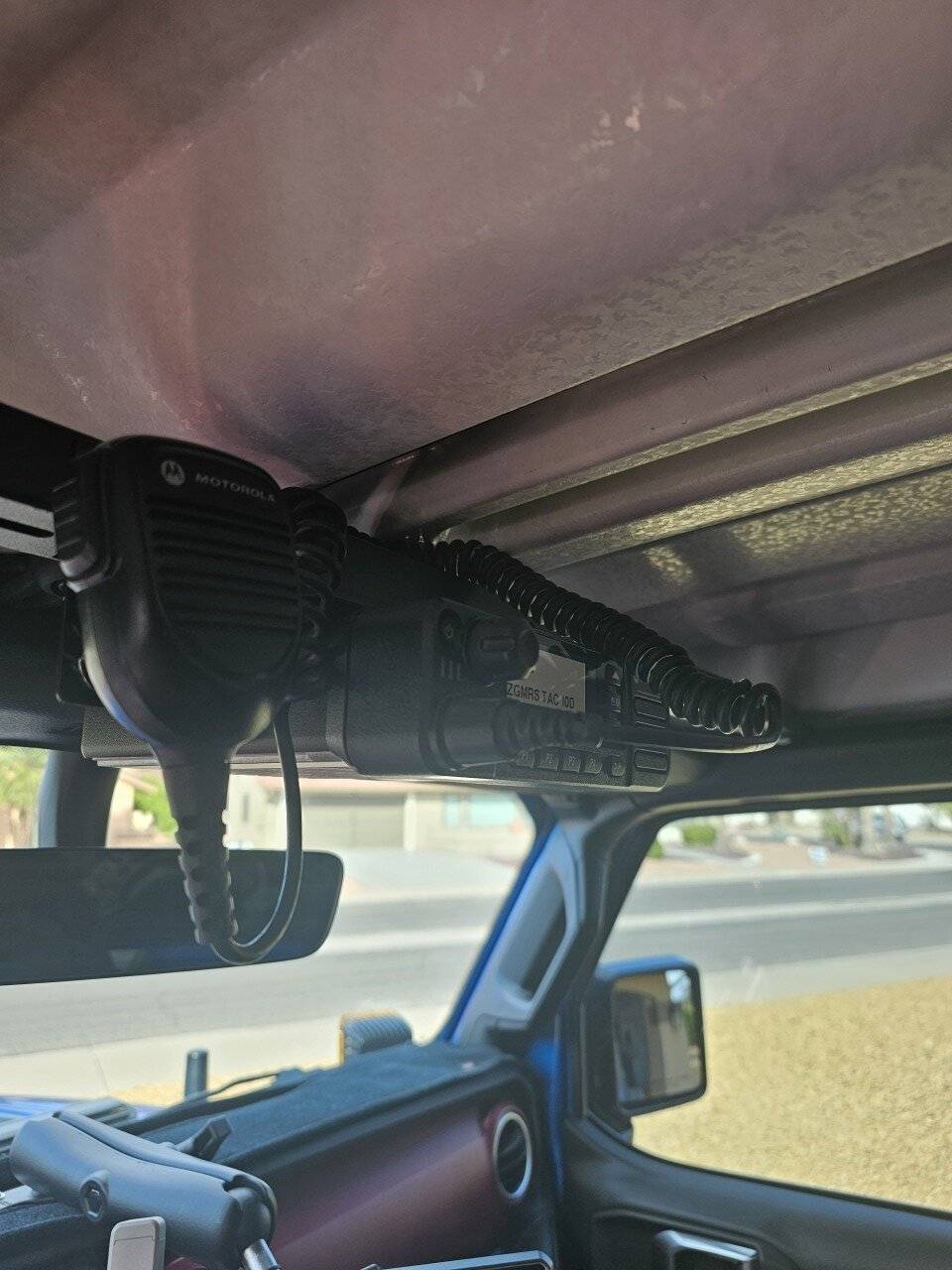

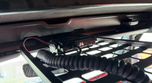

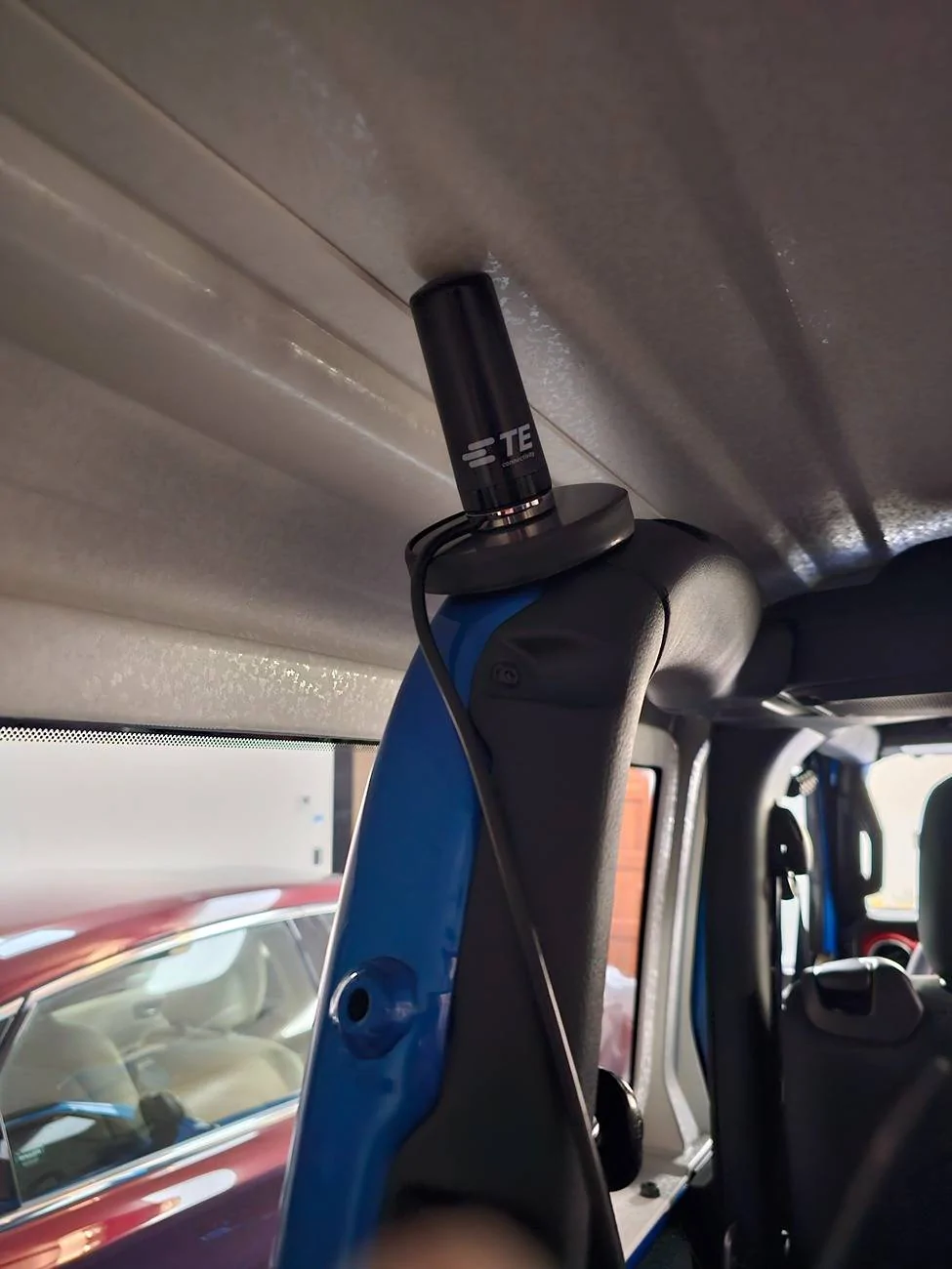

I put mine on the MPS overhead panel, easy wiring running along the windshield frame for the power and antenna and its up and out of the way all the time
Jeep Wrangler JL Midland MXT 575 install in 2024 model 1743171146629-dm
Jeep Wrangler JL Midland MXT 575 install in 2024 model 1743171159604-ht

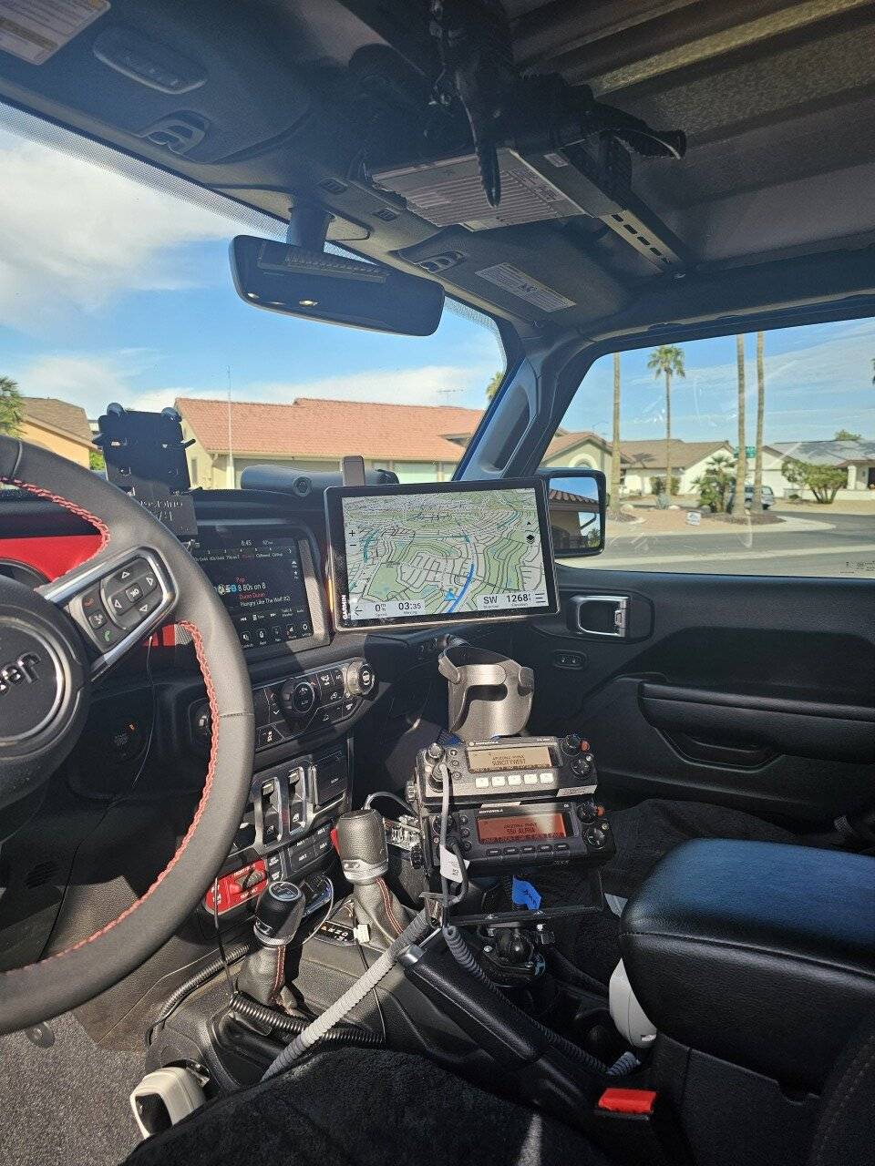

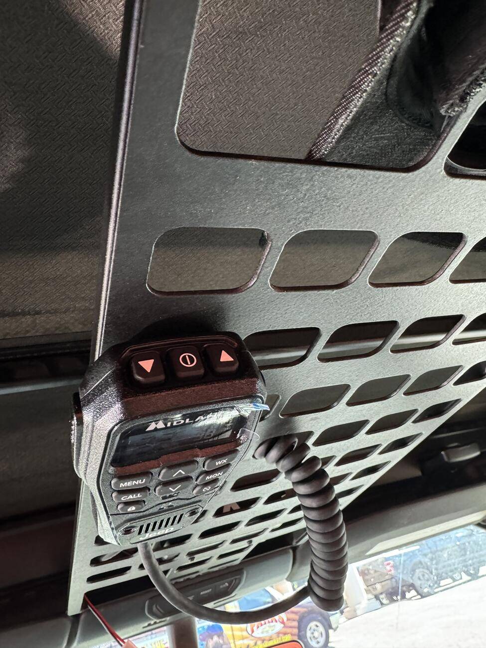

I mounted my Digital UHF radio overhead.
Jeep Wrangler JL Midland MXT 575 install in 2024 model 20250323_084529
Jeep Wrangler JL Midland MXT 575 install in 2024 model 20250323_084522
Jeep Wrangler JL Midland MXT 575 install in 2024 model 20250323_140756

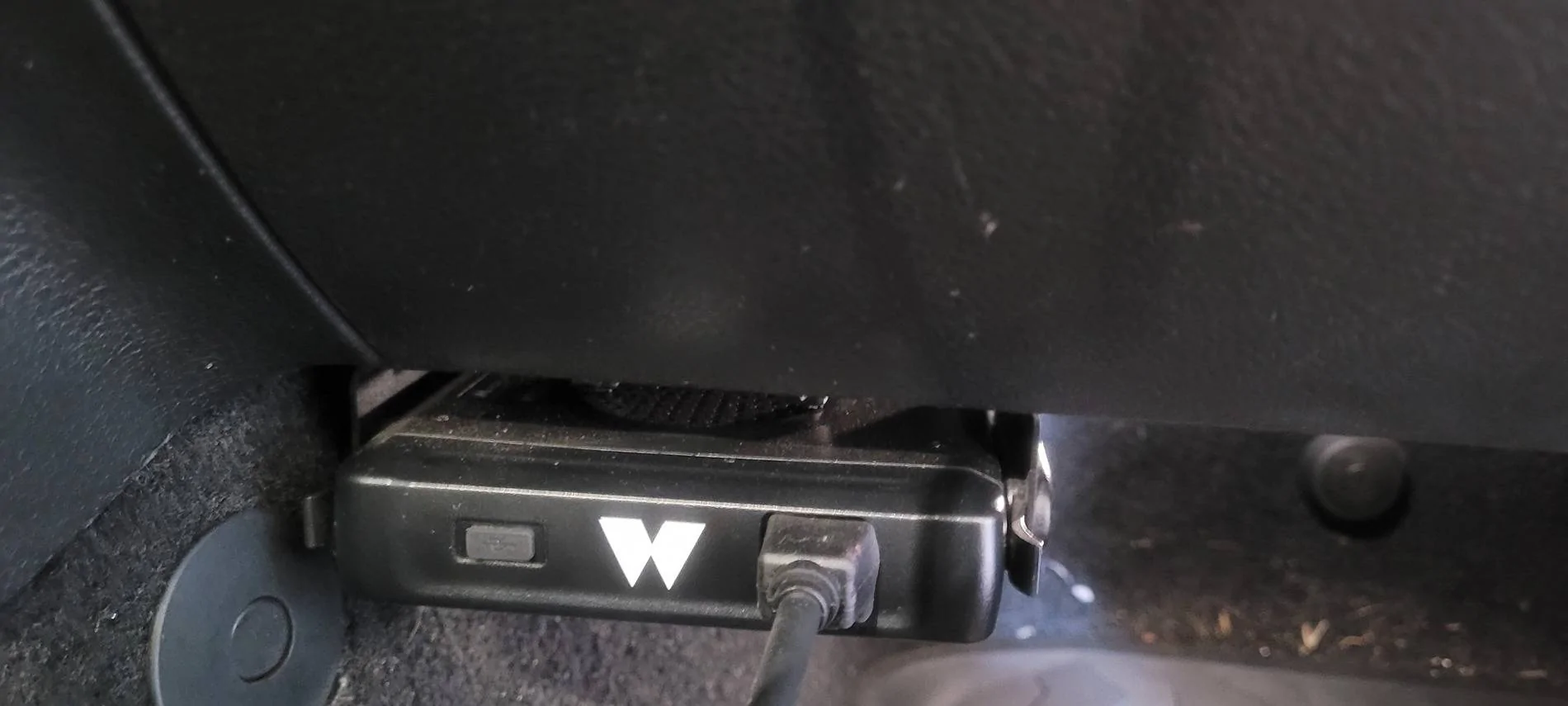

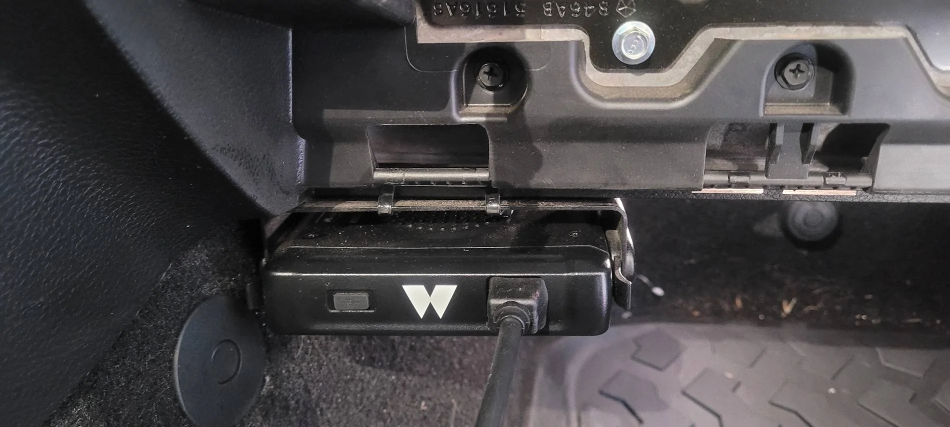

This is where my 275 is mounted - just below the glove box. Mounted the unit "clip" with some zip ties to the rail under the glove box. I don't see why the 575 wouldn't fit there as well. The unit has never bothered me or my wife when sitting in the front passenger seat. Power is straight from the battery with a 10 amp fuse so I can use the radio without the Jeep needing to be on.
Jeep Wrangler JL Midland MXT 575 install in 2024 model Resized_20250122_091316
Jeep Wrangler JL Midland MXT 575 install in 2024 model Resized_20250122_091247

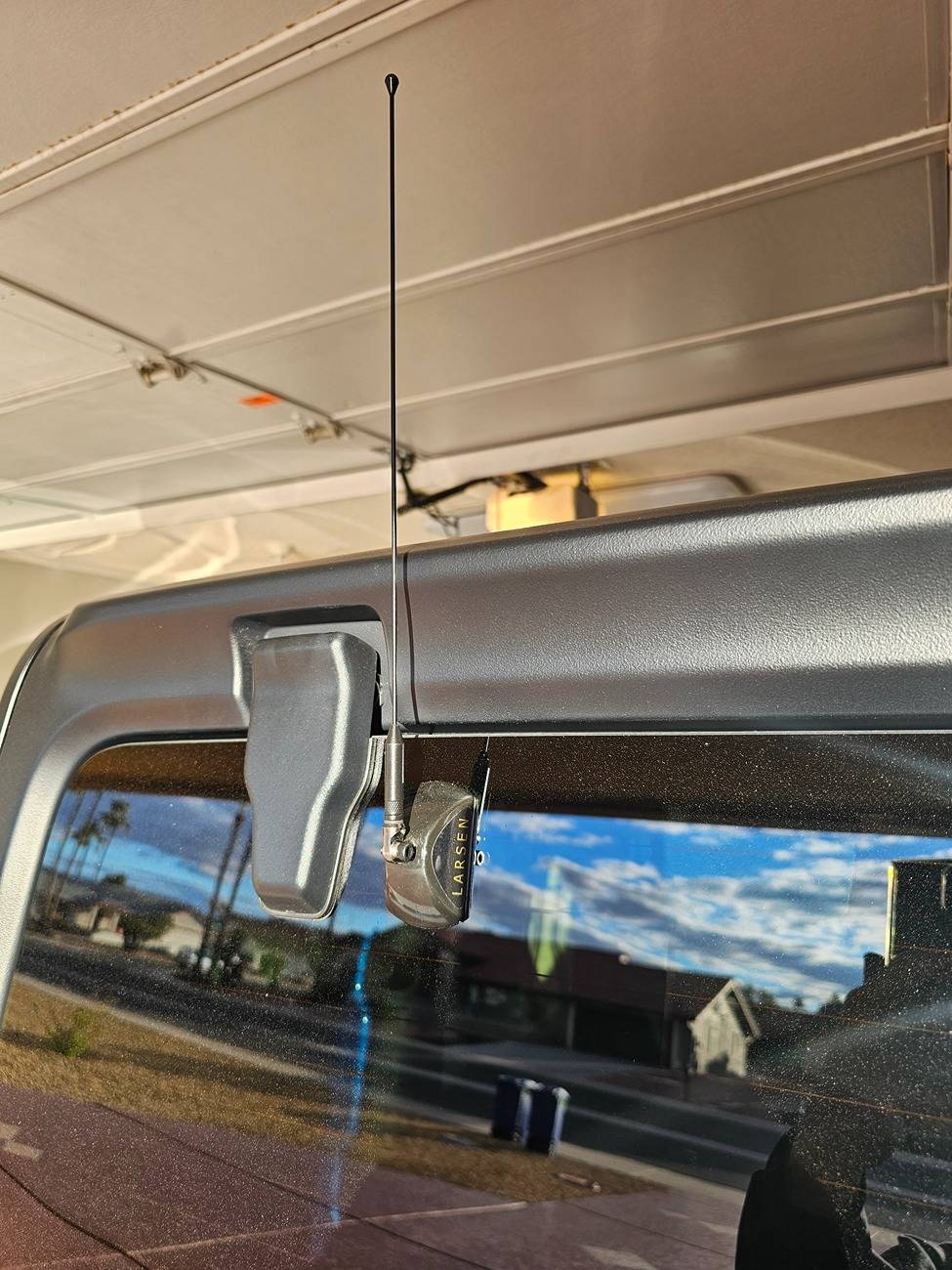

That antenna may have a good continuity ground to the chassis grounding system. The vehicle body shouldn't have any affect on your signal or cause any reflection on a transmitting signal. What are your VSWRs?

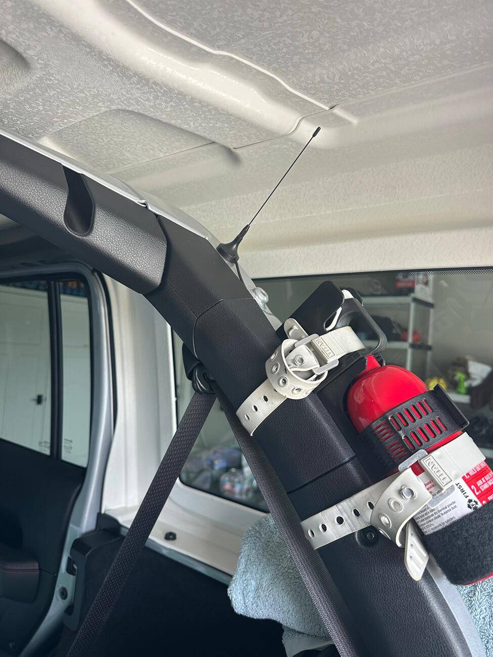

I did the same thing for a temporary antenna while waiting for my glass mount antenna to arrive.
Jeep Wrangler JL Midland MXT 575 install in 2024 model 20240103_045356
Jeep Wrangler JL Midland MXT 575 install in 2024 model 20240104_162928
