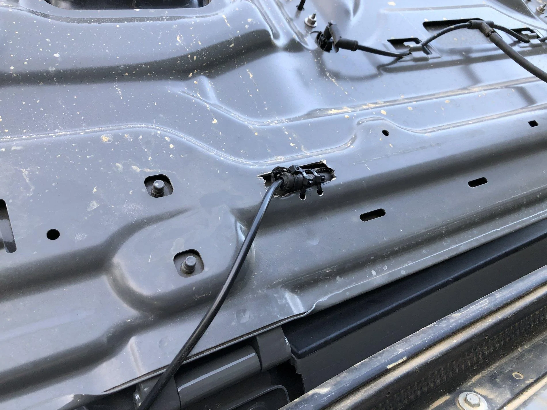

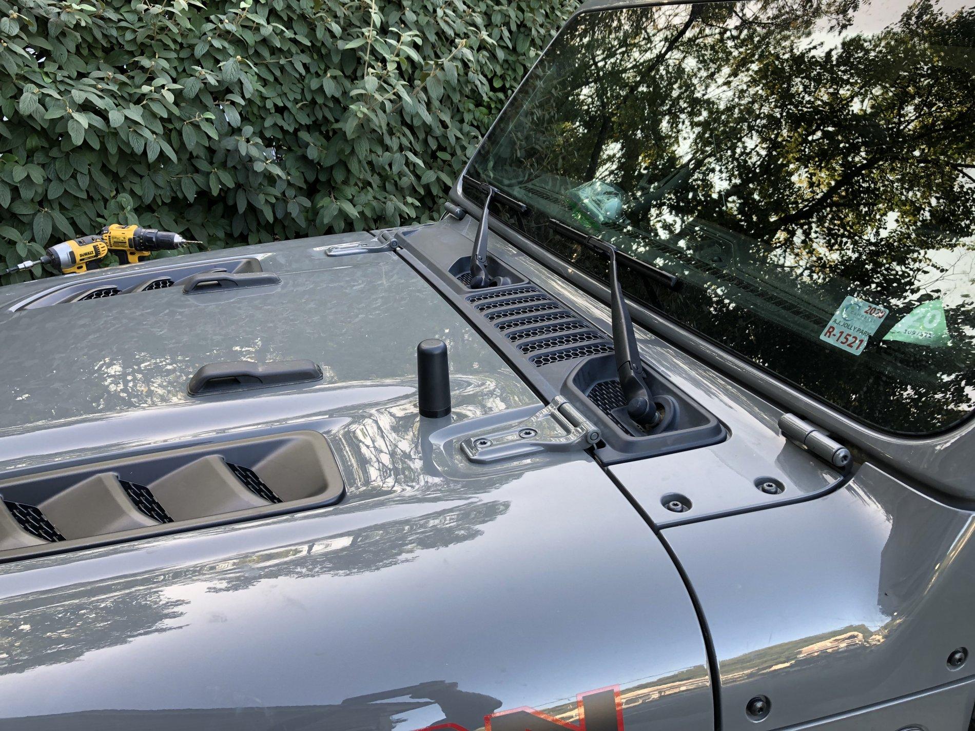

Using these guidelines, I chose the hood as my place to mount the antenna...I have no intention of dropping the windshield so out came the drill bits and cut off wheel...
This location gave the least amount of compromise and good distance from me and my passenger. Also, I liked the location because it is different than others I've seen. Being a little different is ok..

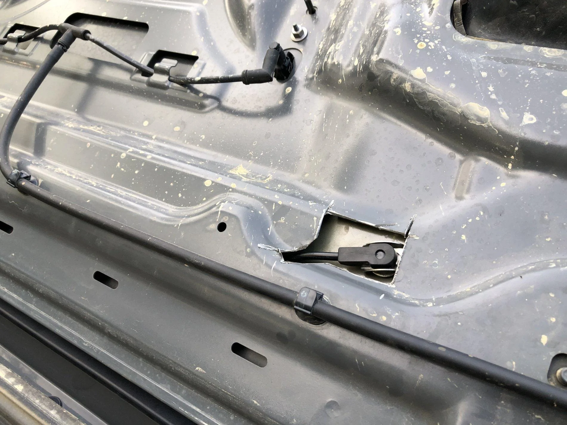

I crudely hacked a couple holes in the inner structure of the hood in order to run the antenna inside the hood. No real reason other than I wanted to hide it. I do plan to clean up the holes this winter, making them look less...shitty.
I used some vacuum hose to protect the cable where it exited the hood structure.

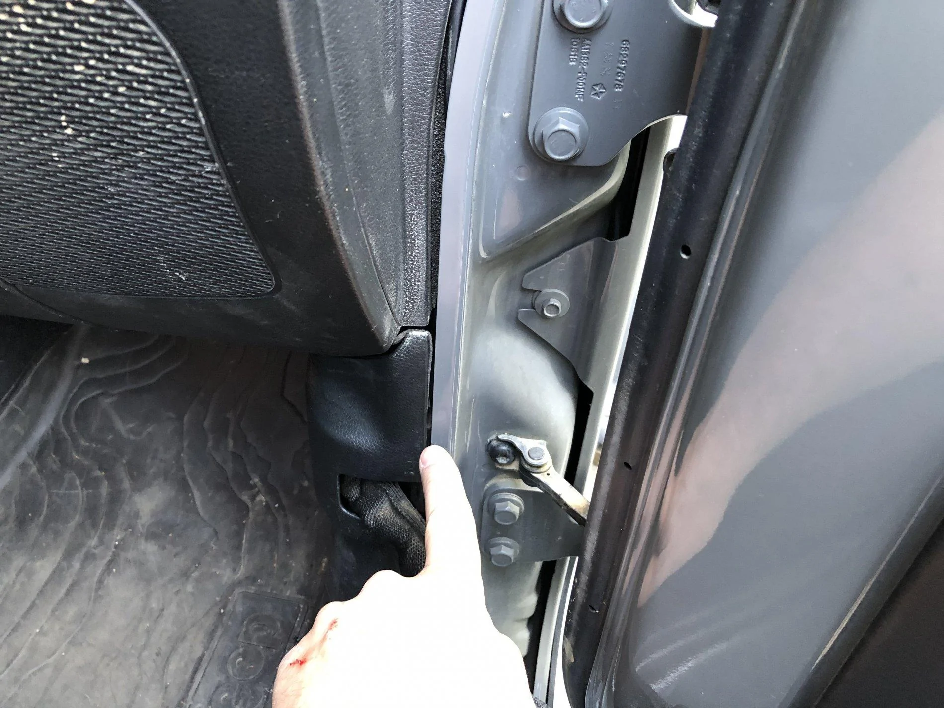

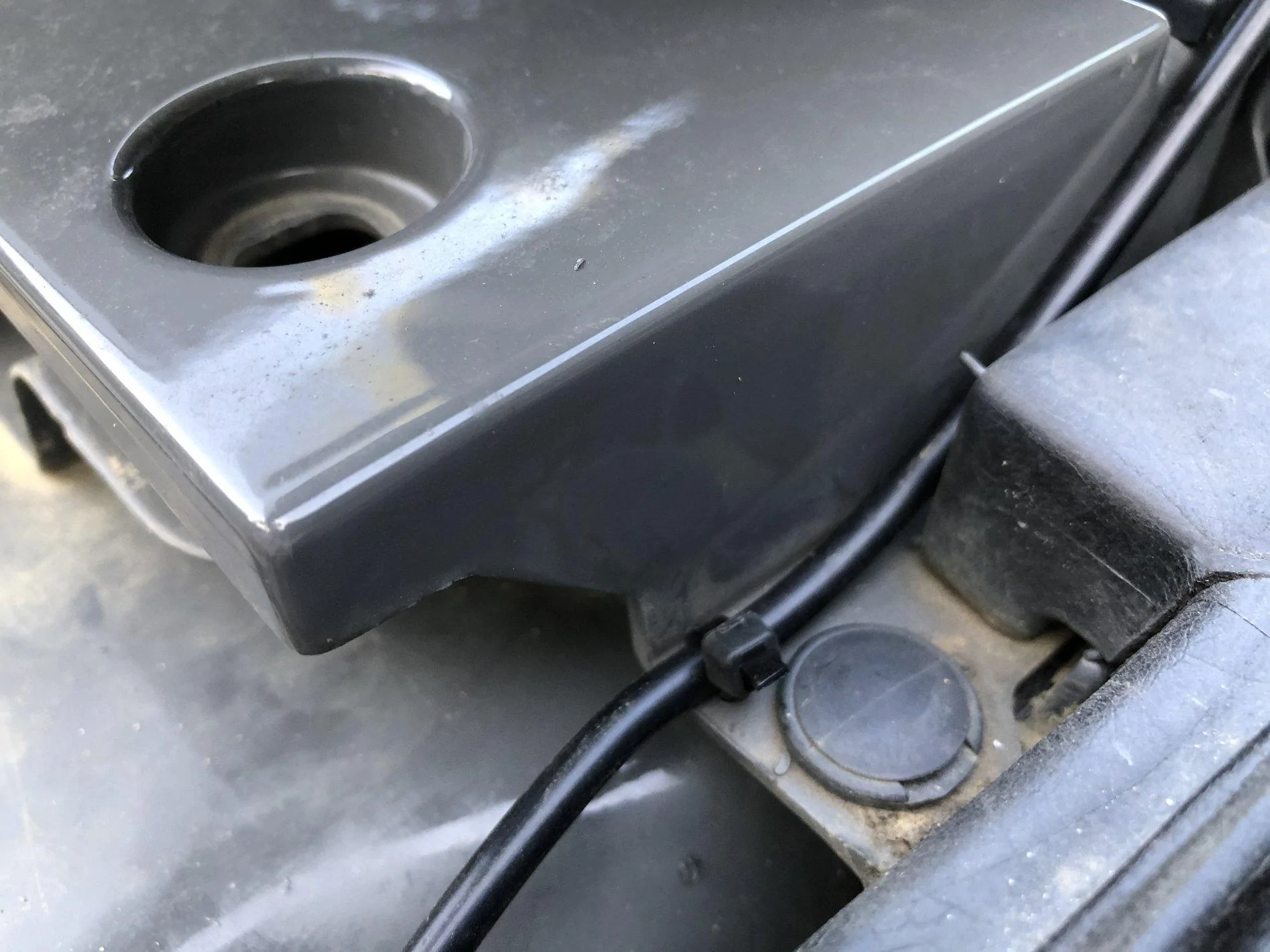

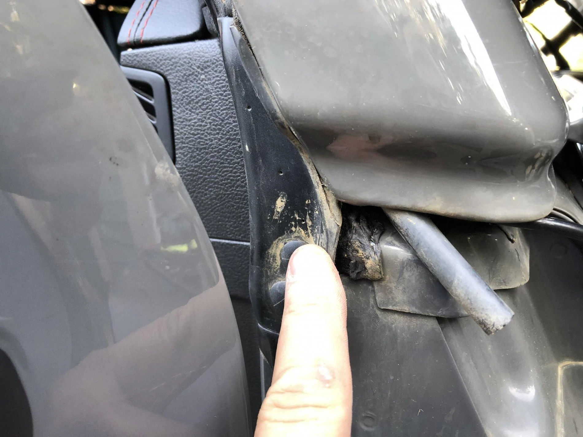

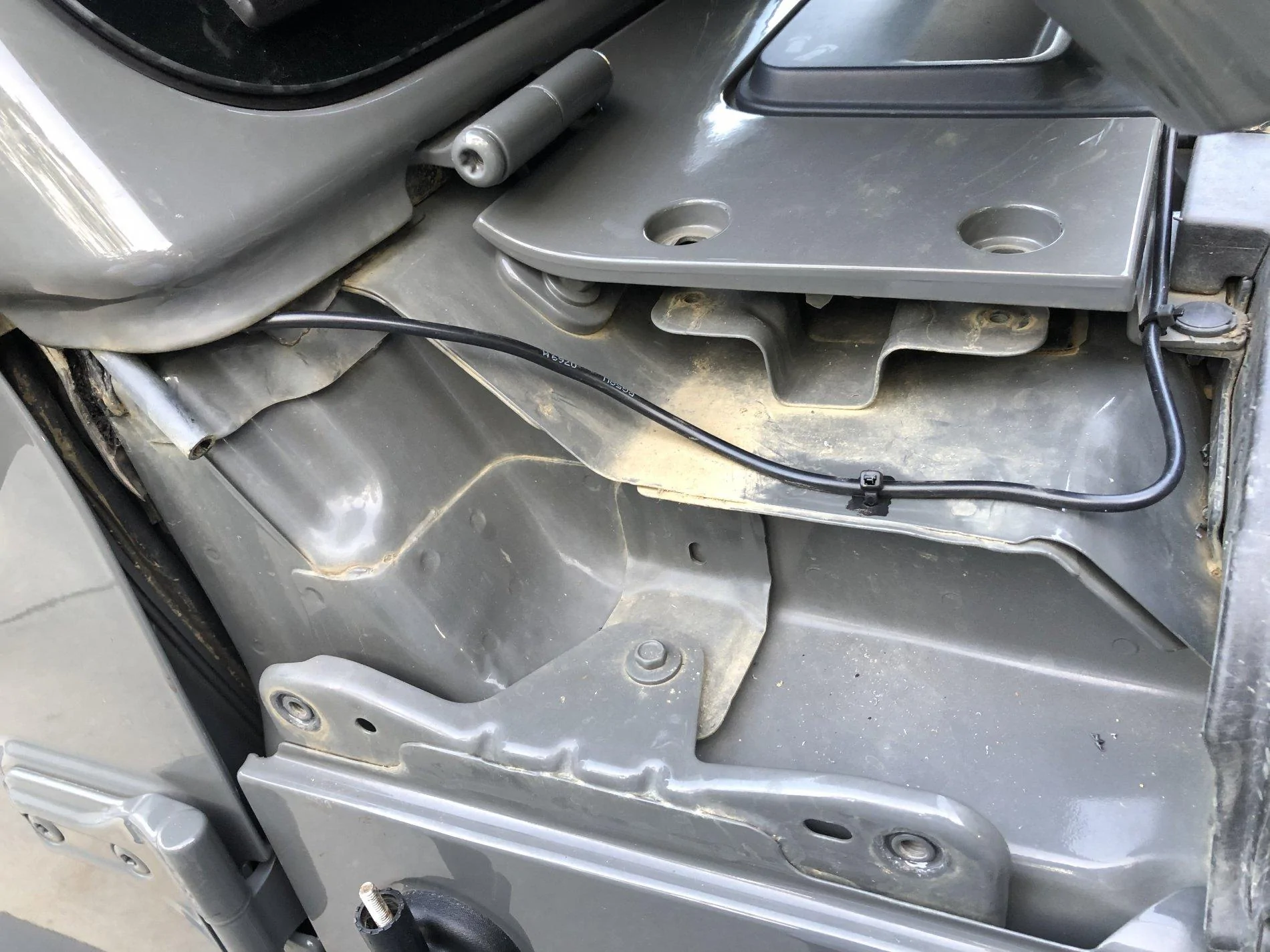

Rather than fight with existing grommets in the engine bay, I removed the cowl and ran the cable through the seal where the windshield frame meets the tub. I secured the cable with zip ties in a few places to keep chaffing from vibrations to a minimum.

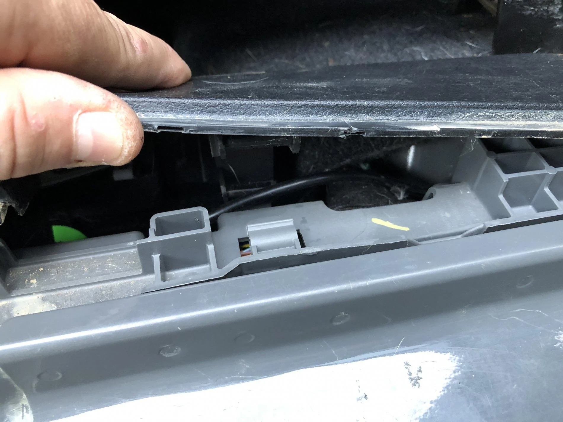

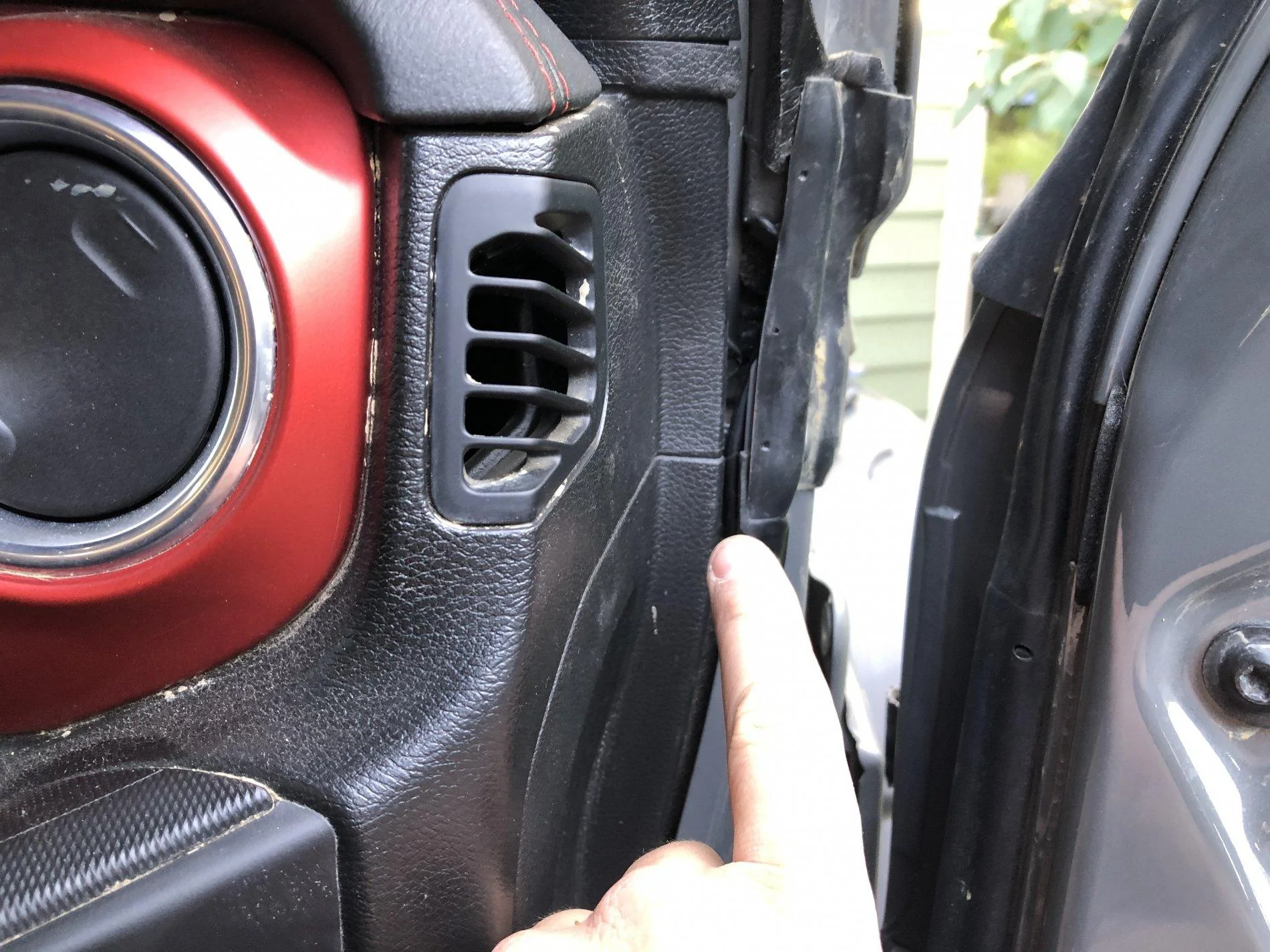

After getting the cable into the cab, I ran down the side of the dash and tucked it behind the trim.
I then ran it under the scuff plate and coiled the extra cable under the rear floor vent.

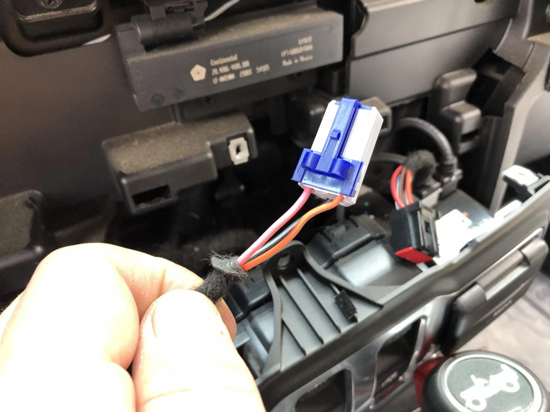

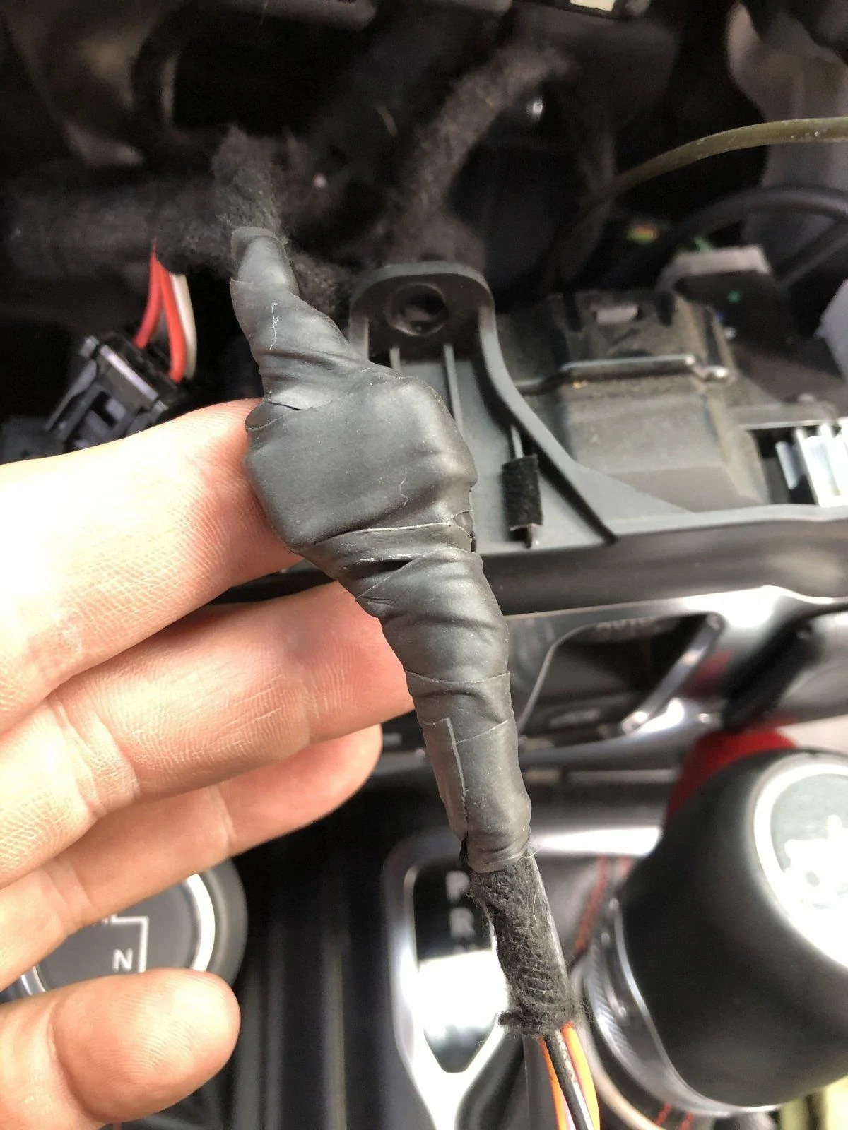

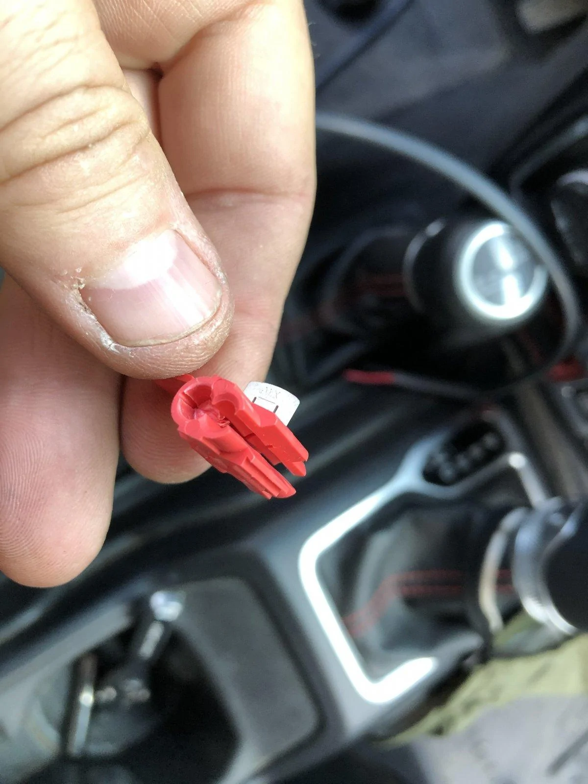

For power I tapped into the front cigarette lighter power with a tap and bundled the junction up and stuffed it all back into the dash.

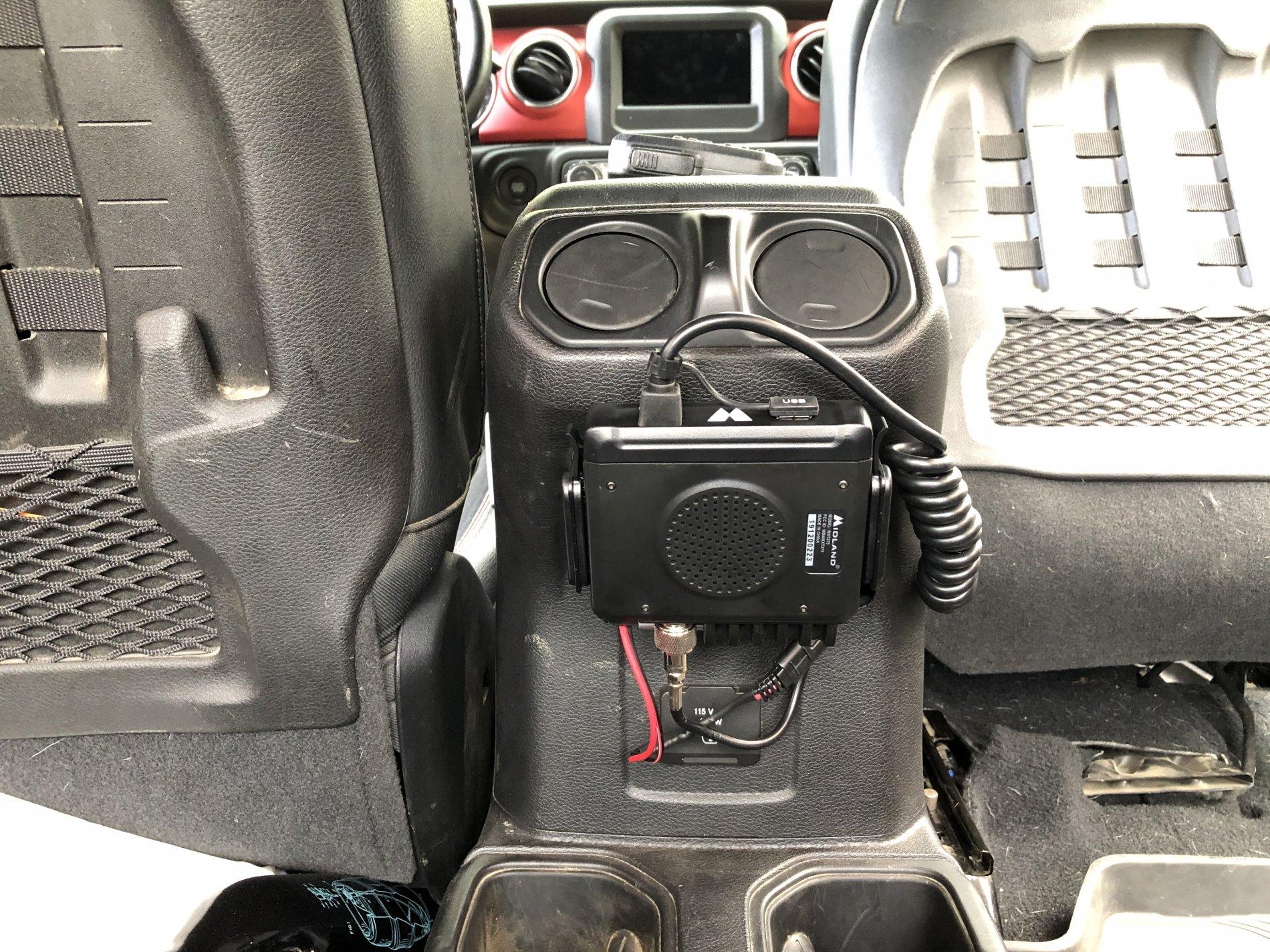

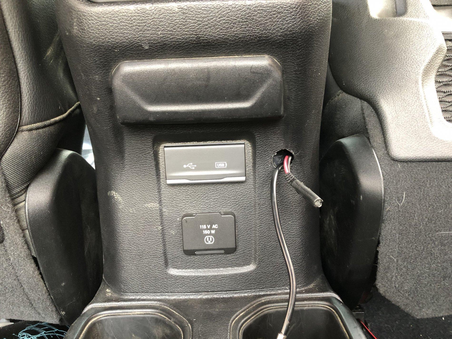

I ran the antenna cable and power through the center console so I could mount the the radio on the back of the console. Everything is still able to be disconnected incase I need to remove the radio.
