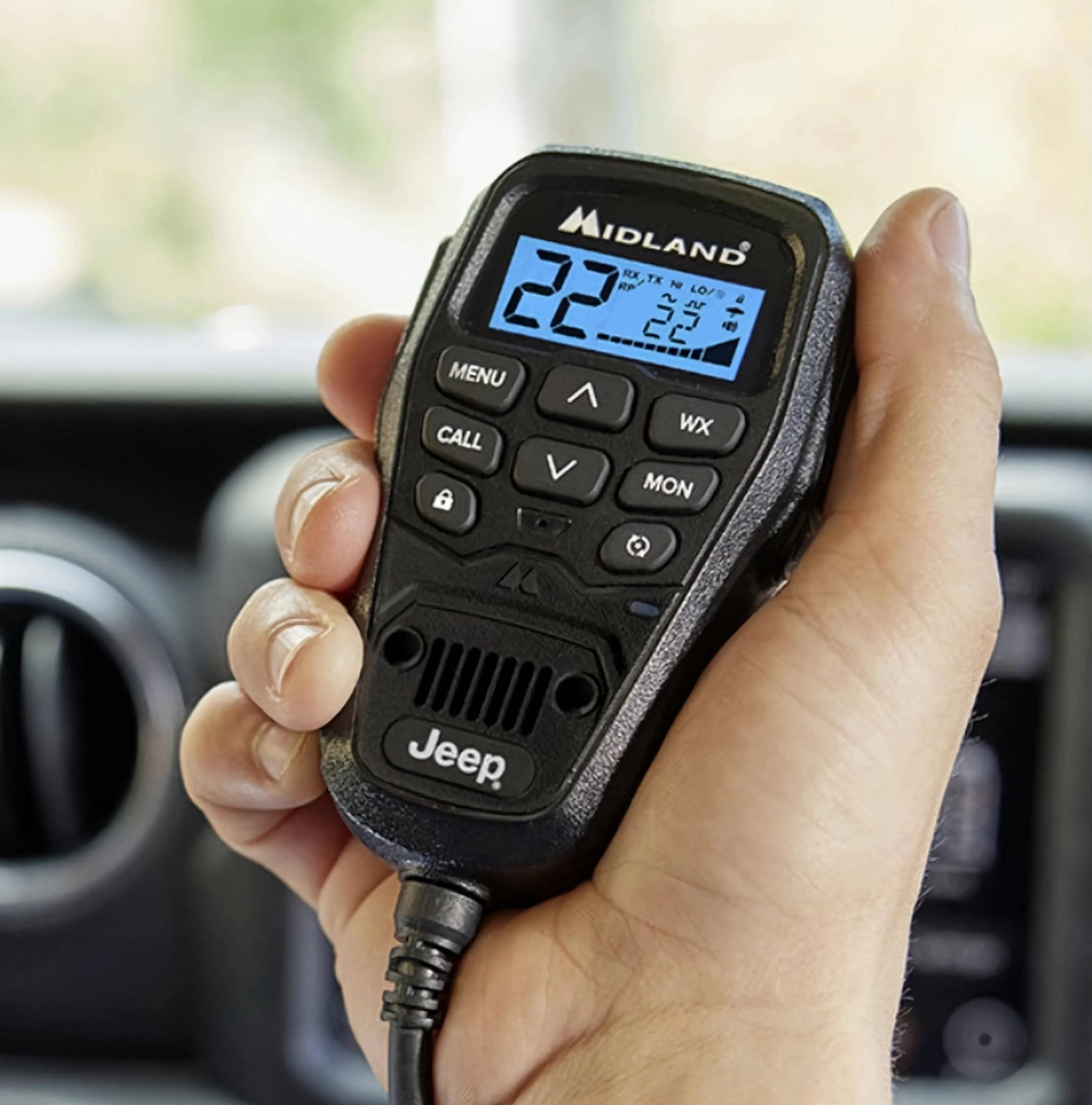

Hi everyone!
Just got a MXT275 for Christmas and installed before my last three trips. Ran the power to an accessory adapter from Quadratec (this may be the culprit) and there are two in line fuses. The issue persisted without the antenna cable screwed in, so I know that’s not the issue.
What’s happening is MOST of the time (one of the 7 days of wheeling I didn’t have the issue… no idea why) after a couple of transmissions, the display on my microphone goes out. I usually can receive one last transmission but I either have to power on the unit again by holding the power button. A couple of times I had to disconnect the Ethernet cable between the mic and the brain.
The big problem is I can’t replicate the issue unless I’m on the trail. I’m going to try and ground the ground wire to a bolt and see if that resolves the issue. I may try removing one of the in line fuses (one was from the Quadratec adapter and one came on the 12v wire for the midland).
What other suggestions do you have? When the radio is working, it’s easily my favorite radio I’ve ran (cobra CB and baofeng uv-5r before) but so often it just powers down. Today on dishpan springs, I had to power it back on almost every conversation with the other rigs in my group.
Please advise!!!
