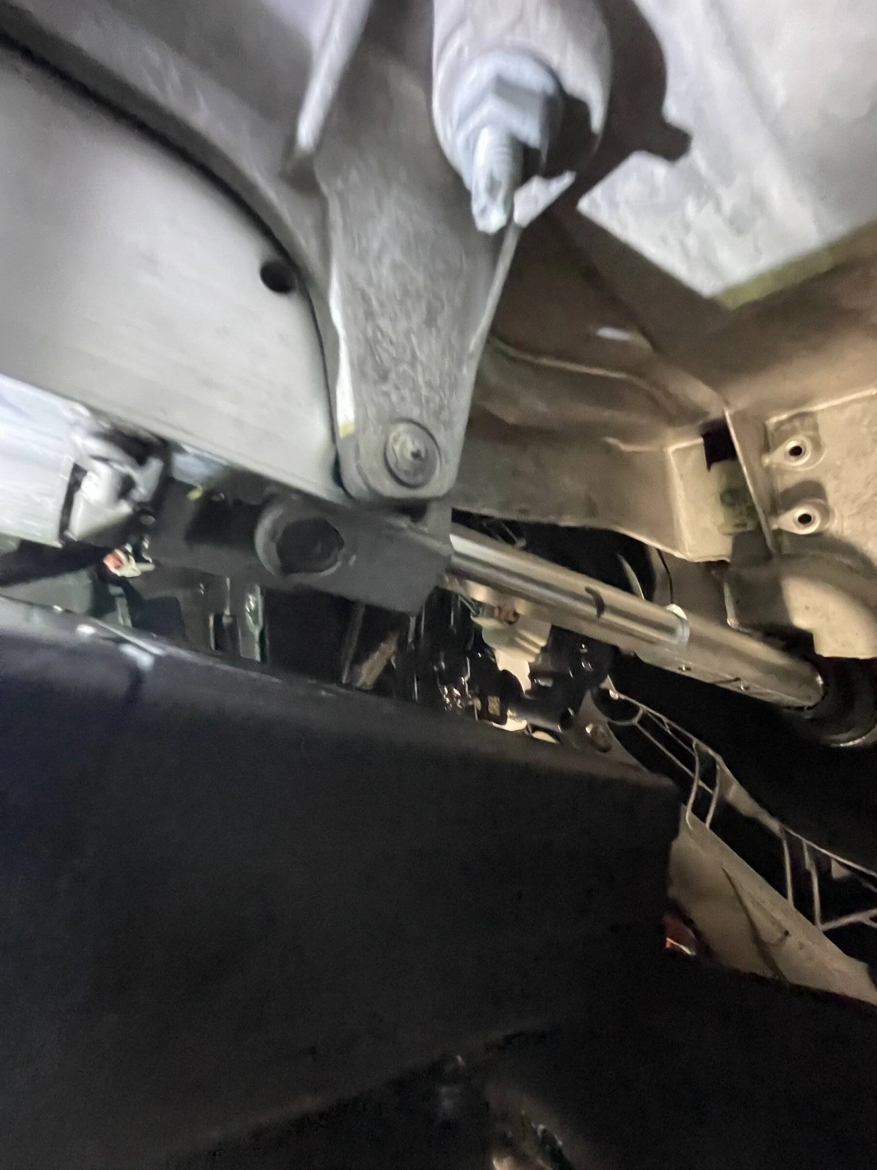

Where under the steering column. The only place I found it fits is on top of that electronic box (without mount) and it is very close to the steering column which seems too close to be a good idea. I’m not arguing that it can’t go in there I’m just struggling on where and that was my original plan. From the specs online I thought it was going to be just slightly longer than the MXT275, but no it’s over 2x the size.

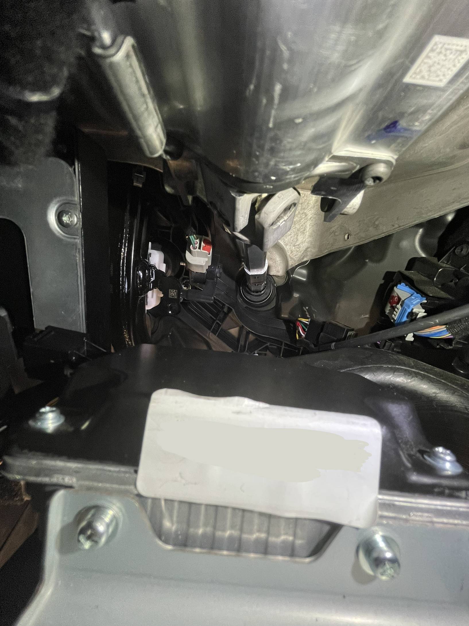

Hard to get super clear pics, but this is removing that beauty panel under the steering wheel and looking up at a bit of a dutch angle.

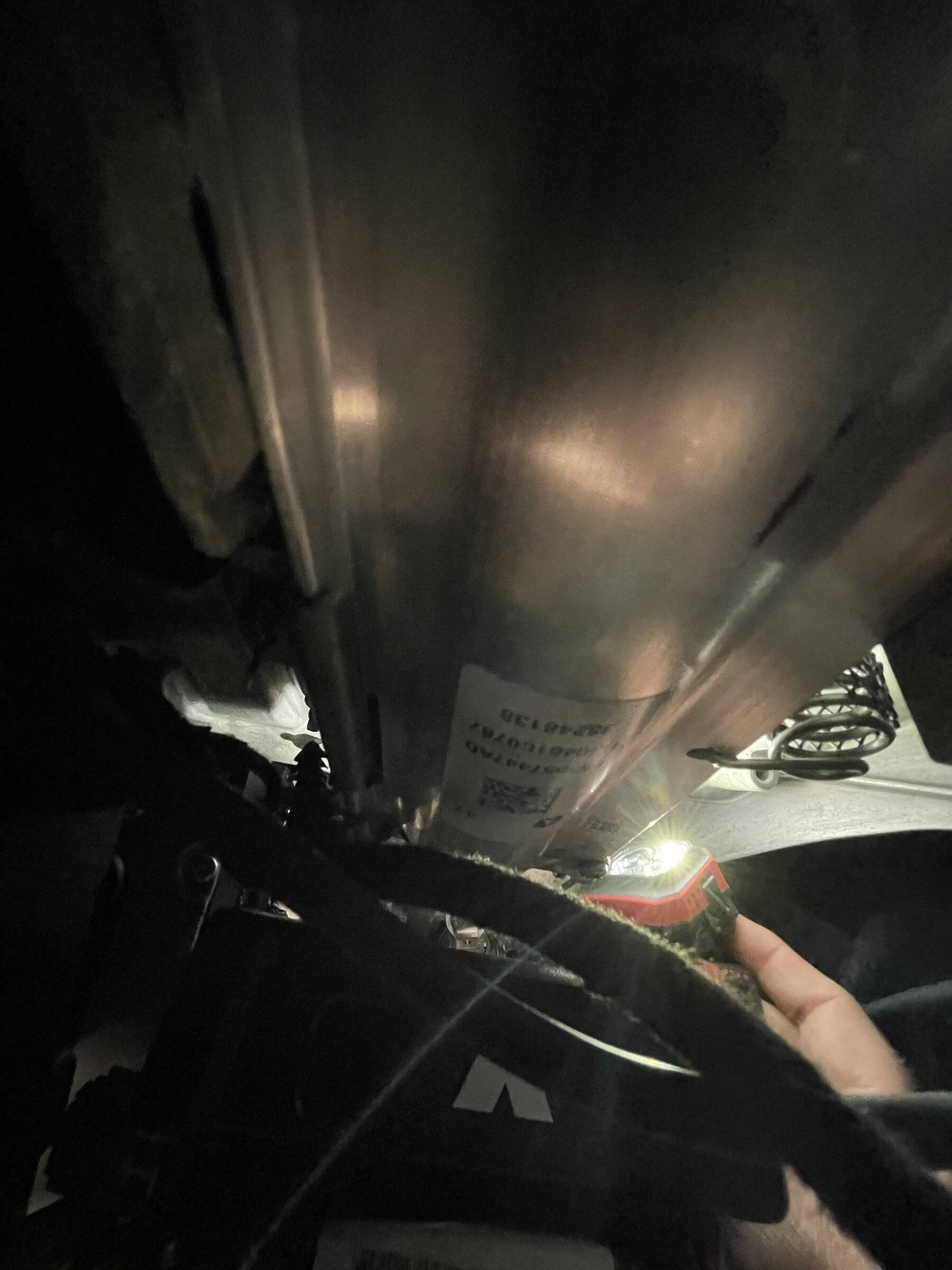

Here are some others that show how close to the steering column it would be. Not great photos but this is sticking my phone where I can barely get my hand in. 1st looking forward and 2nd looking at it from the side camera near center console.

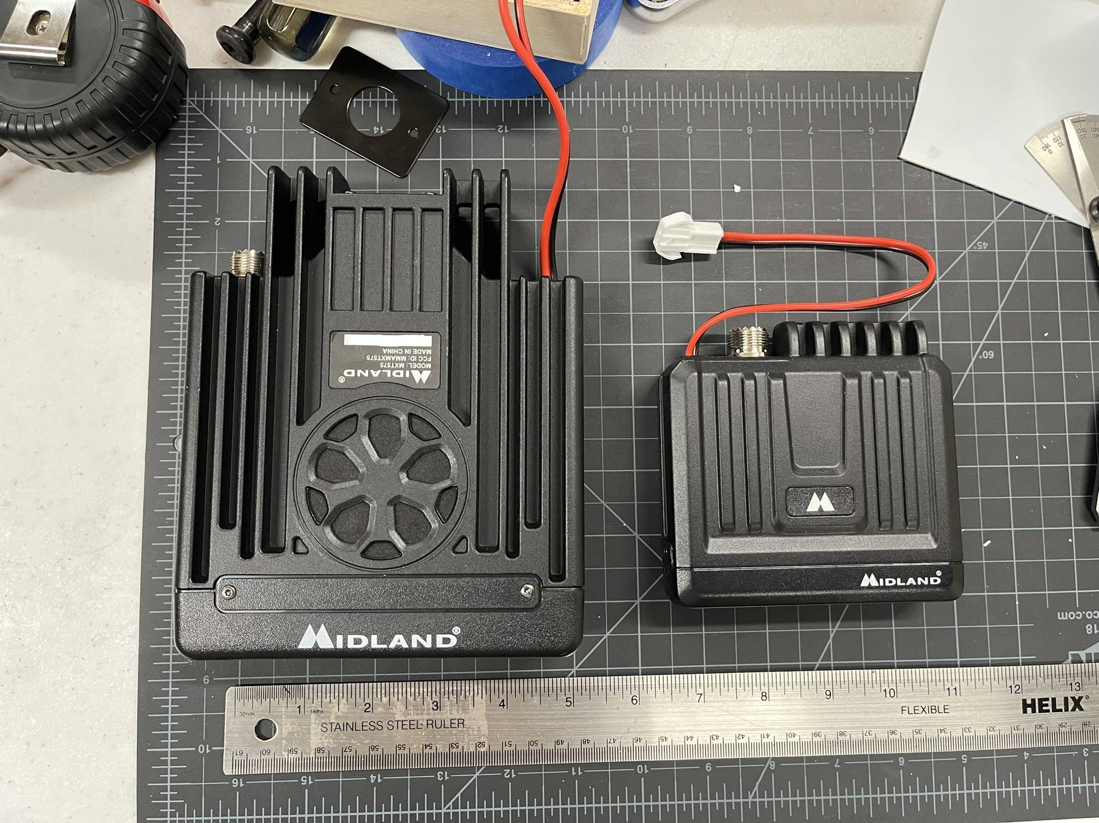

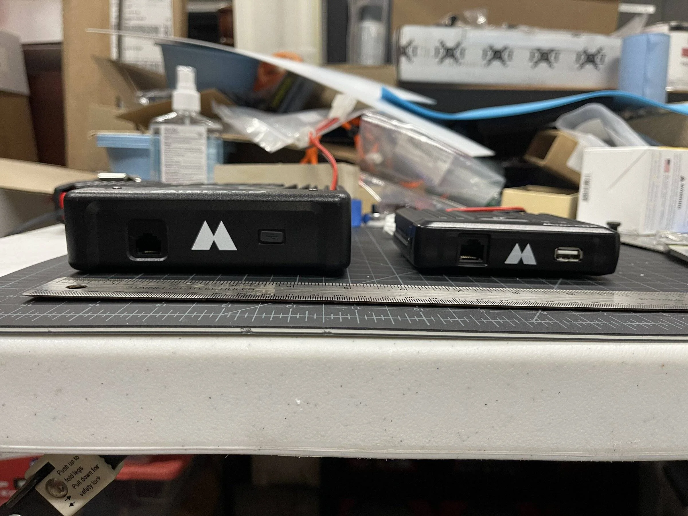

Here are some handy side by side pics of the size difference between the MXT575 and MXT275

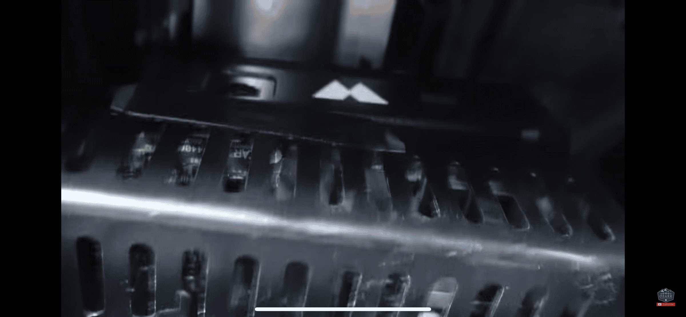

This video.

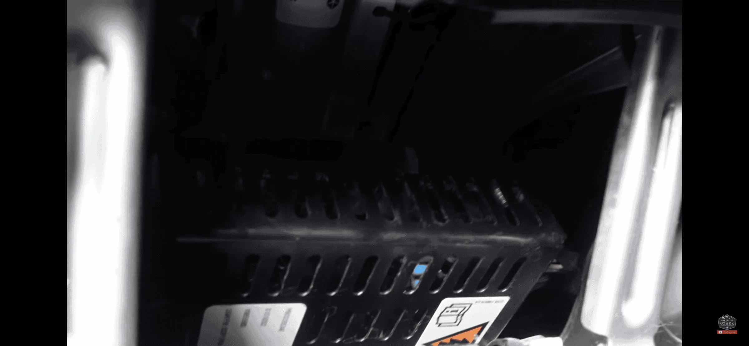

Not sure what year and setup he has but on my jeep there is not a big flat sheet metal bit to mount it to. Just a small little metal top measuring 3in deep x 4in wide at the max point . Mine is a newer wrangler (2021) and I’d suspect this is a change for newer vehicles. Hopefully yours has that sheet metal the guy in the video has.
Jeep Wrangler JL Midland MXT-575 are here! 13E96C87-FA05-48C0-BF2B-E19DC2B6DF6B
images captured from Ozark Overland video

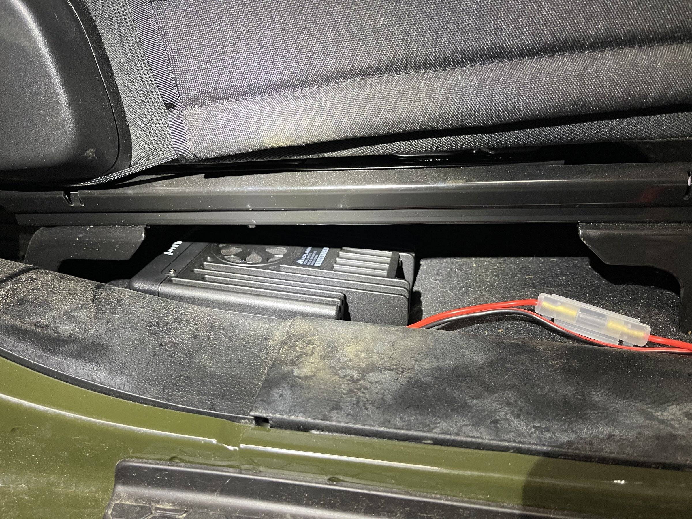

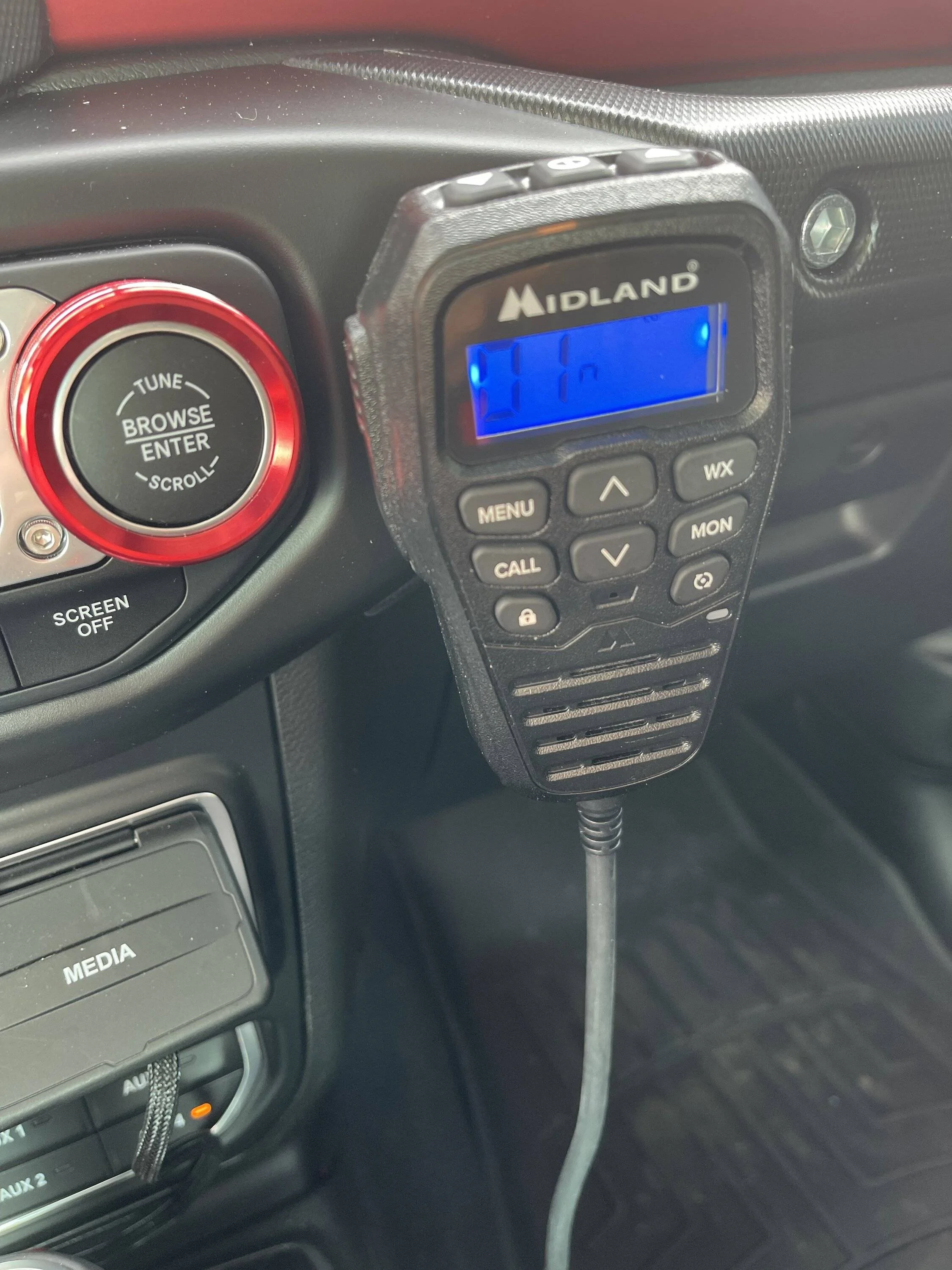

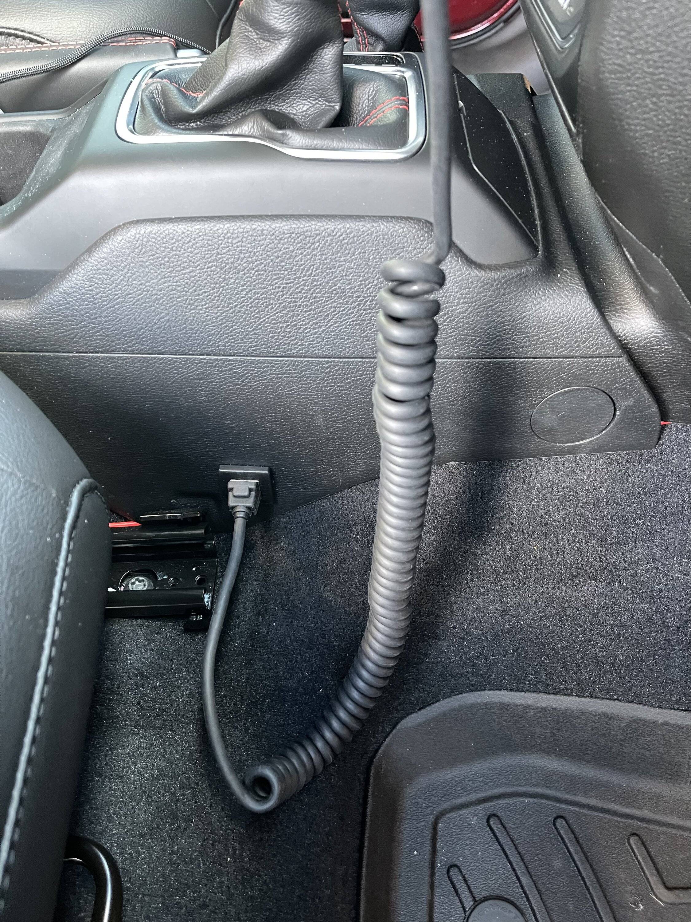

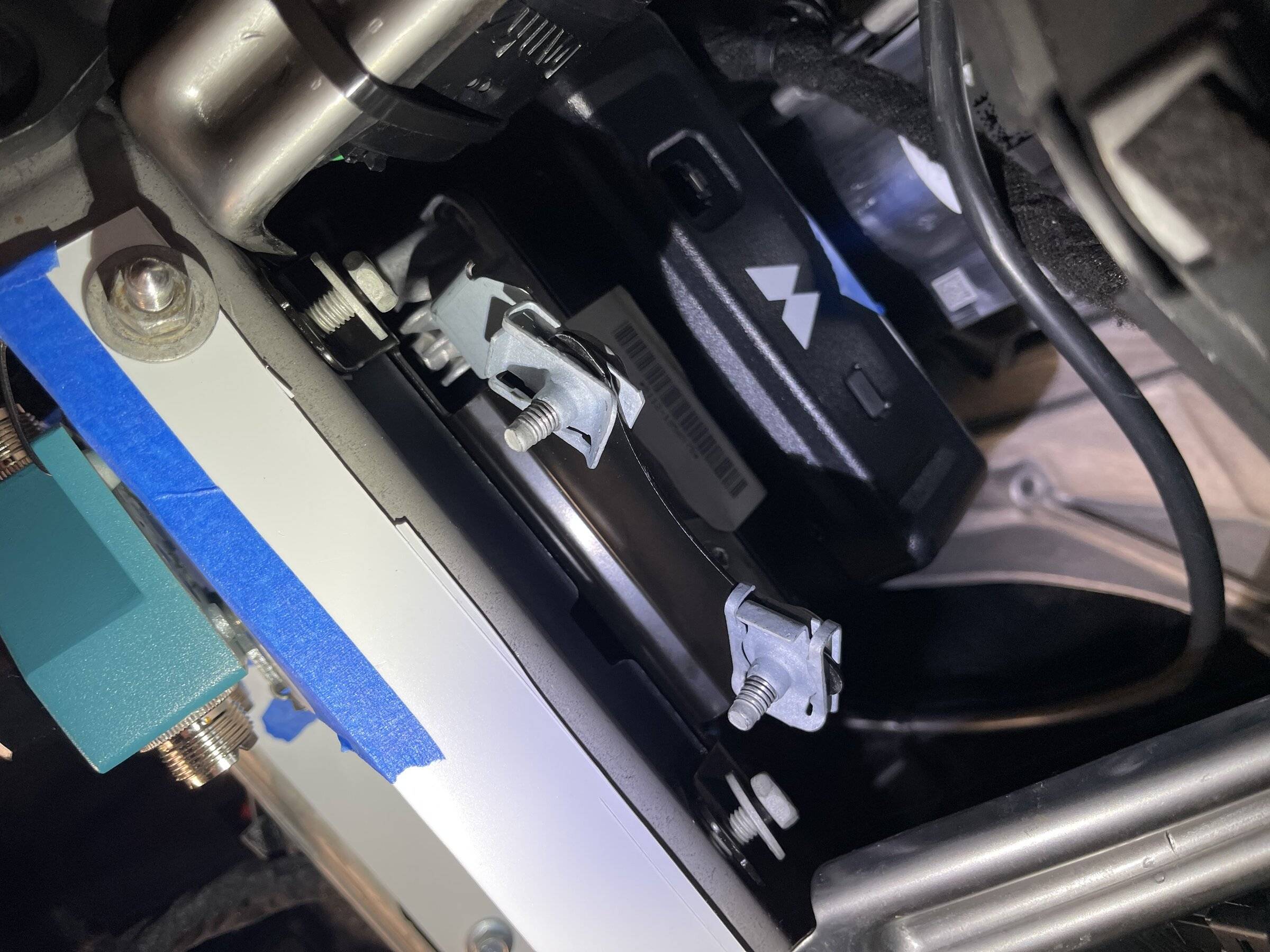

I mounted mine under the driver seat. I have the ARB Kraken system under my pax seat. Installed a Ethernet receptacle on the pax side of the center console and mounted the mic on the dash…

What’s the link for this part?

You can find tons of them on Amazon. They are Cat 5/6 RJ45 connectors. I did the same thing with my MXT275. Super easy to install, the hardest thing was cutting the hole out with my Dremel. I had some extra Cat 5 laying around from an Internet router that I don't have anymore, works great.

https://www.amazon.com/Installerpar...ocphy=9024241&hvtargid=pla-414268565197&psc=1
Make sure you check the clearance on the backside. You need to locate back towards the seat but if you go too far back you will hit it with the seat forward. If it is mounted too far forward it will not fit flush.
