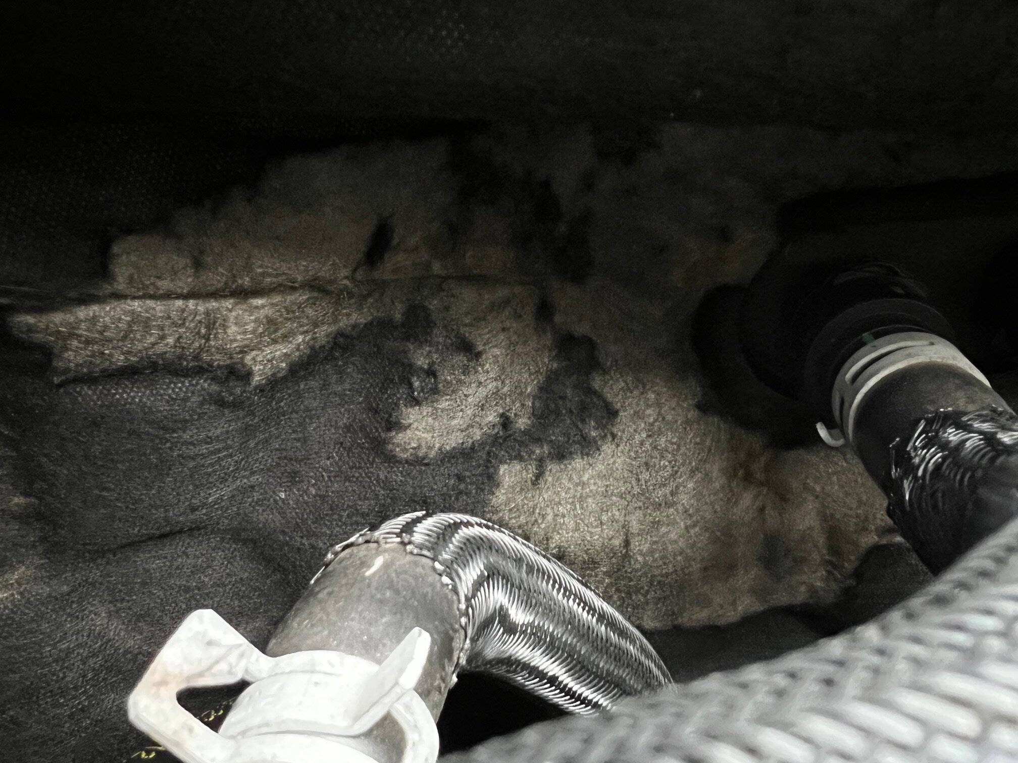

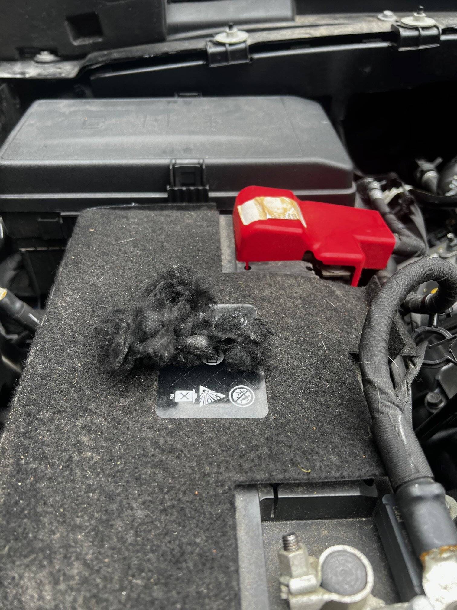

Since the weather has been unusually cold the last several weeks (sometimes dipping to 11 degrees at night), mice have found their way into my garage. I've been battling these bastards since I saw evidence of rodent intrusion and recently discovered that they've now taken to chewing on my firewall insulation. I've laid out traps (snap and bucket) and haven't caught them yet, but I have a feeling they've scattered due to the copious amounts of pine oil I've been spraying around my engine bay.
Anyway, the damage thankfully isn't that bad. None of the wiring looms or harnesses seem to have been touched. However, if I ever wanted to replace the insulation pad behind the engine, it looks like I'd have to drop the chassis and lift the body off. Not something I can easily do at home with a small amount of power tools and jackstands.
Since the area is relatively small, I just want to make that area that got chewed up a bit more presentable. Was wondering if fabric adhesive and a felt pad cut to shape would work. Or perhaps, just spray that area with some black fabric dye? Anyone here experienced and repaired anything similar? If so, what are your thoughts or suggestions?

I had chipmunks chew up firewall insulation on a pickup. I used black cheap landscaping fabric to cover the carnage with spray adhesive. It was a cheap fix and did not look bad. Do not use any flammable material. Open your hood while in the garage. Mice do not like the open space. I got my garage sealed from rodents but one will occasionally come in with my Jeep. Then it is multiple traps with peanut butter until I get the little bas...d.
