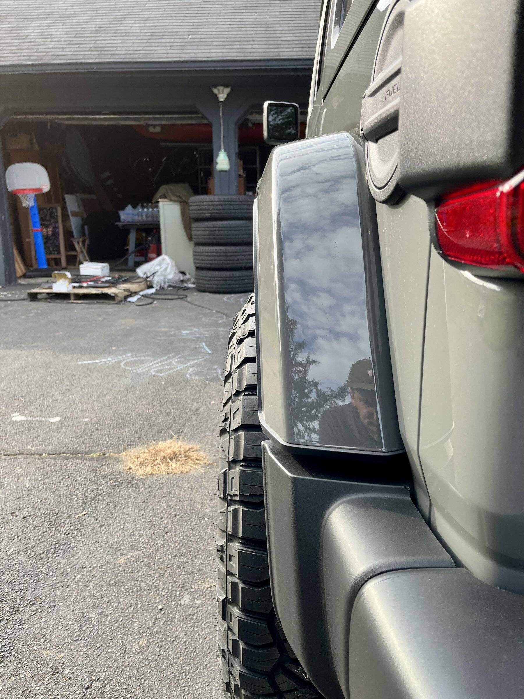

Keep in mind that going from whatever your stock offset is (likely something less than 0) and going to a +25 will result in a lot of poke. I think the general rule of thumb is every 6mm of offset is about .25in - so you’d be looking at 1.5 to 2in of poke.
Edit: had my pos and neg offsets reversed! You should be good and will probably sit flush
I have the 703s on 285/70s - 0 offset and they stick out about .5-1in now.

The stock wheels are +44. +25 - +12 are perfect for a flush/near flush look. Anything else starts to stick out..."poke" as some call it. Damn stupid term.

I think stock is about +44 and So +25 will be approx 1" more inward than 0, which I think would be not much poke. ;)
sorry you’re right! Had my number backwards ? and I also didn’t realize you could get Methods in a positive offset!
