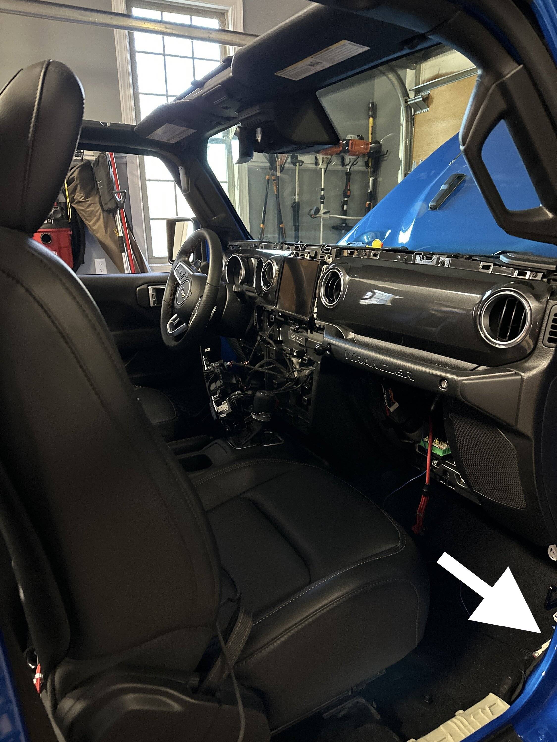

Anyone getting an alternator whine with this install? This just started recently> I checked the ground and moved it as well to test but still getting it. I hear it as I accelerate and decelerate.
Thats weird. Have you added any other electronics/lights to the Jeep? Where is the amp lead grounded? Mine is on the passenger "A" pillar grounding stud for reference, behind the kick panel on the floor.

Nothing added but my ground is the one nearest the middle console on the passenger side. I should’ve taken a pic.
There are body grounds here you can use... it's where David/MBQ recommended for the kit FYI. Mine is silent, no alternator/ground feedback that I can hear.

Thanks guys! I’m going to try that this week.
I used that same ground and no issues here.

What I did notice it’s not apparent until I jack the gains up past 12. More prominent at 2 o’clock.

Just to let everyone know, I moved the ground to where Hal's is and still had the whirring. Callled MB Quart and talked to David. We isolated it to the soundbar and I ran an extra ground from the negative on the battery to the same grounding screw that the kit was grounded to...still the same,. They are sending me new wiring from the sound bar to the amp. Hopefully this fixes it.
