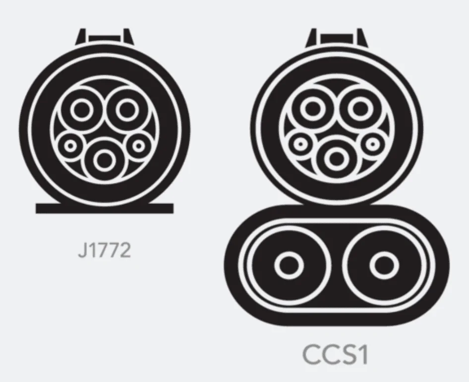

Is there a maximum “level” charger that the 4xe will take? Can you use a level 3 charging station?

Additionally, out in the wild you can only use chargers that have the standard "J1772" plug – which is what Level 2 chargers use. You cannot use any public charger that has the "CCS" plug. The top half of the plug looks the same, but the bottom portion gets in the way.
Sometimes you'll show up to an Electrify America or Chargepoint charger that otherwise looks the same as a Level 2, but it only has a CCS plug.
Jeep Wrangler JL Max level charge for 4xe? Screenshot 2023-05-19 at 16.48.13
