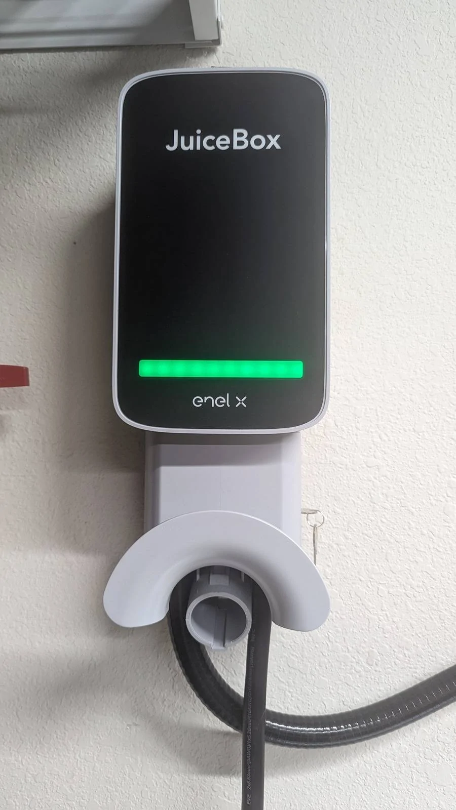

Anyone buy & install level 2 charger at home for their Wrangler 4xe? Which one you buy? Where? How much? Feedback?
I purchased a Wallbox 40 amp at Costco on sale last year. They are a large company with good customer service. The JuiceBox 40 amp is $399 today.

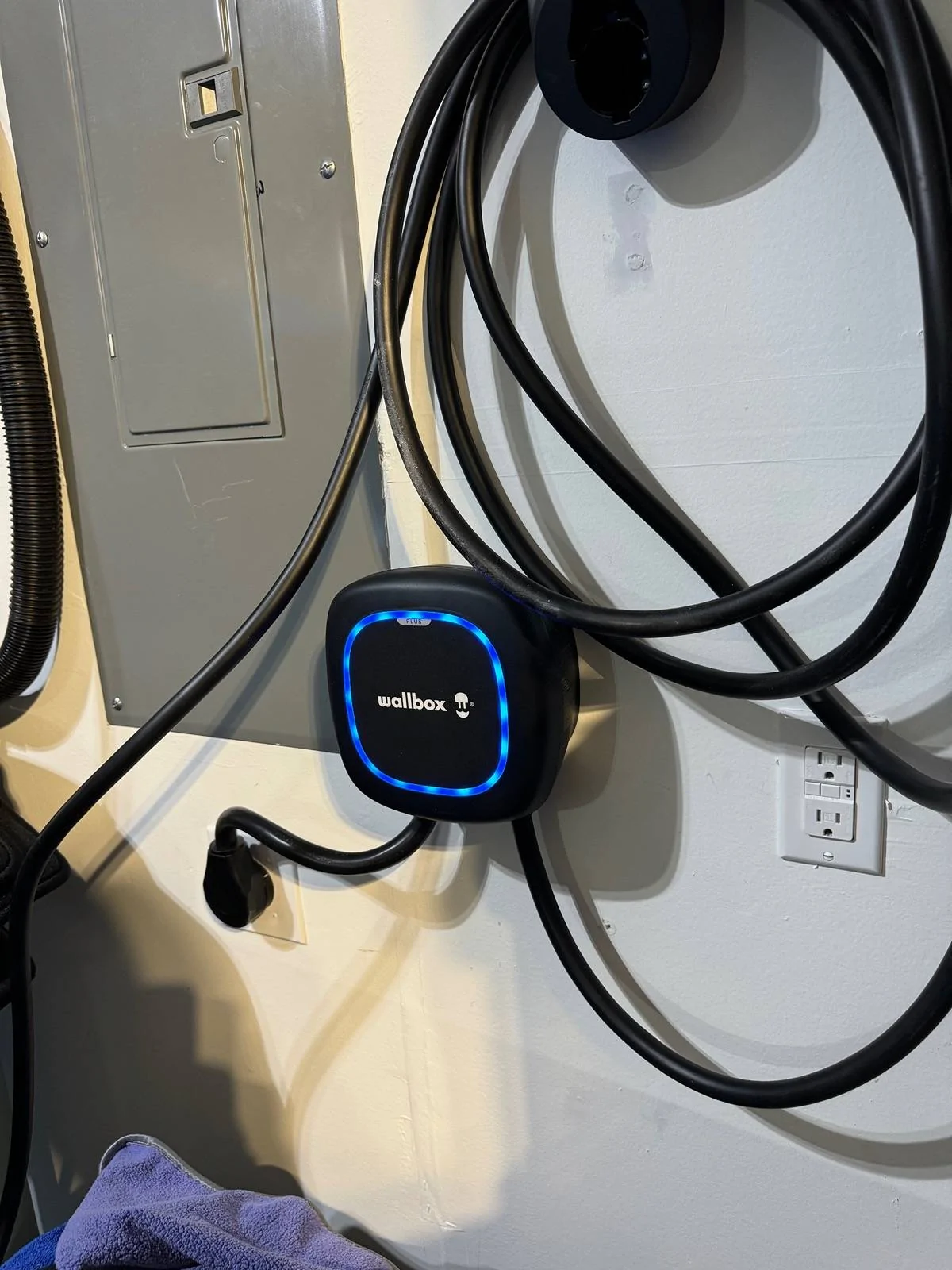

I have the wall box I bought from Best Buy, works great.
Jeep Wrangler JL 4xe Level 2 Charger IMG_1323

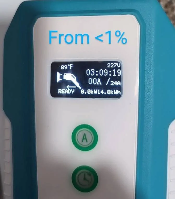

I got this Level 2 from Amazon for $149 and plug in to dryer outlet. 32amp max, I set to 24amp and pulls 22amp and charges in 3 hrs. it also comes with 110v adapter. Its an EG Evgoer. I also bought a Y extension adapter so I don't have to constantly unplug and plug this and dryer.
