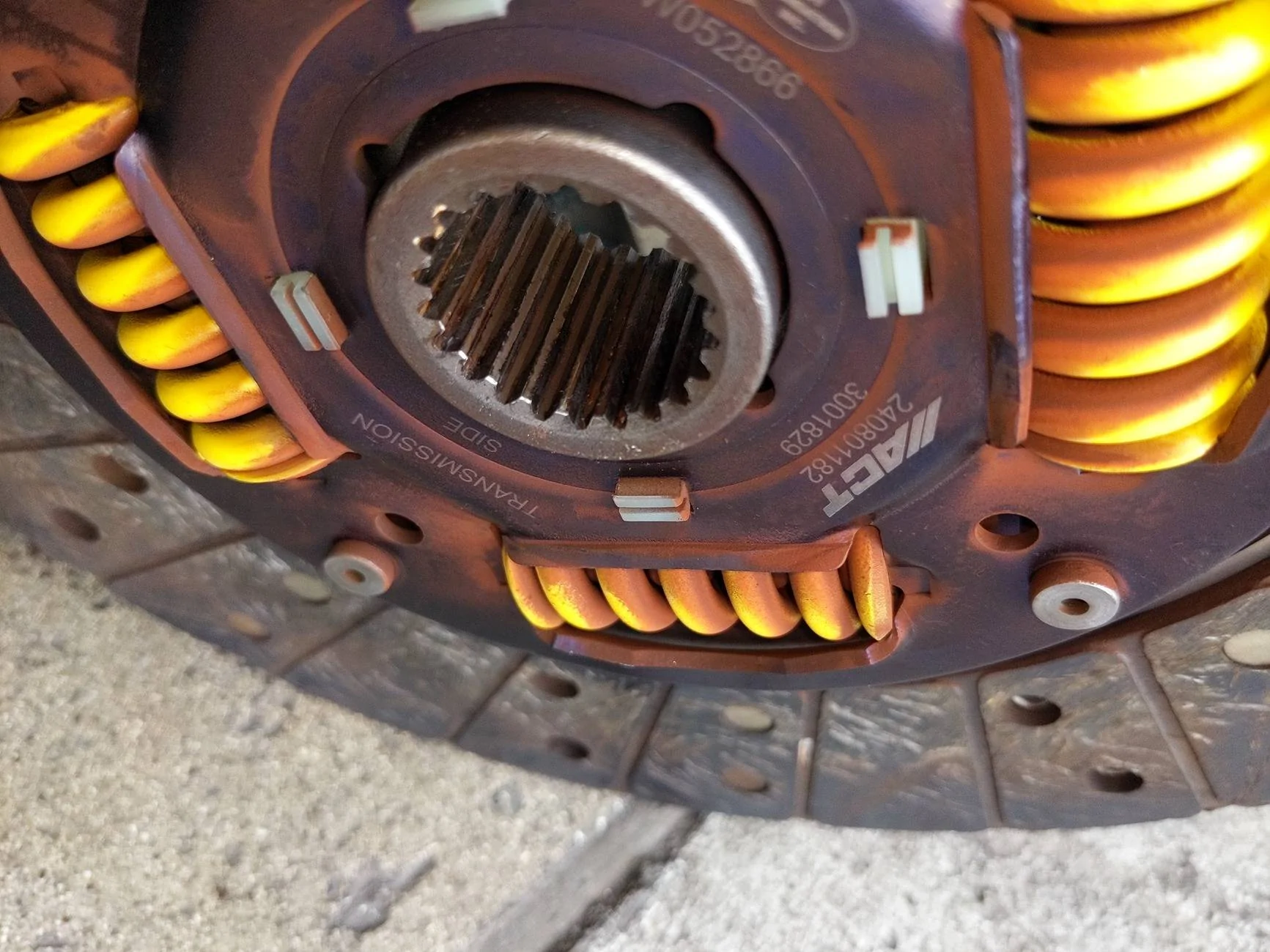

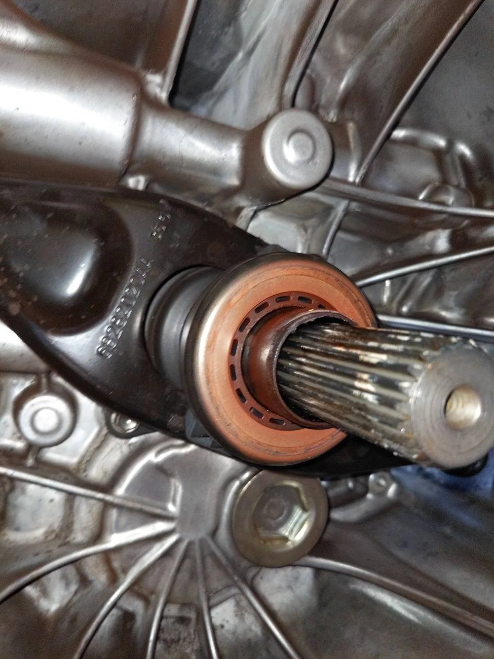

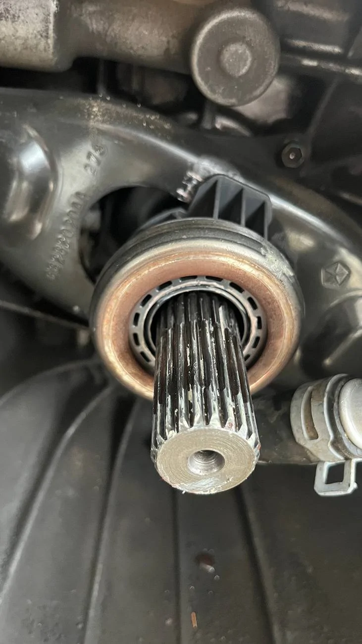

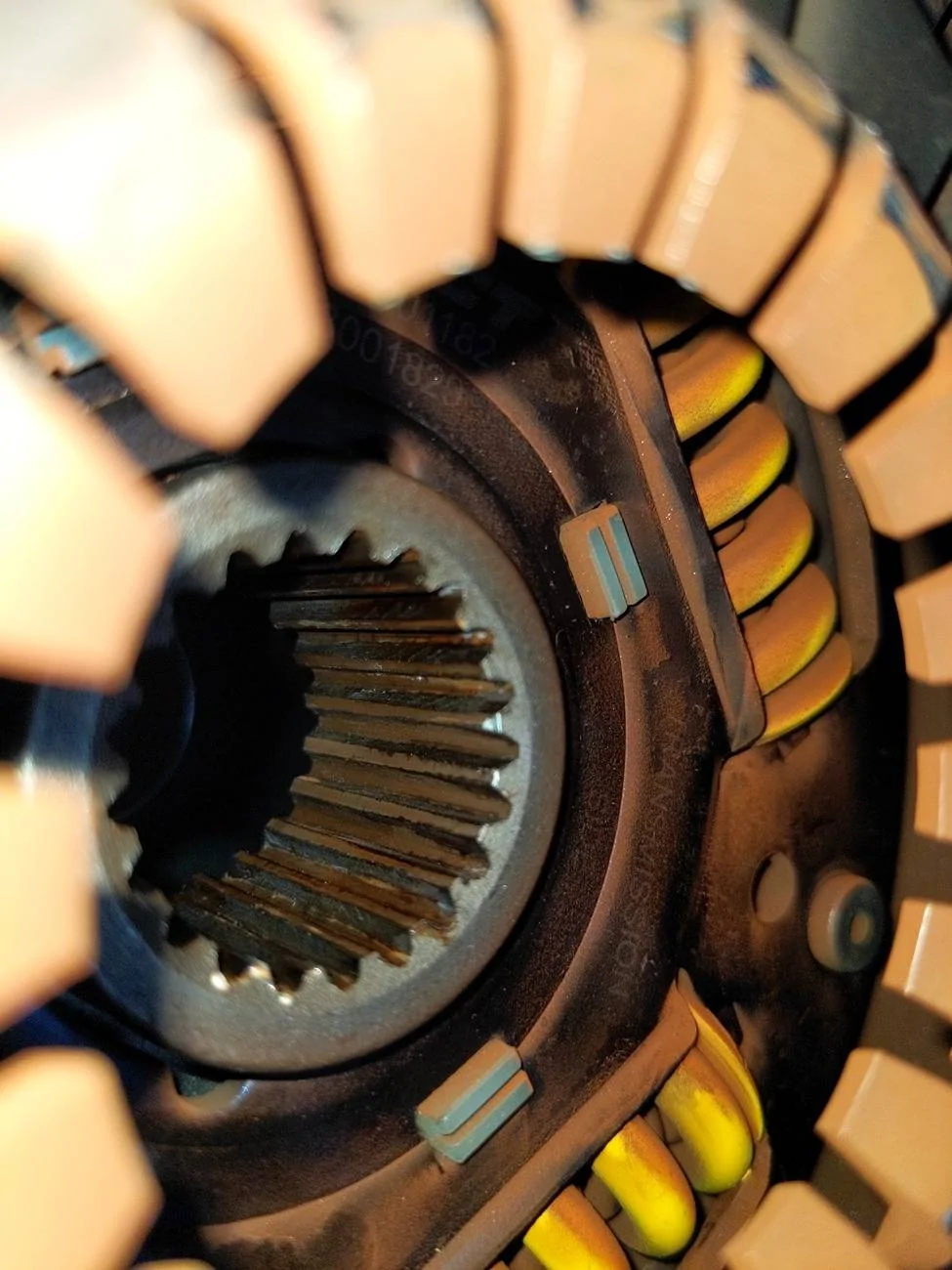

Okay, update on my end:
First, completed everything in 6h and 40ish min, not bad in my opinion.
Second, blew N3 fuse and got stranded in the middle of nowhere till late night. Big thank you to forum members for quick respond and providing guidance.
Overall, as much and what ever grease that was provided with the kit is what has been applied. In my eyes that is bare minimum. Over greasing is not applicable to me.
  • Inspected splines, no abnormalities noted.
  • Imitated travel of the disk and TOB, smooth travel with nothing to note. There was nothing that gave me a reason to stop and investigate further.
  • Proceeded to removed old grease and used dry moly lube instead.
  • Gave it a test fit before reassembly, smooth range of motion and no reason for concern.
Outcome sucks, it sucks bad, shifting is bad now. R, 1st, 2nd, and 3rd are like hitting a wall. Previously at stop i could wiggle into 2nd to get into 1st, now only 4rth engages as it should and from there i can get into other gears. Disengagement became notably sticky, downshifting from all gears has a bit of resistance.
Took it for 2 hour spin, it remained the same though the ride.

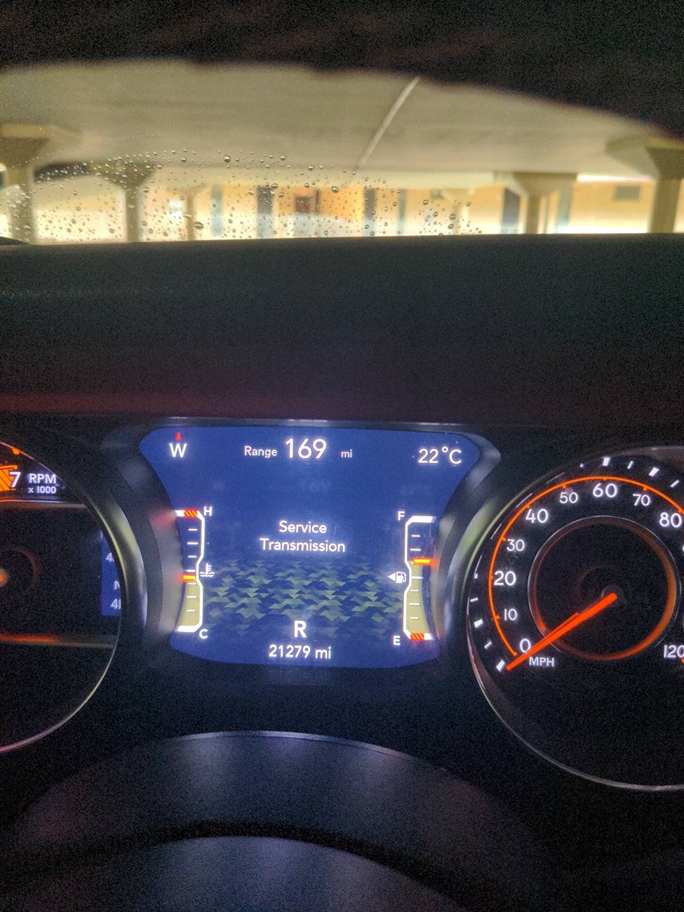

Returned home, during reversing into parkin spot a message on dashboard lit up " Service Transmission".
Jeep Wrangler JL Manual Transmission - Issues shifting into 1st & Reverse (Compilation thread) img1
Fact that a TS threw a message made me happy. Either I did not fully seat one of the connectors, or something is happening there and being picked up by some sensor. At very least i can take this to the clueless dumb fucks at the service department and they cant talk their way out of it.
Now. lets do some thinking here...
1st, i want everyone take a note on the amount of clutch dust. Now look at the photo #4 below, that brown color on the output shaft is a mix of grease and dust. IF use of slightly more viscous grease causes issues (like Red n Tacky), what will grease mixed with friction material cause?
Furthermore, me changing to dry lube has clearly resulted in negative outcome.

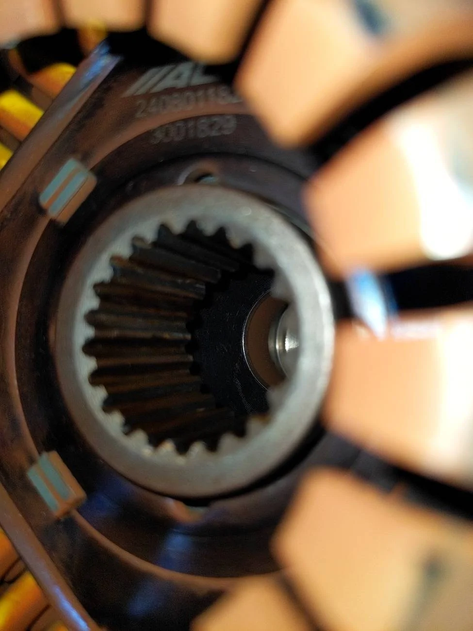

Something i just noticed, this is a zoom in of photo #5, notice distinct lines on the splines, I put green dots next to them. As i stated previously, no abnormalities were noticed during the process, i wiped surfaces of the splines with a napkin, there were no burrs that were catching on to anything. In my opinion, those marks are grease formations, but why are are they forming like this?

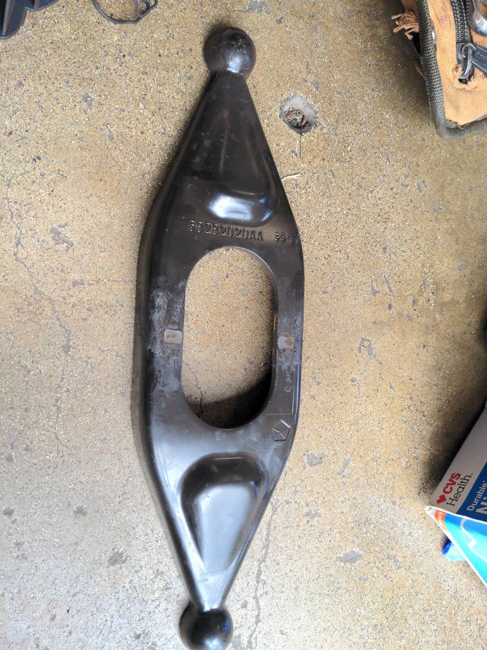

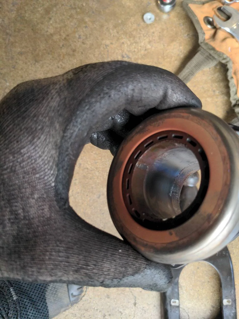

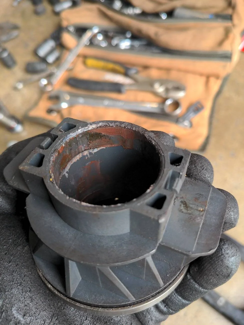

Pictures:
Vids:
output shaft, clutch splines, and overall condition of the clutch
Are you splines rusting at all? In some pictures it looks like rust to me.

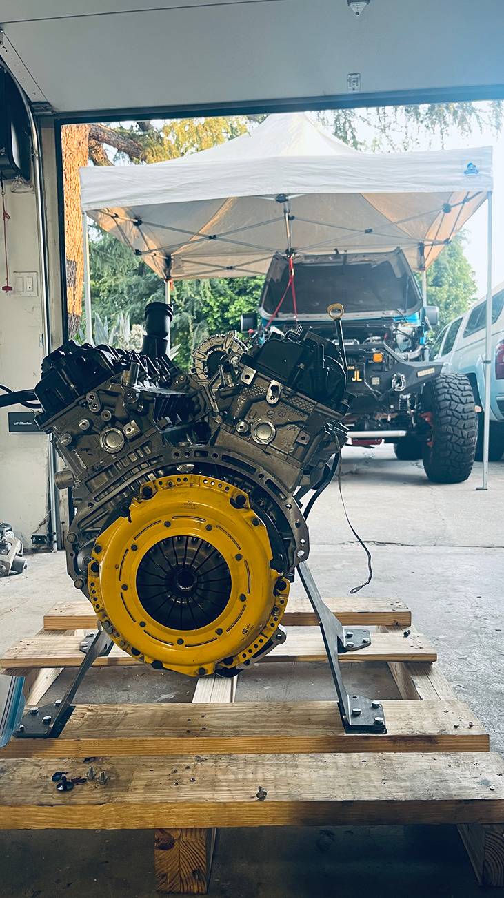

For anyone curious this is what mine looked like after removal and 9k miles on it. At this point I had no major shifting issues going on. I think it'll be a couple more weeks until my Jeep is running and I'll be able to report on how it shifts having re-installed it all.
Jeep Wrangler JL Manual Transmission - Issues shifting into 1st & Reverse (Compilation thread) IMG_5366 2
Jeep Wrangler JL Manual Transmission - Issues shifting into 1st & Reverse (Compilation thread) IMG_5365
All brown that you see is clutch dust, on spline is mix of grease and clutch dust.
IMO it is a very dusty clutch for only 7000 miles of daily town commute to work on it.
I did not take a photo, by my yellow pressure plate was covered in brown. If you take a look at my video #1 (post 664), output shaft is covered with it, as well as riding surface of TOB.
Previously I assumed that friction material mixed with grease was causing too much friction, but if after cleaning and using dry grease the same problems persist, my previous assumption holds no value.
