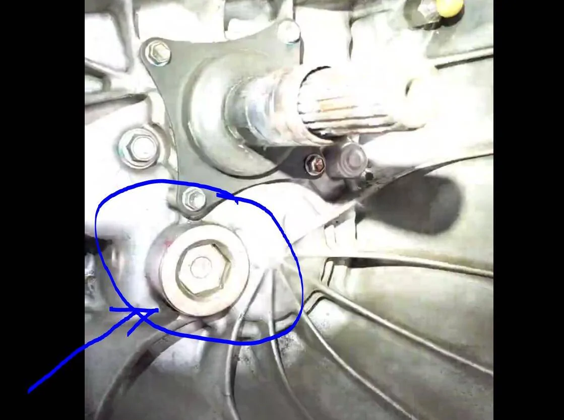

woa woa woa.... what is that tube you have there?
I dont have that tube and hole in bell housing where your hose goes is blocked with a plug.
Oh that's not part of the transmission. My whole engine bay is torn apart right now so that tube ended up hanging down. At the moment I can't remember what it goes to.

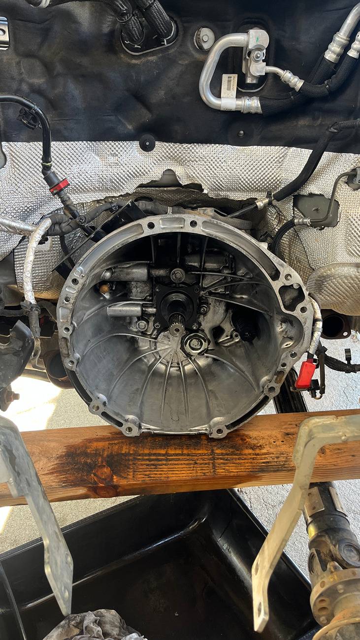

Here's a better picture of the bell housing after I cleaned it up and that tube isn't in the way. Also ignore that 2x6 that at the time was holding up the transmission. 🤣
I thought you were trying out some home made wooden skid plates. :LOL:
