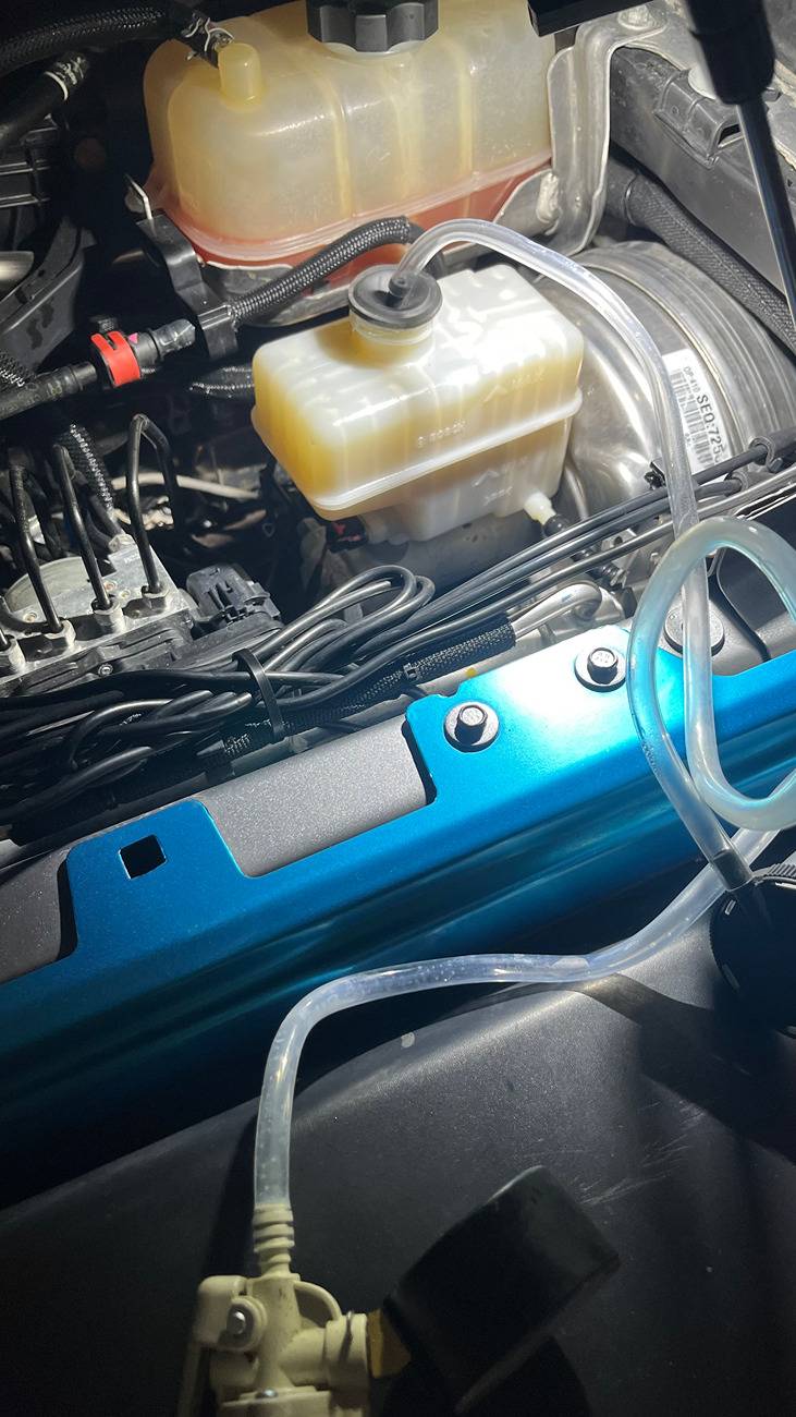

You may be able to take a cap with gasket, thats larger than the brake resi cap, and drill a hole in it to run the mighty vac off of. Its an odd size, and you may crack the cap drilling it, lol.
Maybe a canning jar lid insert would seal, lmao
The only thing I would have less chance of having in my house than a rubber stopper is probably a canning jar. 🤣
Lol, well then any plastic lid with a foam gasket would maybe work. I'd take a peek in the recycling.

Ok I found some stuff to use to create a vacuum. It is holding pressure so that mean no leaks in the system.
I'll try this a few times and try the pedal. If that's no good then I'm gonna guess that the dealer tech damaged the master cylinder seal when he pressurized the system with an air compressor.

So a bit of a weird turn in the Jeep saga. I'm currently awaiting possible mandatory evac orders due to the fires burning in the Los Angeles area. Around 4AM this morning I decided if there was a chance of losing my house I didn't want to also lose the Jeep. I also wanted to be able to load up my belongings. So I just bled the crap out of it. I found a piece of 2x4 and used it to hold down the pedal. I did that for about 2 hours while also taking breaks to load the Jeep up.
I got the pedal back and stopped for now. I keep getting puffs of air coming out of the hose connected to the bleeder. It seems crazy to still have air in there after 2 hours but who knows. As long as I have a pedal I can drive away so I'm leaving it at that.
I plan on trying a dry vacuum again (doing that overnight did nothing) but I don't want to risk anything now in case I have to jump in and just go.

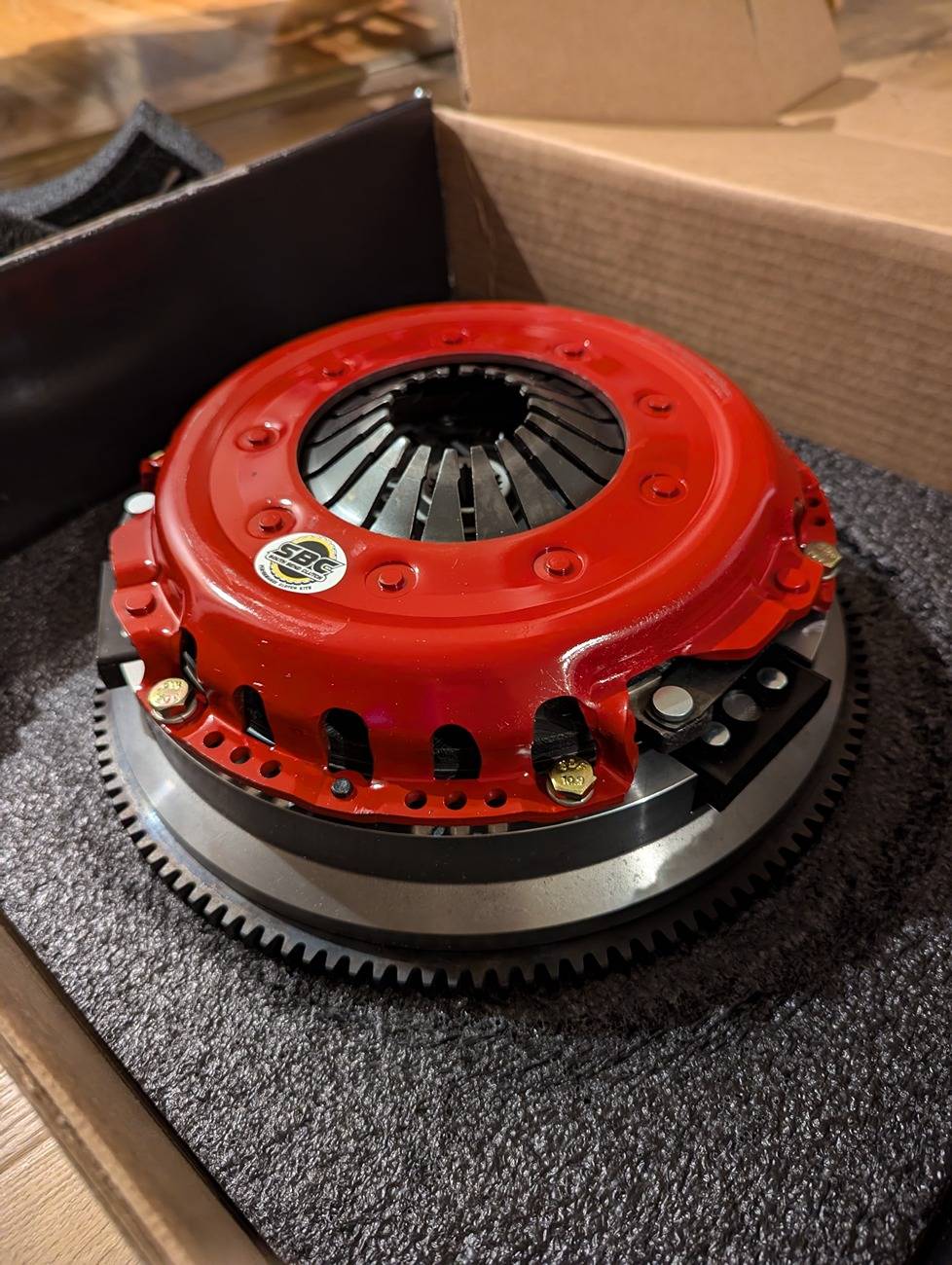

I was watching the videos ACT made and he showed how much play the oem pressure plate and clutch itself had, I wonder if that play helps the discs release.
A twin disc should need twice the room compared to a single. Overall, this situation is pretty dumb.
