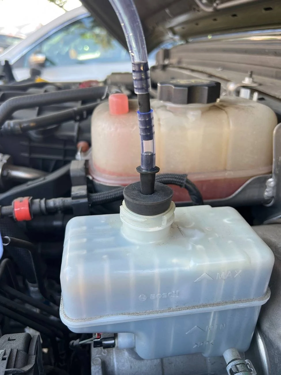

@fspalt @SadRobot @azwjowner I found a video showing a “dry vac”‘method from early 2000’s recognized by Ford and GM, but is common for bleeding concentric (internal) slaves,
video link:
but come to find out now per @SadRobot posting of the centerforce method for their master/slave kit, it’s exactly the same process. I will have a full YouTube “How To” hopefully by the weekend on Gator Overland channel. I tried to upload a short clip of it, but it’s too long. Here’s a link to the Facebook post where I explained what I did.
https://www.facebook.com/share/p/19Za3pL8ir/?mibextid=wwXIfr
Steps:
-make sure your clutch side of fluid in reservoir is full
-find a rubber stopper (make a hole if needed)
-plug in your vac connector
-pull 10-15” of vacuum and let it sit (I left overnite 8hrs)
-Check for improvements and repeat as needed
Trying this vacuum bleeding method today and cannot get the vacuum to hold pressure. Bought some rubber stoppers and drilled a hole to fit the adapters with the mitivac. Steadily looses pressure over time. Have tried a few different adapters, hoses, etc but cannot get the vacuum to hold. Not sure if it is due to a leak in the system from the mitivac or if that means it’s pulling air from the clutch/brake system.
Try to pull vacuum on a single container and see if it holds to test your vac.

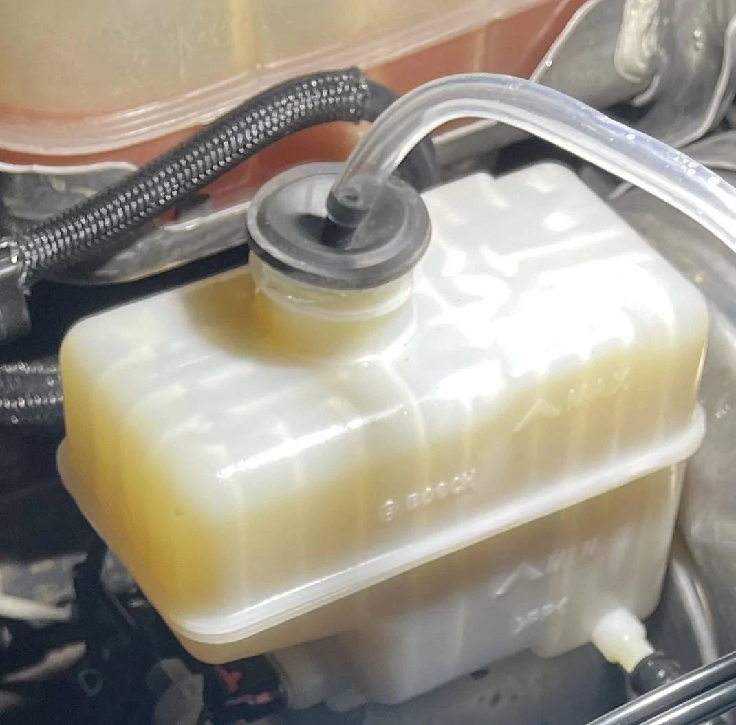

This is what I used. I found a rubber washer sitting around. No idea what it was from originally. I then used the Mityvac adapter to put over that washer. I basically tried to duplicate the tools a CFII kit would come with.
Mine held vacuum all night. It didn't make a difference in the pedal but it did hold.
How long is yours holding for?
thanks for the suggestion. I did test it prior to using it on the jeep and it help pressure. Thinking I have a leak in my set up.
this is my setup. It doesn’t hold for very long. So far this setup is the “best” one I’ve made today. The rubber gasket that came with the kit was way too small to fit the opening of the reservoir.
Well that's frustrating. I guess time to pull the slave and see if leaking in there if you haven't done that already.
