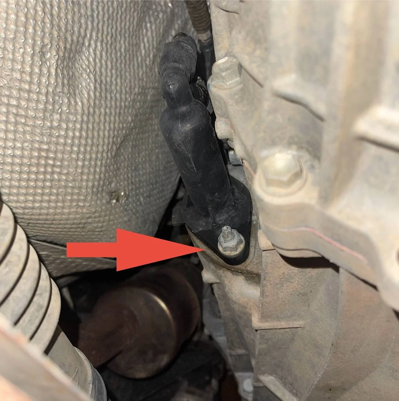

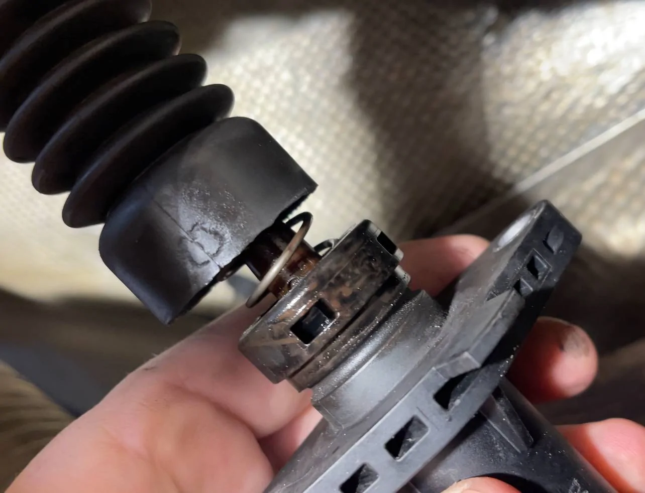

Dec 27, 2024
44
Beaumont, Texas
2020 JTR manual
Yes, ma’am…. When I change the oil, I scan the engine bay for anything shiny or wet-looking…. Dry as can be under the hood as well.
This is what mine look like from the outside of the slave cylinder on the bell housing… to my surprise. It was actually somewhat dry when I removed the slave cylinder, And then I pulled back the boot to reveal the weeping seal..
