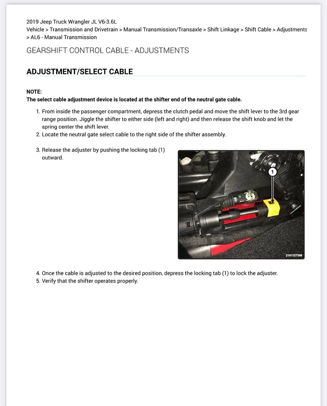

Has anyone tried adjusting their shifter cables? Found these instructions on the forum. I’m getting the occasional challenge of getting mine (JLUR/4.88/35s/Act-HDSS) into 1st and was going to try this soon.
Im having this same issue with the OEM clutch since getting the recall performed.
I took it back and they adjusted the cables but its still the same.
Might work for some but not me
This is what I think I need to try. With mine, when I have difficulty getting it in 1st or reverse I just need to put it in 2nd or 3rd, and then it goes right into first and reverse without issue. It feels like something is loose causing the difficulty with 1st and reverse, but then putting it in another gear aligns everything making it easy to get in any gear.

4 bolts in each lower corner which are behind plastic covers. Then it should lift up (not fully removing) with some gentle persuasion, there are a few push clips holding it down. This gives you enough room to access the adjuster, I usually stuff a small towel or something to prop the front passenger side up (where the adjuster lives).
Fully removing no doubt gives you more room, but that's a more involved process you'd have to search for instructions. I've done the above way a few times and it takes less than 10 min.
@notthenewguy posted about this in one of the threads I believe. If I remember correctly it was not successful. I've read this works in the case of all the gears being off (As in 3rd is where 1st should be).
I could be completely wrong about this but I'd assume if when the Jeep is off you can easily shift through all the correct gears then your cables and bracket alignment are fine. If the shifting is only difficult when the engine is on it would either be hydraulics are leaking OR there is something preventing the pressure plate from fully releasing. Someone here can correct me if that assumption is wrong.
@Gator Overland was able to fix his issues by replacing the slave and bleeding the system. So seems like his issue was leaky hydraulics.
