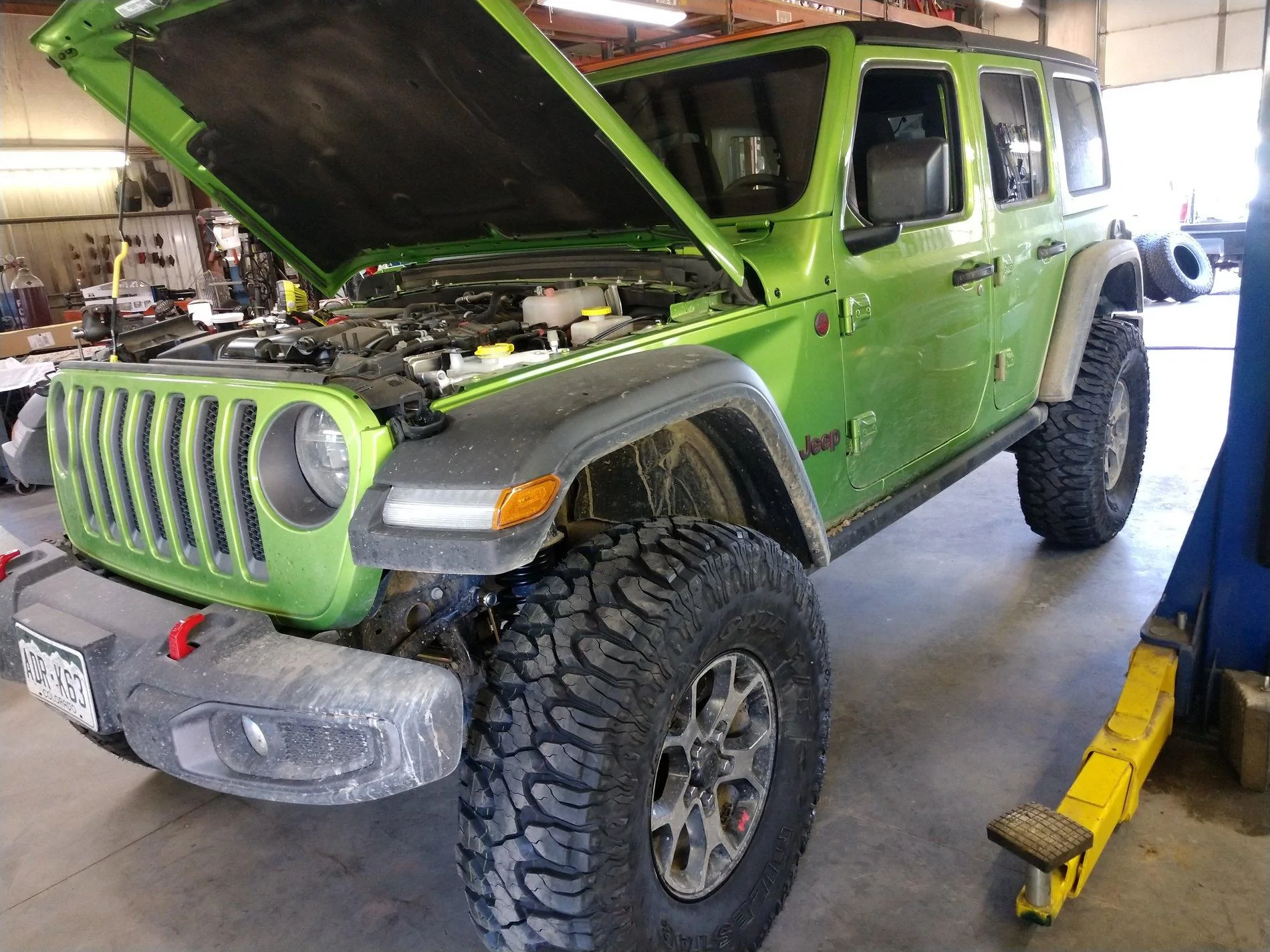

I ran across the scales in Moab recently with a member of the RR4W. He had a late-model JK with f&r aftermarket steel bumpers (he told me both bumpers combined were 600+ pounds (this must have included the winch),full Artec Al skids, steel fenders and even the PSC quarter panel armor, beadlocks plus just about any other aftermarket doodad available for a JK
Basically, his JKUR was 1000 lbs heavier than my JLUR
After deducting weight of passengers, dogs and my ARB cooler my "trail curb" weight is around 4850...this includes basic recovery gear, a decent selection of basic hand tools and an ARB jack...I was at 3/4 tank so I'm calling it 4900# solely for easy math.
My JLUR is the 3.6, mods are basically just MC 2.5" GC lift and 38x13.50 Pats on stock alloys. No winch but honestly I probably should get one, so that'll add some weight. Plastic bumpers f&r. Hardtop with Bestop Sunrider. I did the muffler delete and was glad to see that hunk go, but figure that's offset by little things like the Mopar tg table and CB, etc
Pic of rig, again "trail curb" weight is 4900#, might help give someone a reference point (although really it shouldn't be hard to find a local scale, try co-ops, scrapyards, gravel yards)
