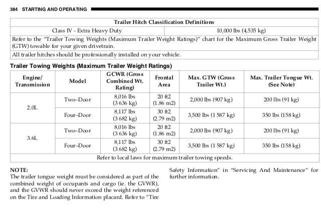

Good day all.
On the 2019 JLUR with the OEM class II hitch does anyone know the standard tongue weight? I have looked at the Jeep site and other sources including here and I see different ranges of 200-800. I am going on basis of 10% of 3500 at 350 lbs. Is that correct ?
Trying to buy an extension since I have an oversized tire and making sure I'm not putting too much weight since the extension decreases the tongue weight.
Thank you

350lbs is the max tongue weight for an unlimited wrangler.
