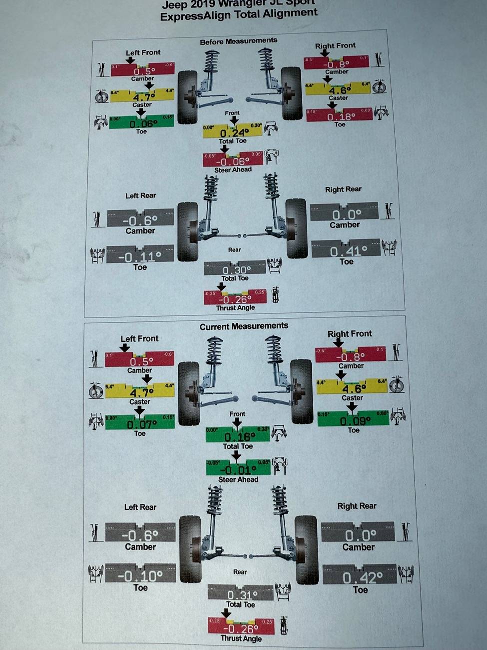

Hello all, bought a 2019 Wrangler with 24k on it a month ago. So far I replaced all 4 tires with Cooper ATPs, all new rotors and pads, new front track bar, and steering stabilizer. Had alignment done after tires, track bar, and stabilizer. No death wobble but jeez does this thing pull extremely hard to the right, faster I go harder the pull. The steering wheel is also offset to the left for me to drive straight. Any idea what this could be? No accidents or frame damage.

Is it stock? I would take it back to the alignment shop. If they redo it and then it still pulls the same, it could be their alignment equipment is off. Also, is the jeep stock?

Every thing stock besides what is mentioned above, the rear end is all stock with Mopar components, no lift.

The thrust angle is off, likely from the front axle not centered with new adjustable track bar… since the rear control arms are stock and you said no accidents….the thrust angle being off will cause a pull…. Also you camber is out of spec, I’d make sure your ball joints are good, if so, you might look into some camber shims….Another thing is if you have a closed end steering stabilizer, they sometimes are pressurized, and can also cause a pull..
