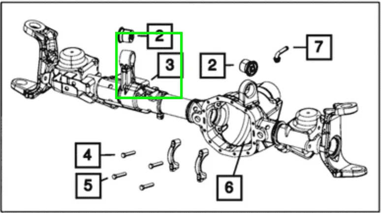

In anticipation of lifting and re-gearing my 2022 JLU sport, I am seeking advice on replacing the front axle seals on the M186 (Advantek Dana 30). The passenger side seal(#3) is p/n 68396635AA and driver side(#6) is p/n 68388747AA. I have seen videos of the old dana 30 with both seals being in the differential housing. The M186 seems different. Based on the parts diagram it appears the passenger (right) seal is located within the axle tube on the differential side of the FAD. Would anyone with experience changing out this seal please provide beta on removing and replacing this seal. I'm curious which direction it comes out (towards the diff.?) and how to tap the new one in. I am sort of guessing it could be tapped in with a pipe, going from the driver side through the diff., before installing the driver side seal. I'm trying to have a complete plan before I proceed with the project. Thanks!

I would not change axle seals on a 2022. I just regeared my 2022 and left them in place. I can verify that the passenger-side seal is indeed in the FAD and not the diff housing, however.

The M210 is a similar layout. The seal is at the FAD towards the knuckle. That keeps the FAD system lubricated.
You can use any pipe that's long enough to extend the handle of the seal driver in place. I had mine extending through the differential out through the driver side knuckle.
I only replaced my seals because I welded a truss on my axle. Welding will potentially destroy the seals. If they aren't leaking and you aren't ruining them like that I'd leave them alone.
