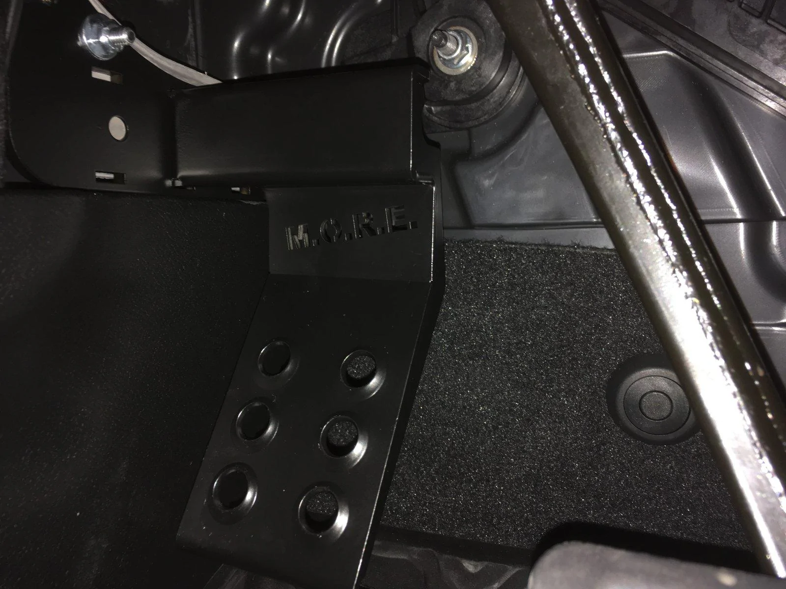

Wanted to share my experience. I actually found it more difficult to screw in the mounting plate to the dead pedal itself. The flat top bolt does not have a proper screw hole...meaning, it's not an allen wrench, torx, Phillips, or flat head. It's almost round, which makes it difficult to tighten the nut.
Once I got it tight enough, the rest was pretty easy, considering I had the right tools. I also used a spool of twine to hold the backing plate in place. I used the middle position, which was perfect for my height of 6FT.
All in all, it took about 30 minutes. Here is a picture of the finished install. Good luck!
