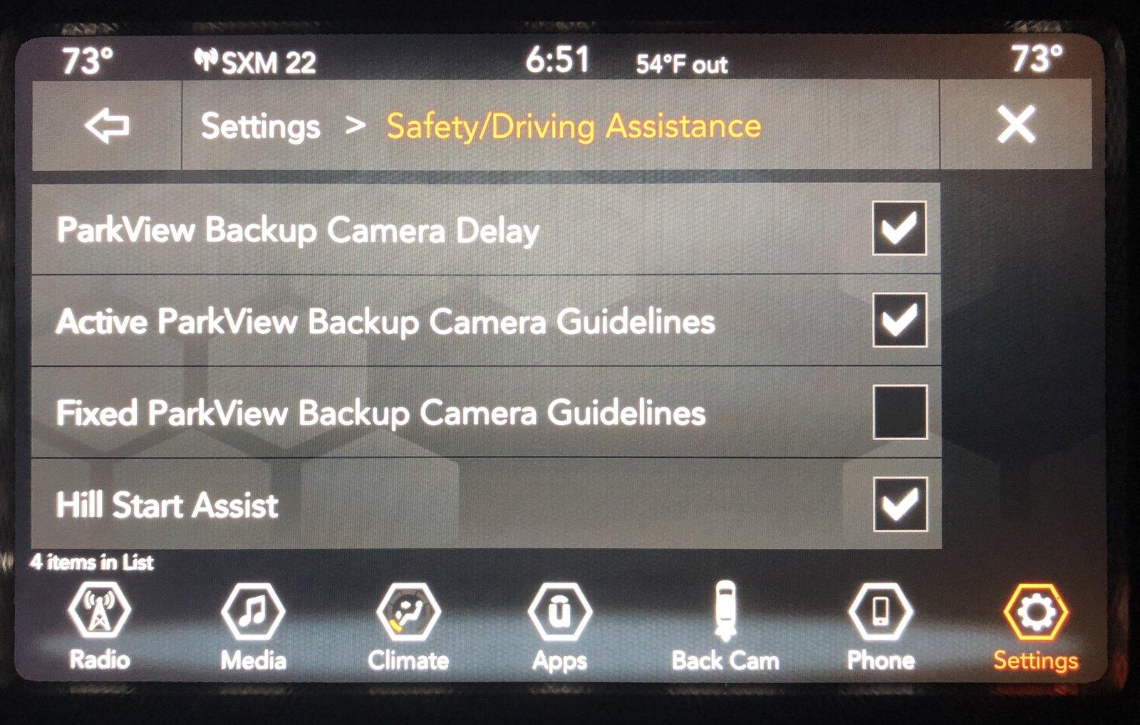

I don't have it on mine. How can I turn the lines on? Is there a setting?

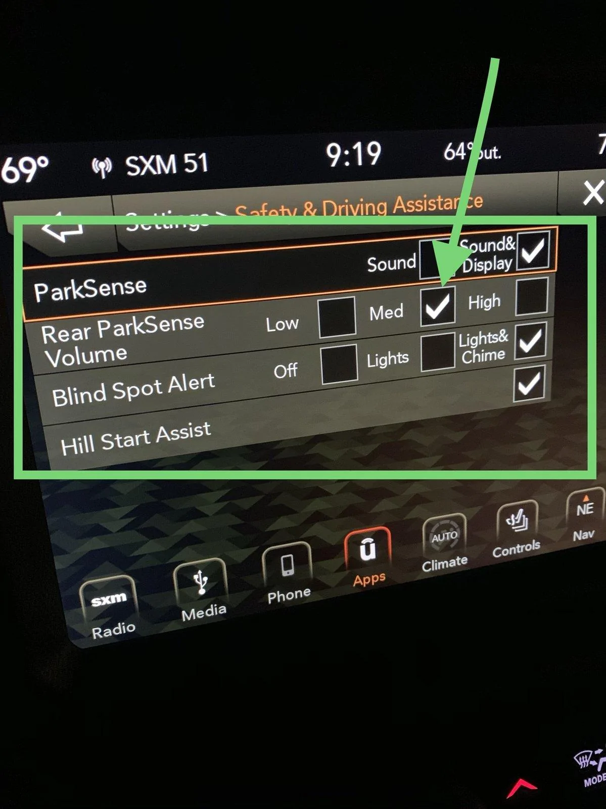

I have a 18' JLU Sahara. When I first picked it up the backup camera guidelines were working perfect. Then I made changes in the settings area on a handful of things. A couple days go by and I go into reverse and also noticed my backup camera guidelines went missing :(. It made me think did I make a change to a setting which could of affected it. I did like 'American Jeeper' wrote above and my guidelines option was ticked off. But still no guidelines in reverse.
After thinking further I remember I changed the volume level of the 'Rear ParkSense Volume' under the settings section 'Safety & Driving Assistance' from the default 'medium' level to 'low'.
Once I went back there I set it back to 'medium' level the backup camera guidelines have been working 100%.
Not sure if this will help everyone but wanted to pass this information along!
