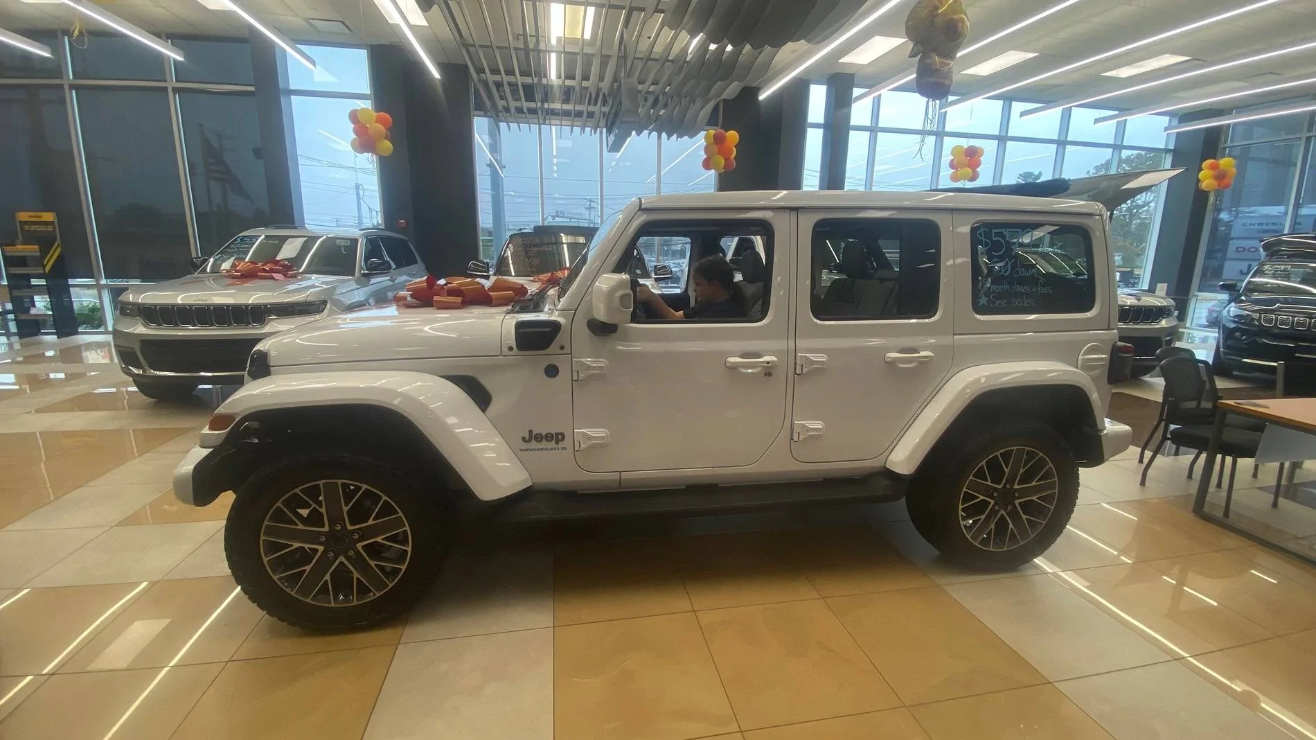

High Altitude- again this is my first Wrangle, it was picked by my 9 year daughter from the show room floor. In her words “ daddy I want this monster truck with big wheels on it”
I’ve always owned Grand Cherokee summits and SRT’s.

Does this make any sense?
I think someone mentioned you can do fit any size wheels on there. Can the wheel size be reduced to 18” from 20” and instead of 55’s tires use 60’s to make up for the dia? What out making modifications? In other words replacing the 275/55r20 with 275 or wider for a poke/60r18?
