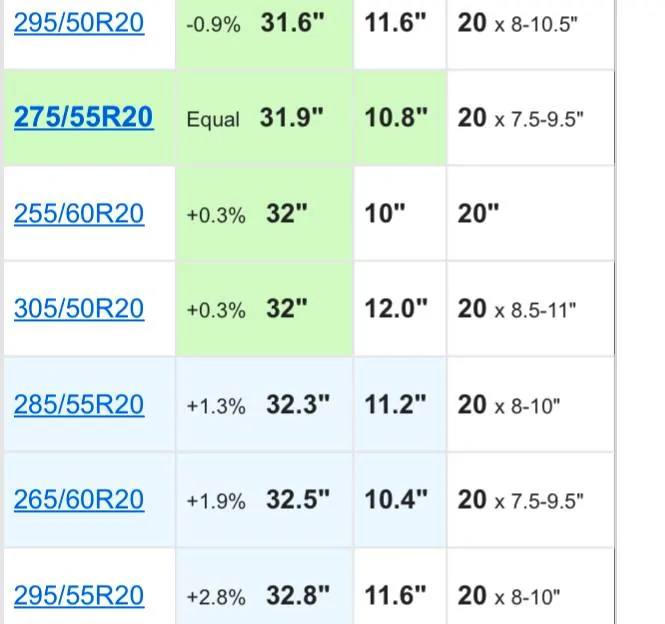

What are you trying to do? Get a little more height? Go off-road? Look ‘cooler’? I’m lost. Go to this and put in your tire size and see alternates and their dimensions.
https://tiresize.com/calculator/
Have the tires stick out just a bit and look more beefy, yeah I guess you can say ‘cooler’ look.

The best way to get more ‘poke’ is to get different wheels with less (more negative) offset. You won’t get much more poke with wider tires because you are limited to your wheel width.
Again, look at that calculator I linked. If you go to the next wider tire than your 275/55-20s… 285/55-20s, you only gain 0.2in… per side, for a 295 you gain 0.4in per side. Chart also shows your percentage height increase.
Understand that the first number is your tire width. The second number is the ratio of your tire height/width. So, 55 is a low profile tire (not much sidewall).
