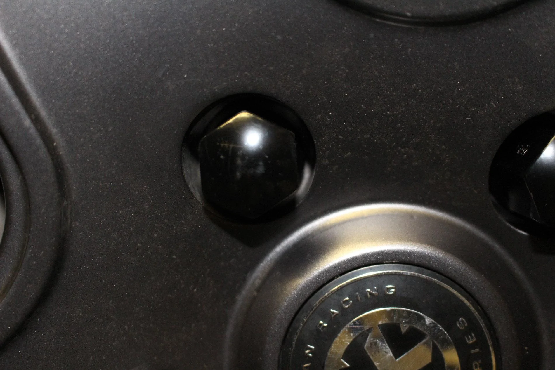

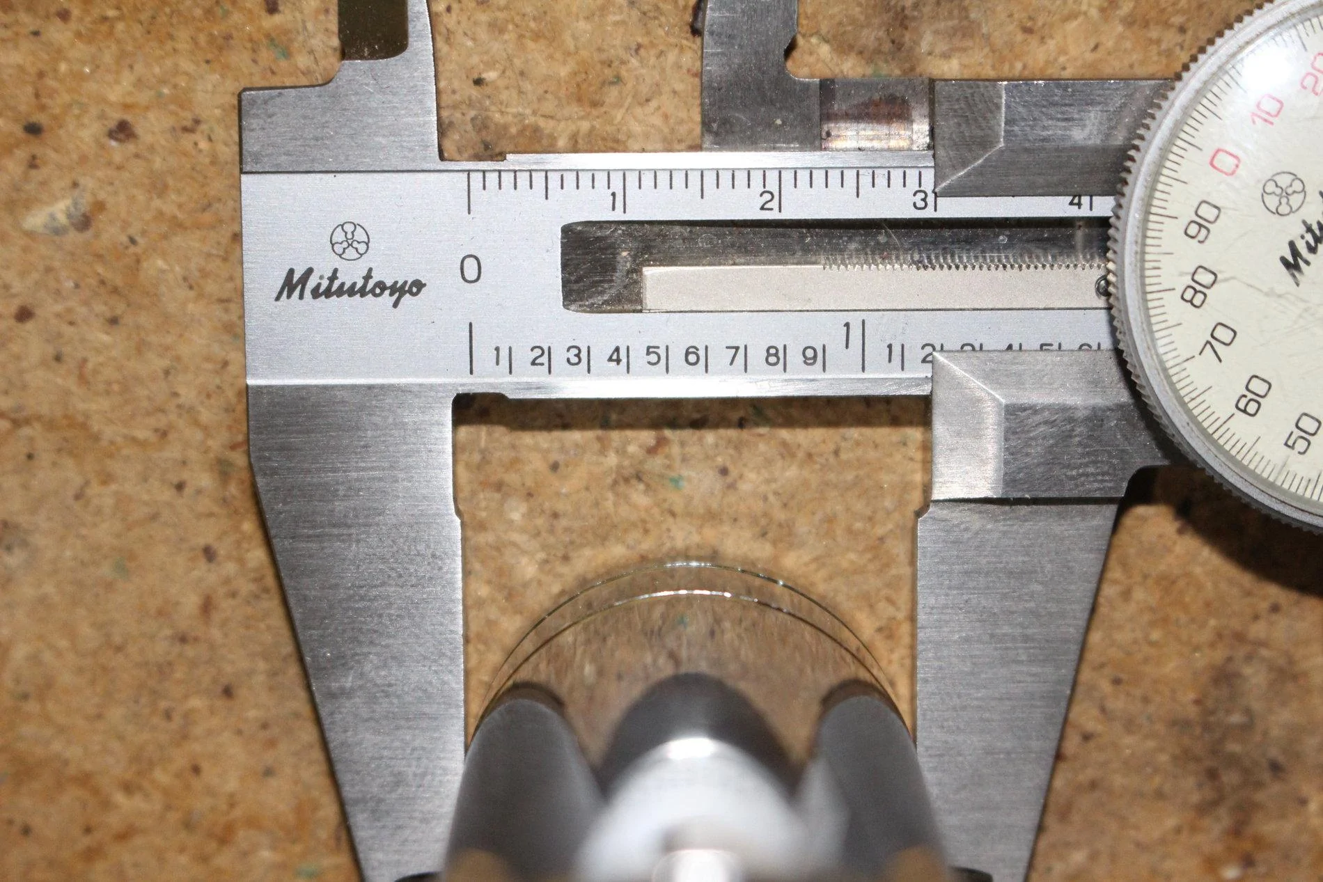

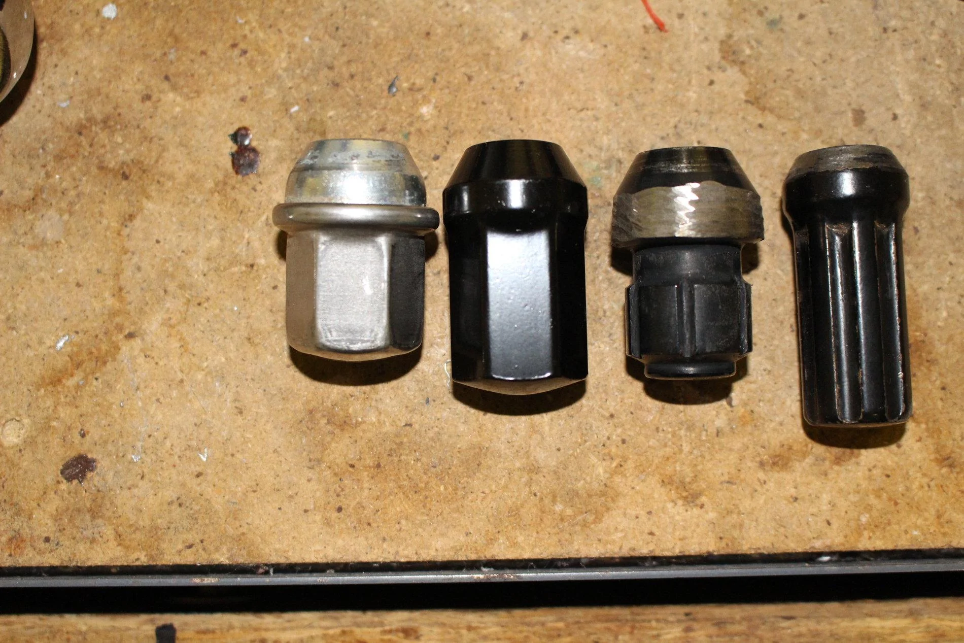

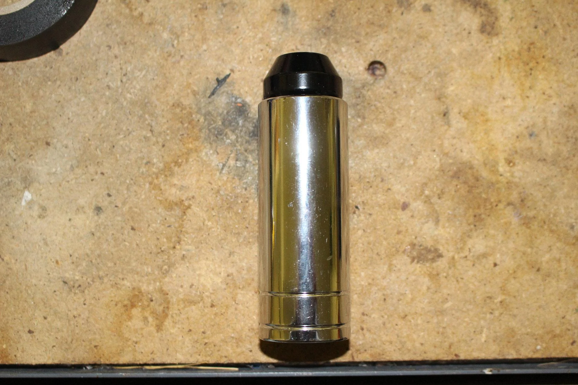

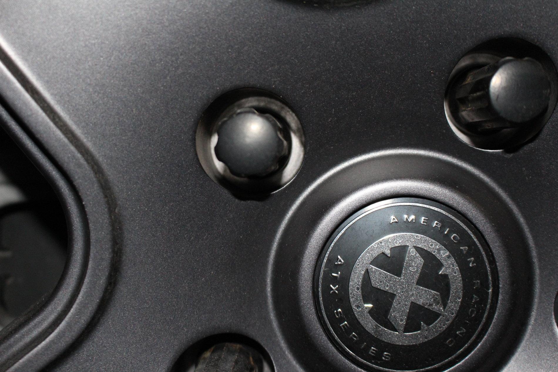

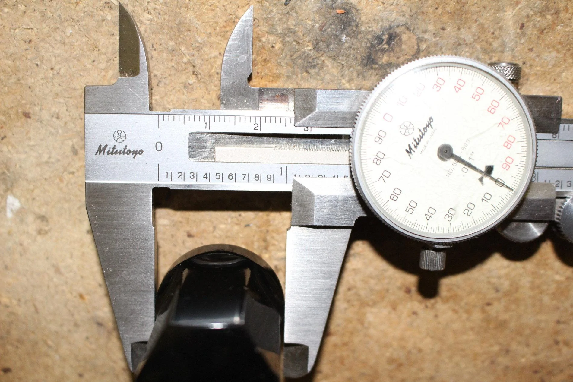

Ok, first off, the OD of the 22mm 6pt socket is right at 30mm, so if your aftermarket wheel lug bores are in the 31mm or larger OD you're good to go! If you can find a 12pt 22mm socket that may allow you a bit more room but YMMV, and 12pts tend to round off lug nuts so buyer beware there,
The actual diameter of the lug nut seat is 26.8mm (so quite a bit larger than the largest McGard splines, and MUCH larger than the standard 22mm OD on the standard spline nuts). Also these would be great for all of you that have factory wheels but want them in a black finish :)

Pics of wimpy 22mm splines~
Pics of new 26.8mm hex lug nuts~
22mm closeup~
And the big boys~
Jeep Wrangler JL Looking for better & safer lug nuts IMG_0331
Not sure about you but I KNOW what I want holding the most important Jeep parts together :)
Again parts are~
Too bad my lug bores are only 28.5mm. I'd have to find a super thin wall 22mm socket to fit that. Doubt there's such an animal and so far I haven't found one. Another option is use a 19mm bulge acorn lug nut. Grey Pneumatic provides the dimensions of all their sockets. A regular 19mm deep socket has a 28mm OD. That would fit my wheels. Or I could go with their extra thin wall 19mm socket that has a 26mm OD.
