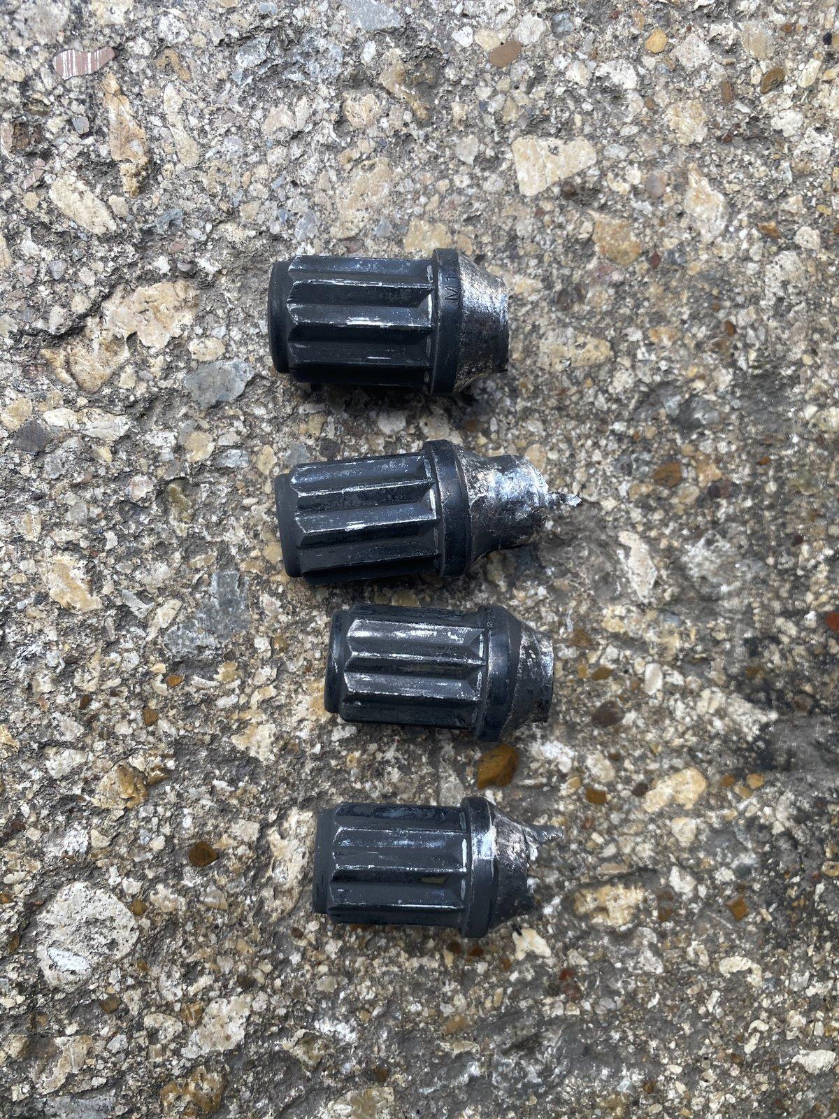

So what’s the verdict folks? This just happened to me.
That's some scary stuff right there. If you have wheels that can run a bigger lug nut I'd definitely look into that.
I’m running Icon Rebounds and the lug nuts were supplied by discount tire when I had the wheels mounted.
Saw your other thread about the improper mounting, if one stud snapped I'm sure the others are in bad shape w/ at a minimum the threads being stretched. I'd have Discount tire replace all the studs, and at least then the spline lug nuts that they supply should suffice if ONLY torqued to 130 ft. lbs.
I'd be on the lookout for other lug nut options though, like the McGard spline nuts since it looks like the Icons have limited room in there.
