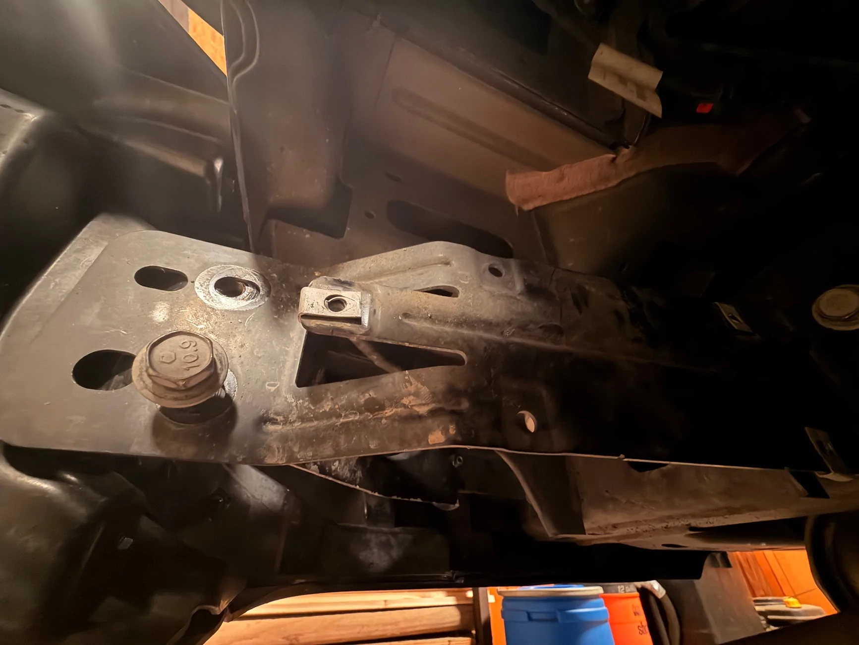

I am going to include a picture of the part and a picture of what it goes too.

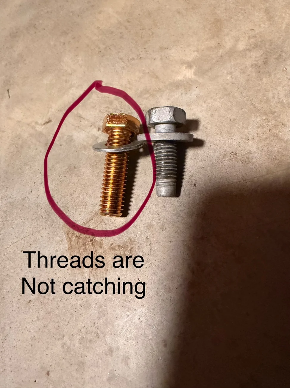

while replacing my rear bumper and putting everything back on, somehow I have lost a bolt.
I went to advanced to get one, but the thread isn’t catching. So I’m just going to replace it with another one of the same.
Where it goes there are suppose to be 2 on one side of the brace and 2 on the other side so a total of 4

Ok your picture is good, so that’s not the issue. I’m having trouble orienting my brain. Does this bolt thread directly into the rear frame horn? (i.e. the end of the frame) If so there is a welded Rifast bung that can get dislodged from the inner wall of the frame. A long shot and hopefully not what happened here, but I managed to do this installing my rear bumper.

It is part number 6104414AA. Mopar charges about $13 for a pack of 4. They do not have them listed individually, as far as I have found. Anyway, I have about 10 of them in the garage. Hit me up if you don't find one, and maybe I can send one out.
If you go with a grade 8 bolt like you have in the picture, it is a 10mm 1.5

@MCDiesel hey thanks man. I also found it around 1650EST. The local jeep dealership here in Clayton/Garner NC had them. They only had (2) individual ones. Priced at $4.90 each. I got them both lol. I’m good to go now

It's just a bolt, if your random picked one doesn't have the same thread, it's not correct.
This is an M8x1.0 iirc.
mcmaster is your friend. Not really need for OEM
