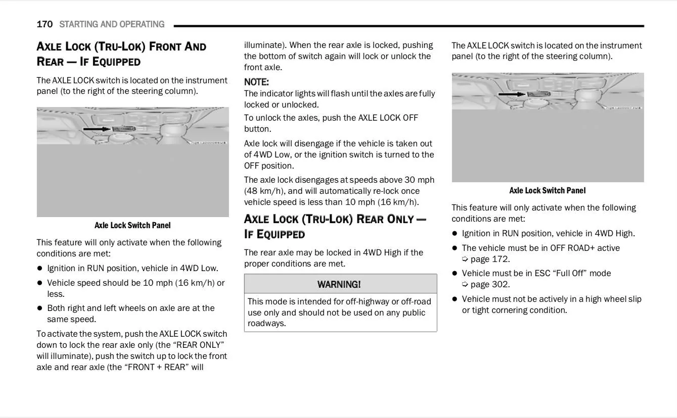

I don’t recall seeing this in the manual but on my 2021 you can lock the rear in 4hi without a programmer.
Edit: found it
Jeep Wrangler JL Locker working speed. D6620F58-FB12-453F-B0C7-25C7273483AB
Edit: found it
I was addressing that both lockers are on on with the programer in 4h. Usually a manufacturer will not allow the front locker on at higher speeds because of the impact on steering.

@wibornz - Yep understood. I just put that up because the ability to lock the rear in 4hi was news to me until I stumbled across that video. Still don't know if it disengages at some point on its own.

Put the transfer case in 4hi, turn offroad plus on, press and hold traction control button until ESC off shows up on dash, then you can lock the rear only but still be in 4hi. Perfect for mud/sand like conditions. Works everytime, but I have not tried this in a 2018-2020 rubicon that doesn't have offroad plus.
I tried on our 2020 and couldn't get it to work. So it seems that offroad+ button is required
