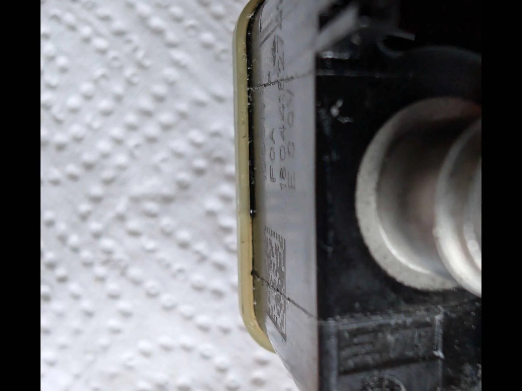

When speaking about oil intrusion for the old sensor - was very surprised to see that the potting compound was seeping out from the contact seam of the translucent top where it meets with the main black housing.
So over time - the friction or adhesive bonds of the locker sensor components let go. This with just small pressure from the potting injector from filling. So one can imagine under high heat and high pressure - how the sensor can fill up with oil from that access joint alone.
Obviously Jeep recognized this as a significant flaw enough to redesign this component. But with new ones already failing - does not bode well.
Jeep should recognize that if the "new locker sensor" is also failing - they should not just sell replacements that will fail just as easily. But instead make sure these will do the job properly for the end user.
