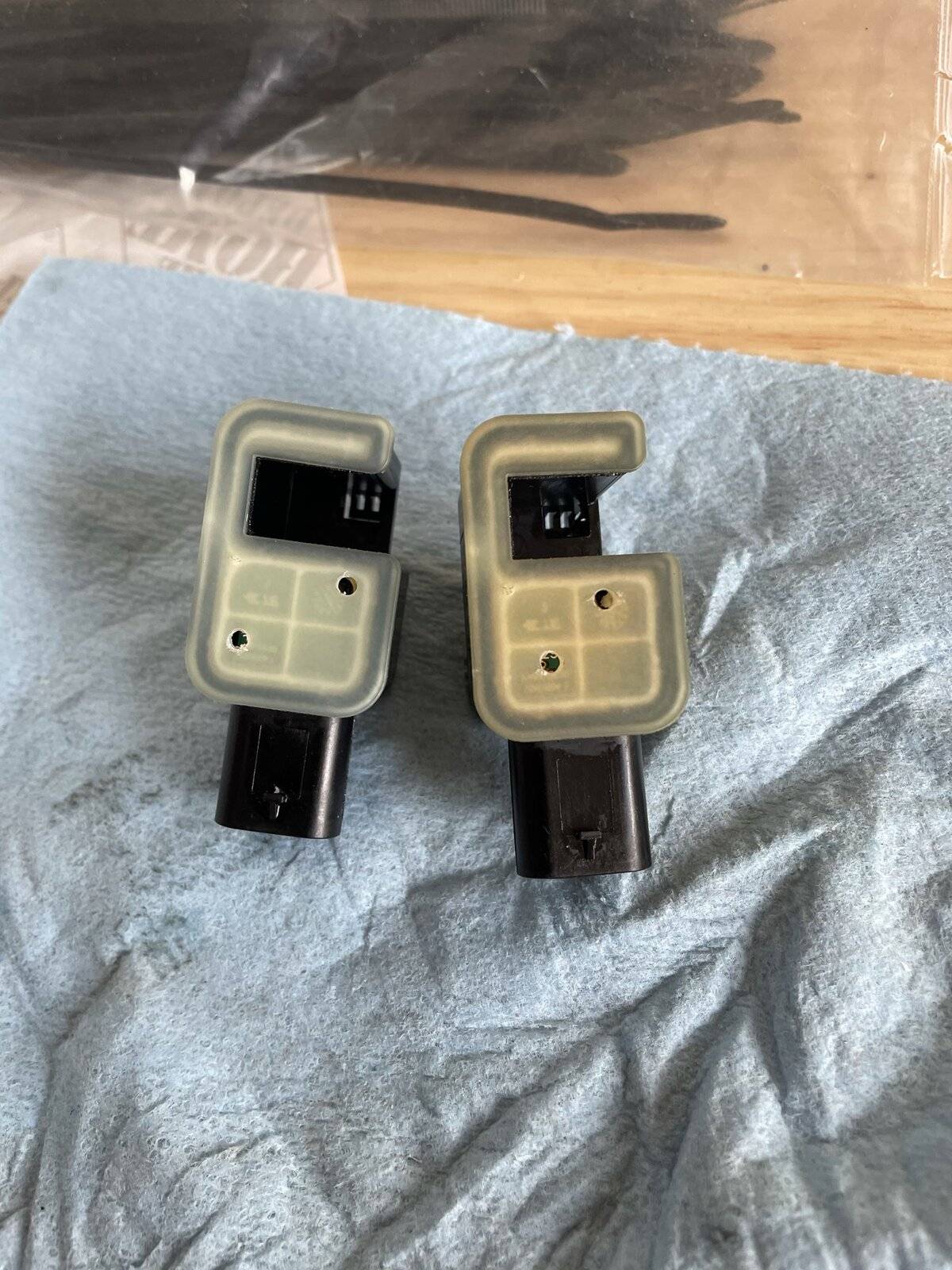

Why is one a slightly different color than the other?
It’s the one from the rear and sits in the fluid a lot more than the front. Since it has the FAD, the front diff doesn’t move much, except when in 4wd. So the fronts tend to look fairly new.

Just finished potting my sensors. I agree with others, it seems to engage almost instantly. Before it would blink a bit and then engage.
